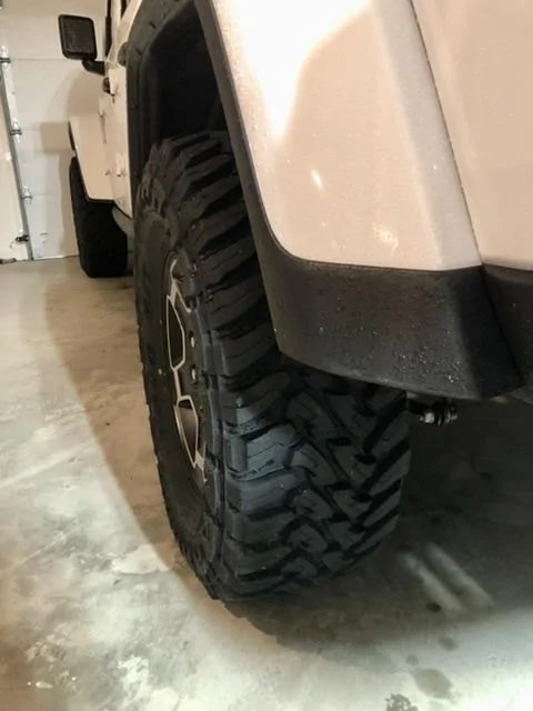

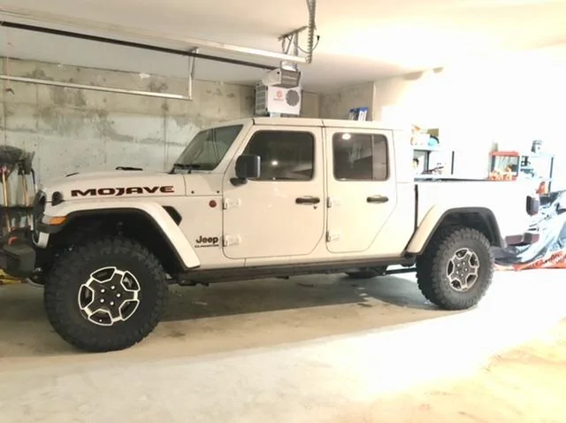

315/70/R17 here. Basically a 35x12.50, a hare shorter. Toyo M/T’s, Factory wheels. No rubbing and no hesitation by the tire retailer.
Literally thousands of jeeps our there with 35’s on stock wheels. If there was a bead break pandemic I believe the jeep community would know.
Probably wont get quite the tire wear that you would on a wider rim but it drives out fine.

that looks great. I will look into the 35s.
