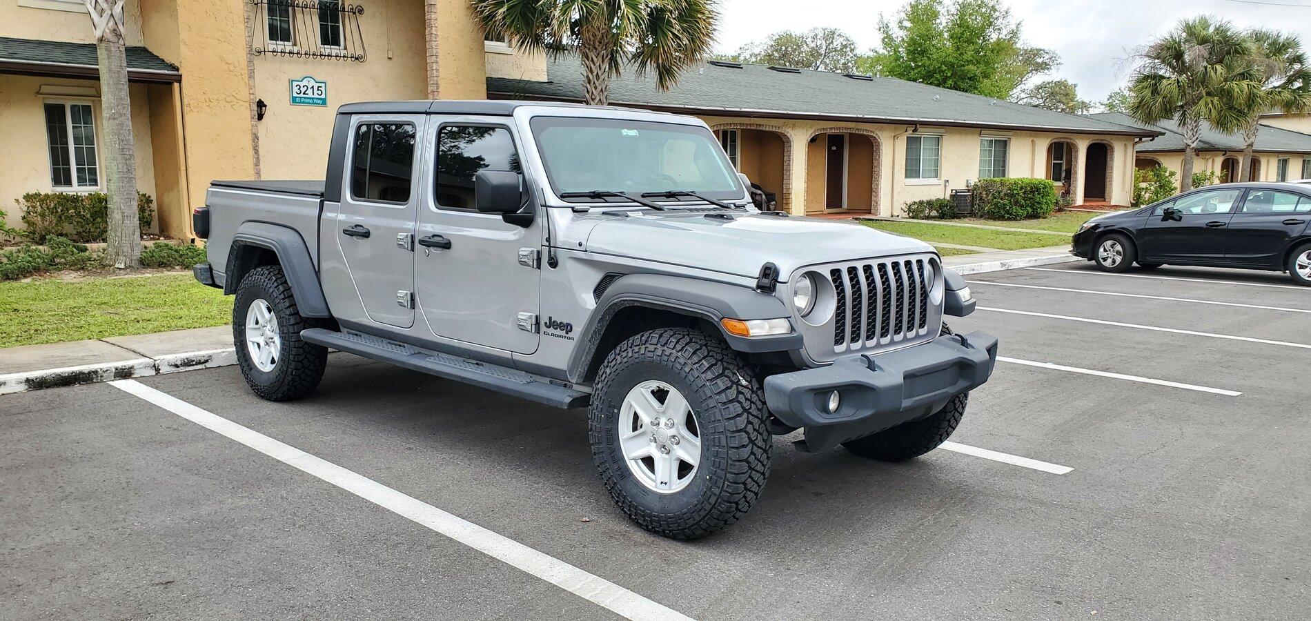

I am considering doing this right out of the box on the stock rims. I know they’re about 10lbs heavier each than the stock tires, any loss in power or mpg? Any pics of your setup?

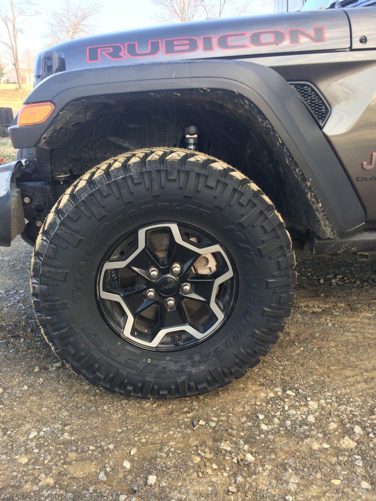

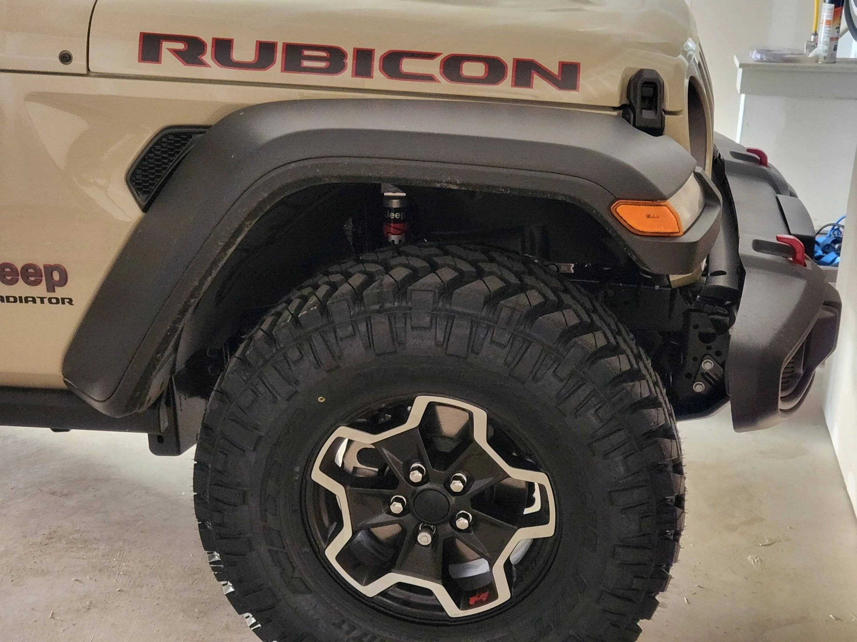

2022 Gladiator Rubicon. Just put Nitto Recon Grapplers 35/12.50/17 using stock wheels. Plenty of clearance. I don’t notice any difference in overall drive ability. About 4 lbs heavier than stock Wildpeaks. Based on RPMs and associated MPH, I expect mpg to be about the same

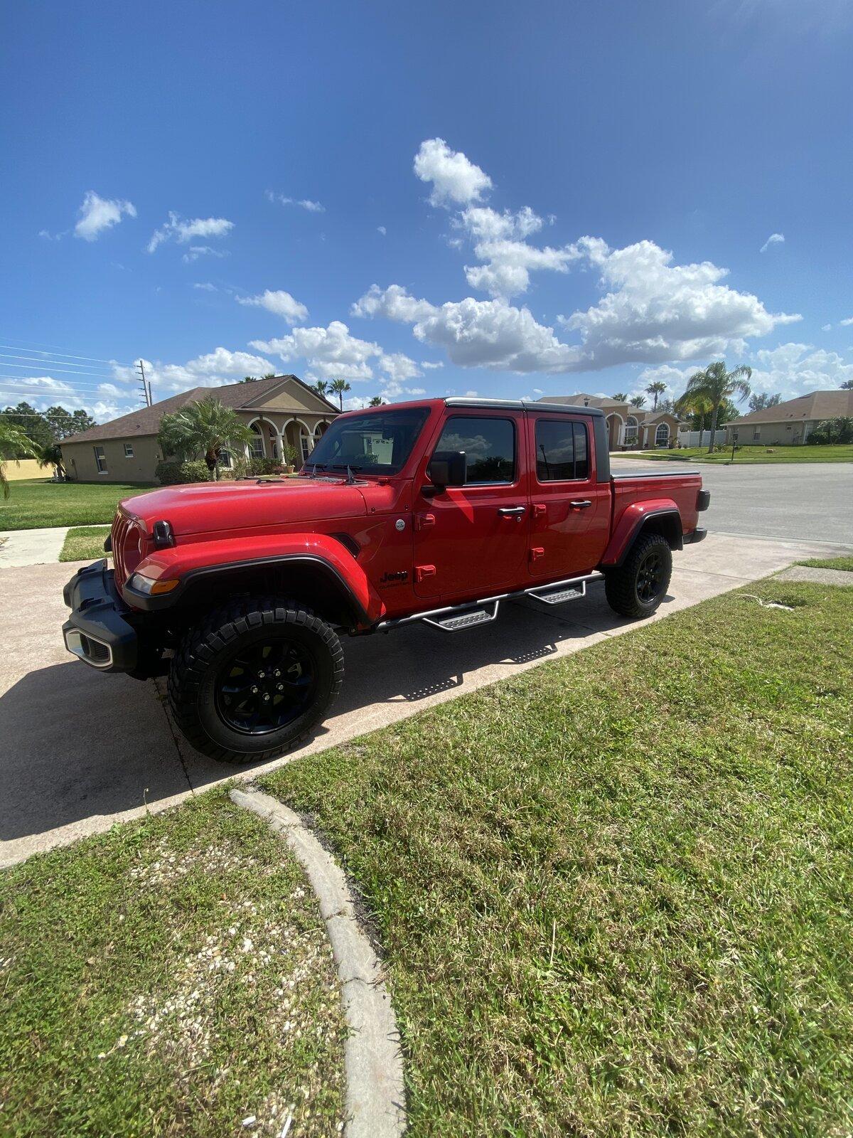

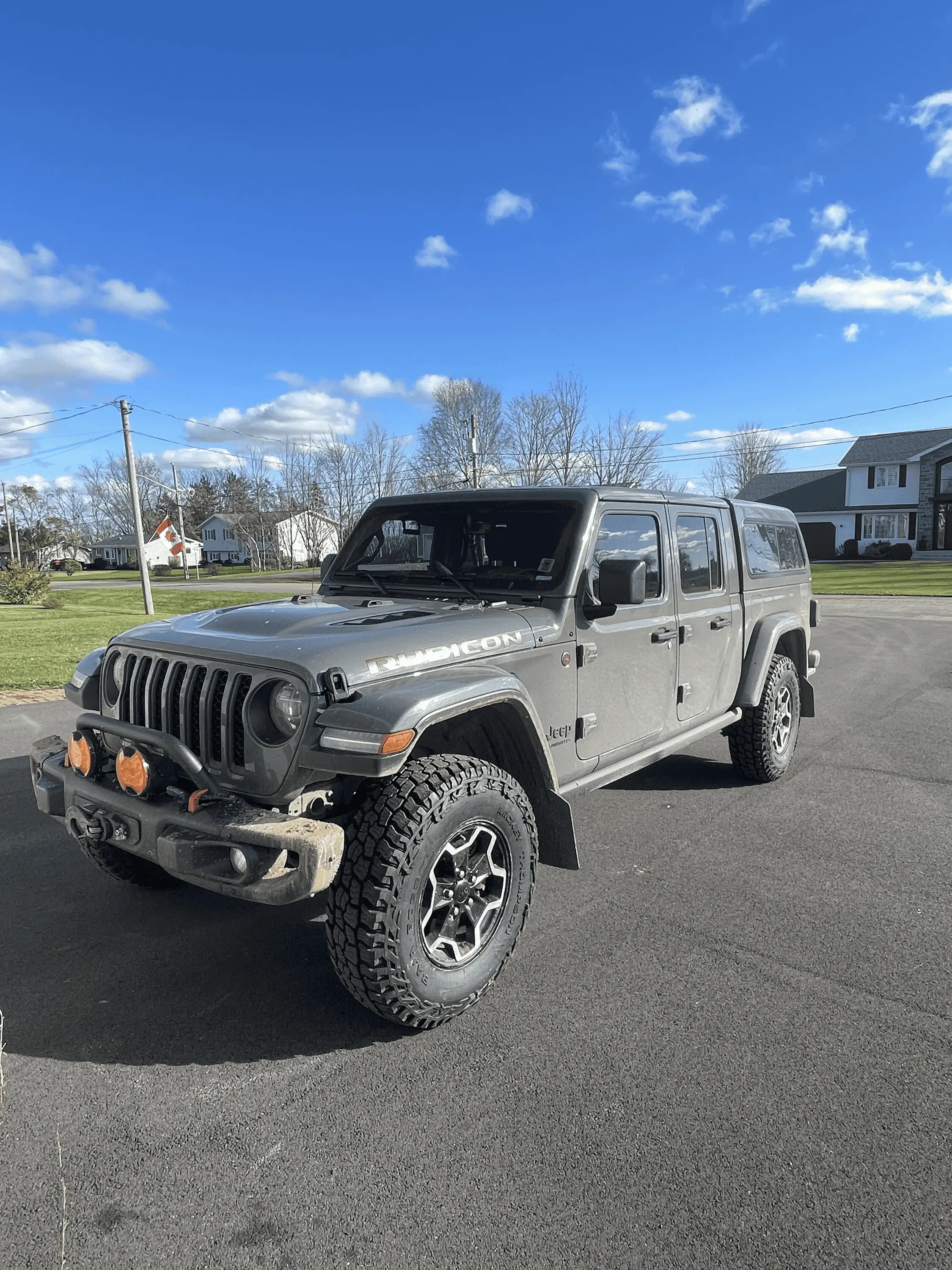

2020 Rubicon with General Grabbers 35/12.5/R17, no issues. Can't speak to the MPG since I put the steel bumper and winch on about the same time.
Jeep Gladiator Anyone running 35s on stock wheels without issues? IMG_0638

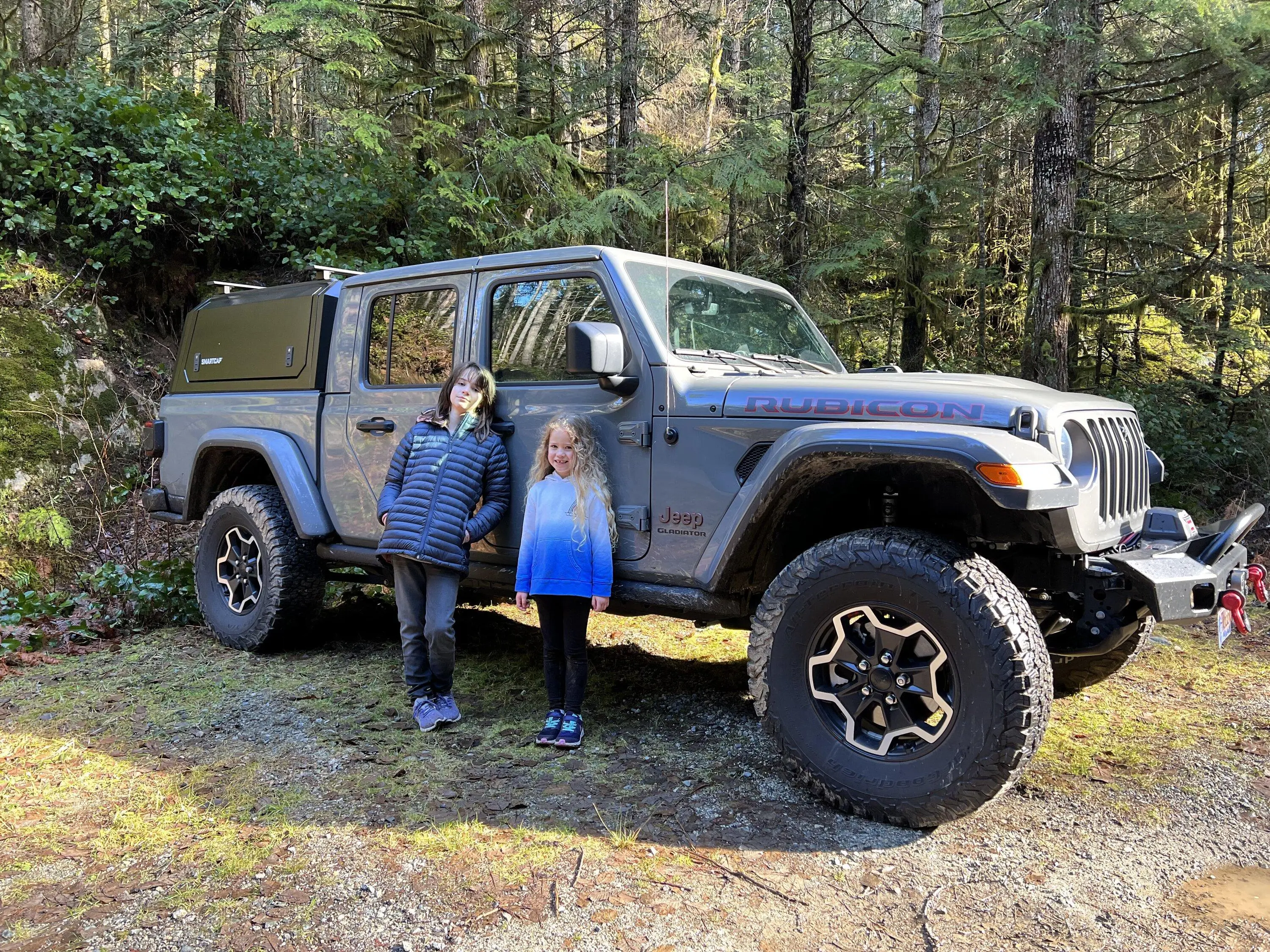

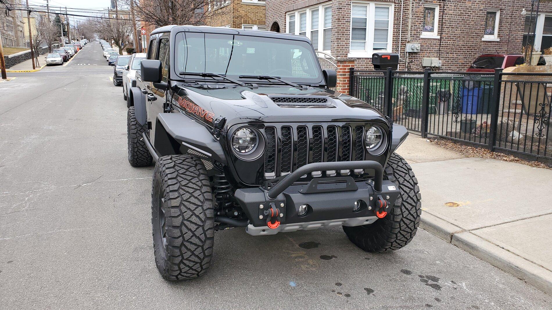

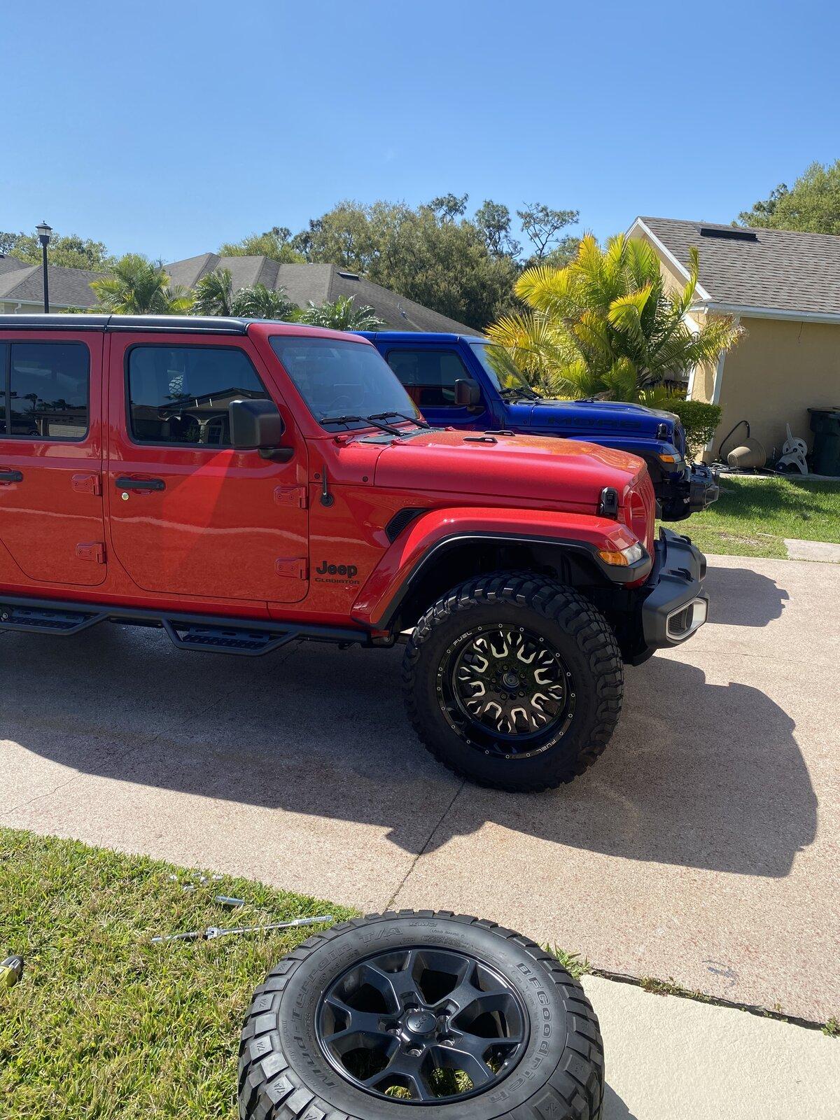

I run 37" Ridge Grapplers in the summer on KMC wheels and in the winter I use 35" KO2's on the stock 7.5" wheels. I air down all the time on both sets of tires and have never had an issue. I've also had no abnormal wear on the KO2's which I was concerned about since they are spec'd for a 7.5" wheel. I run 35 psi on the highway with the KO2's. My JT just has the 2" Mopar lift.
Jeep Gladiator Anyone running 35s on stock wheels without issues? IMG_0732

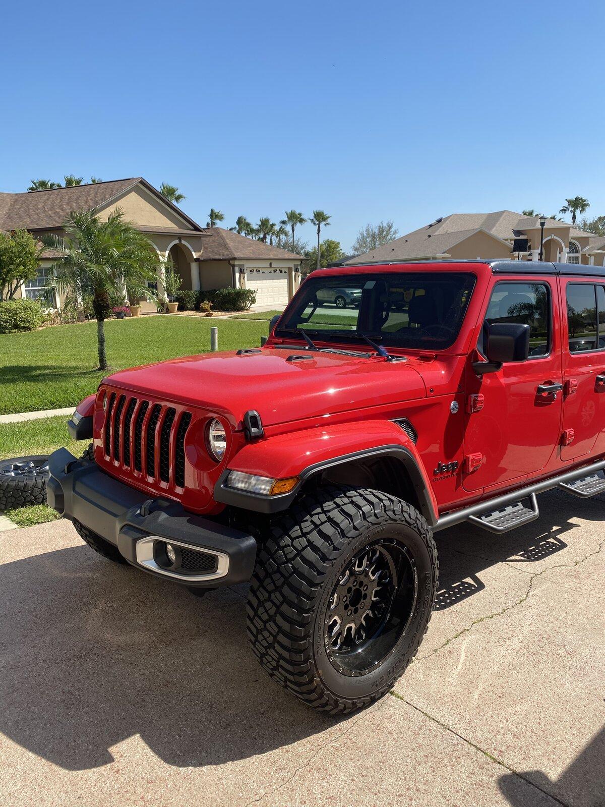

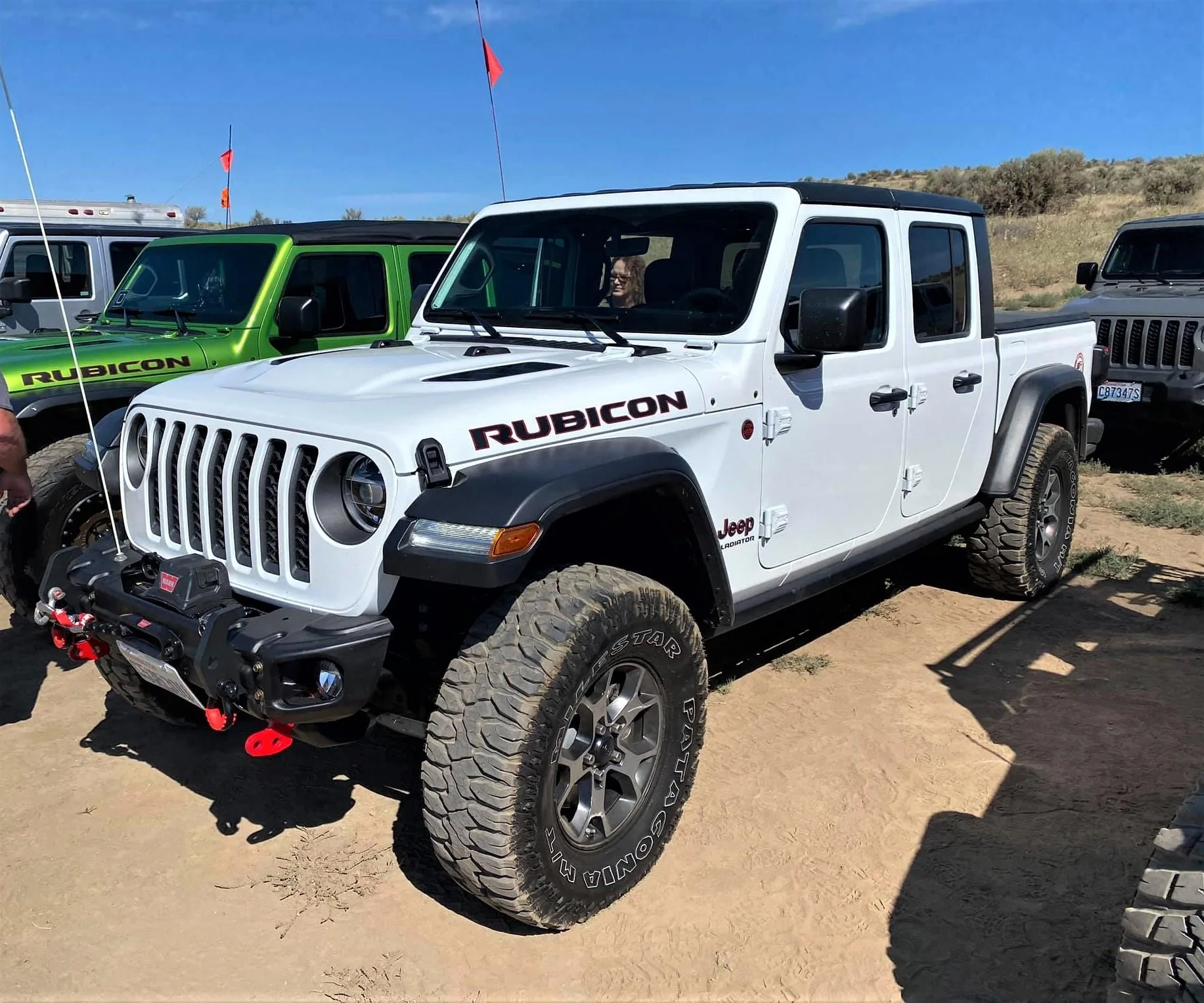

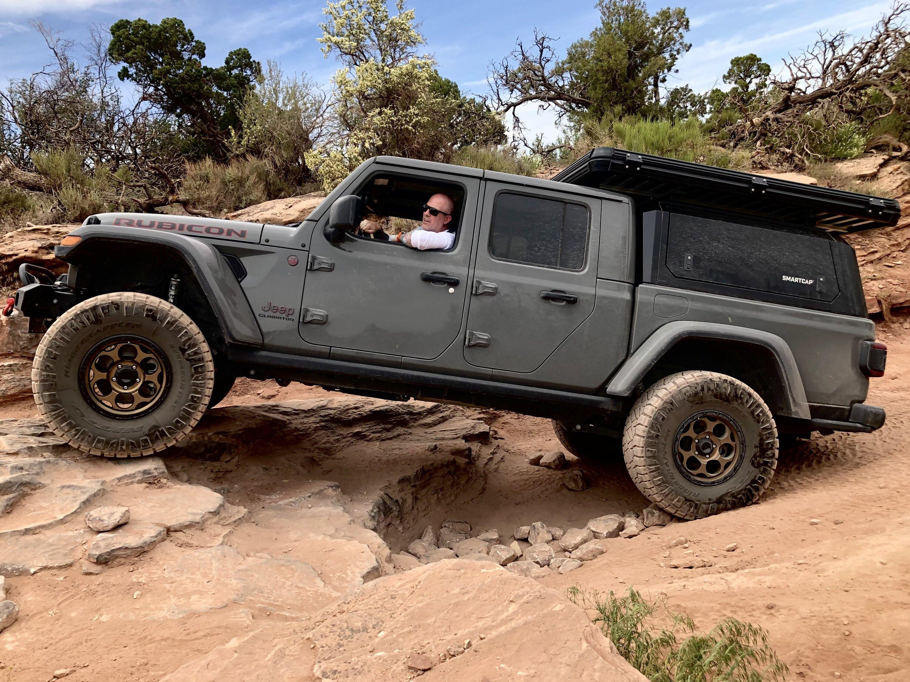

Stock 2022 Rubicon with Nitto 35X12.50 on stock wheels, no issues or rubbing. Have not had it flexed yet but will update once I get it off-road and flex it out.
Jeep Gladiator Anyone running 35s on stock wheels without issues? 20230117_170147

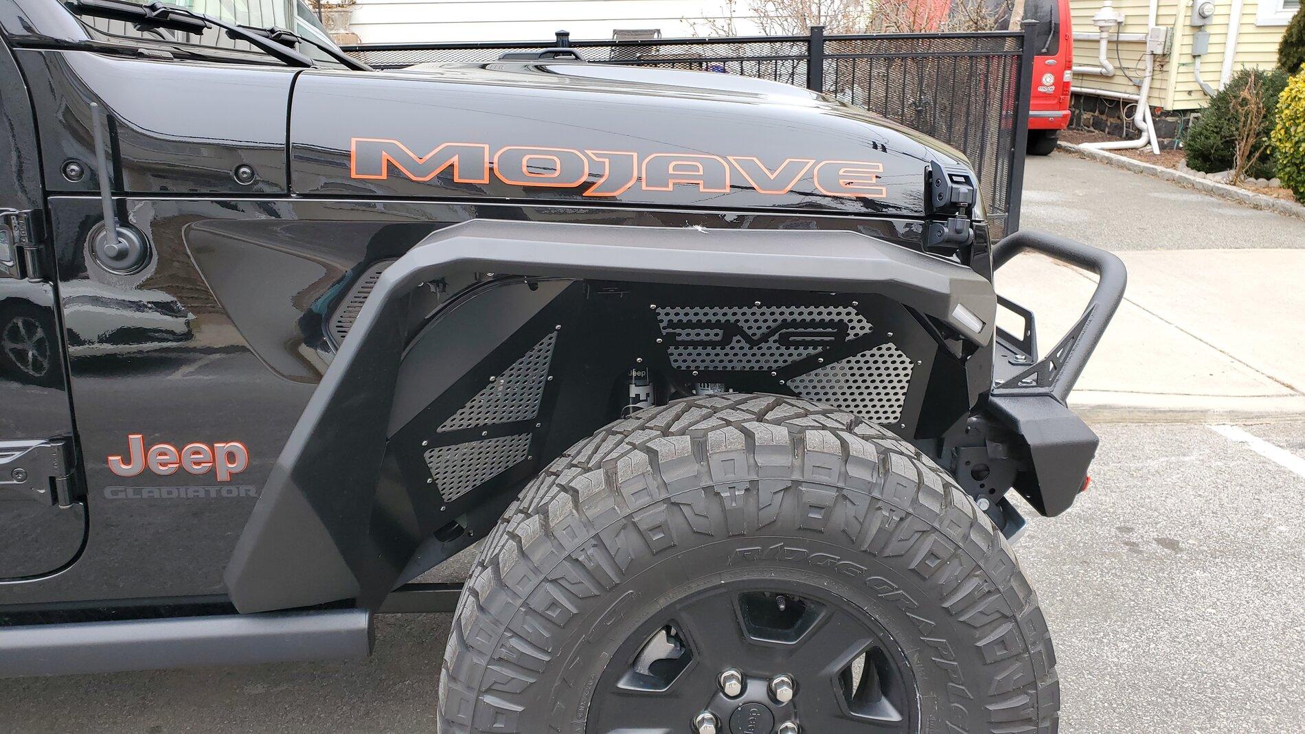

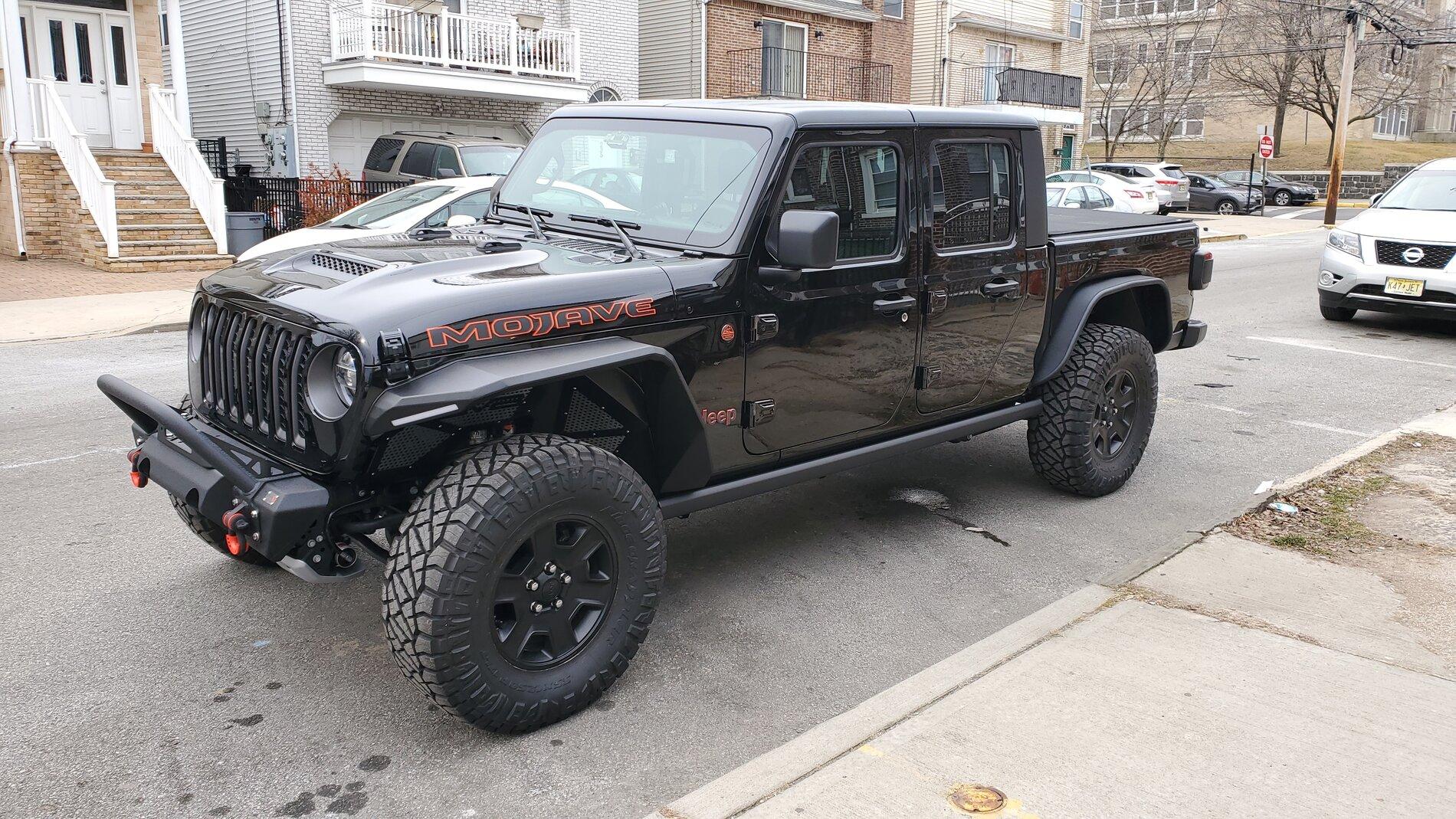

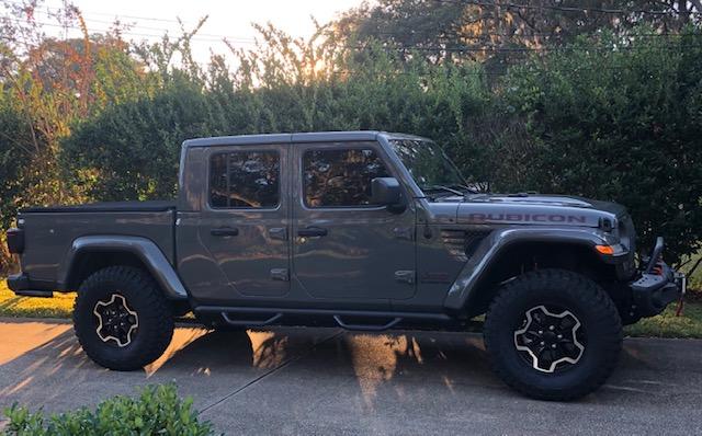

BFG KO2s, 35x12.5, on stock Rubicon wheels. Almost 9,000 miles and no issues. I do have the Mopar 2-inch lift, too.

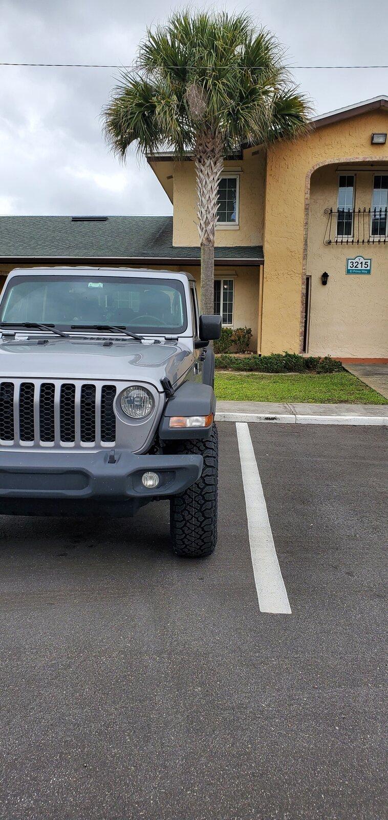

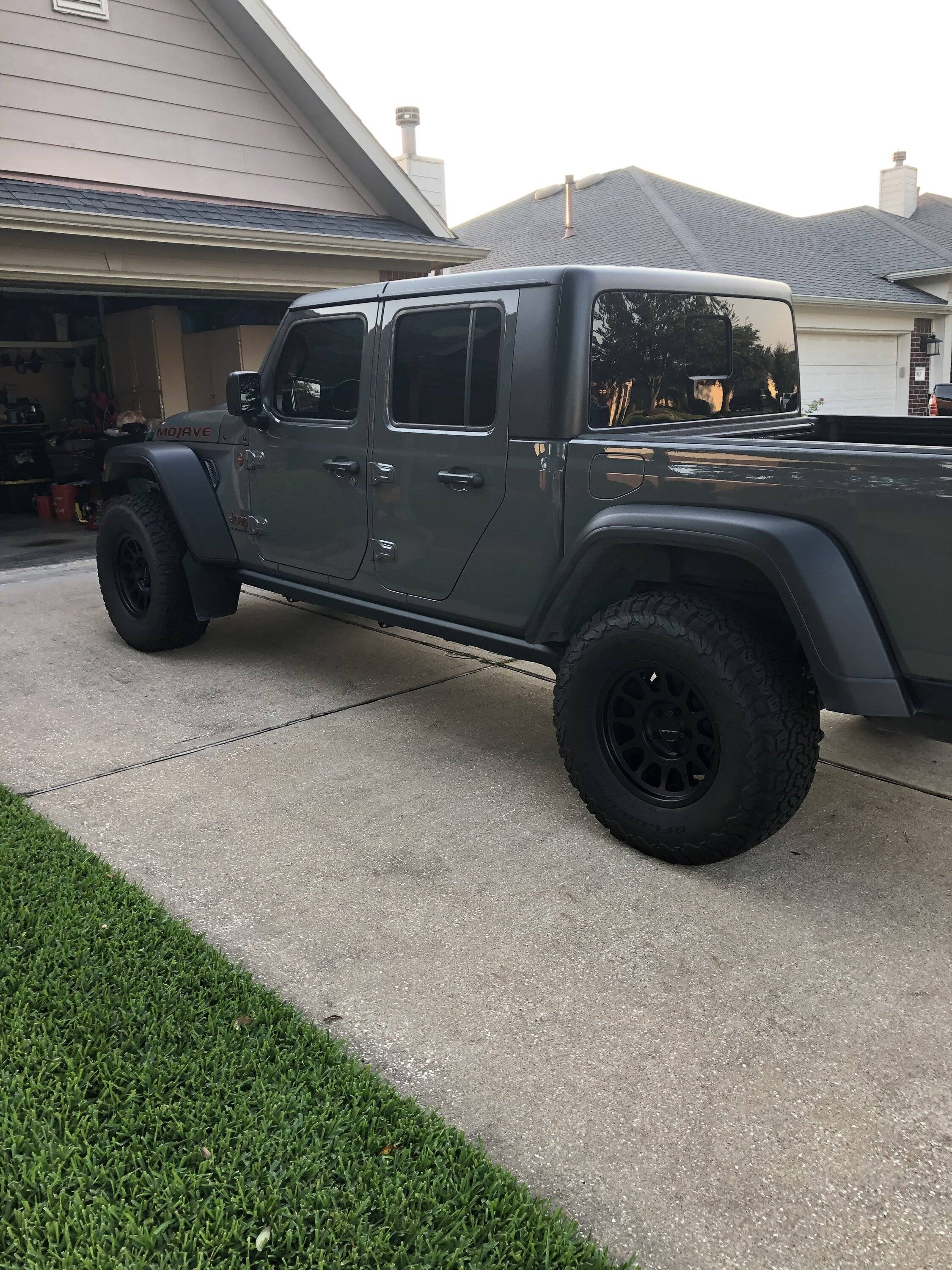

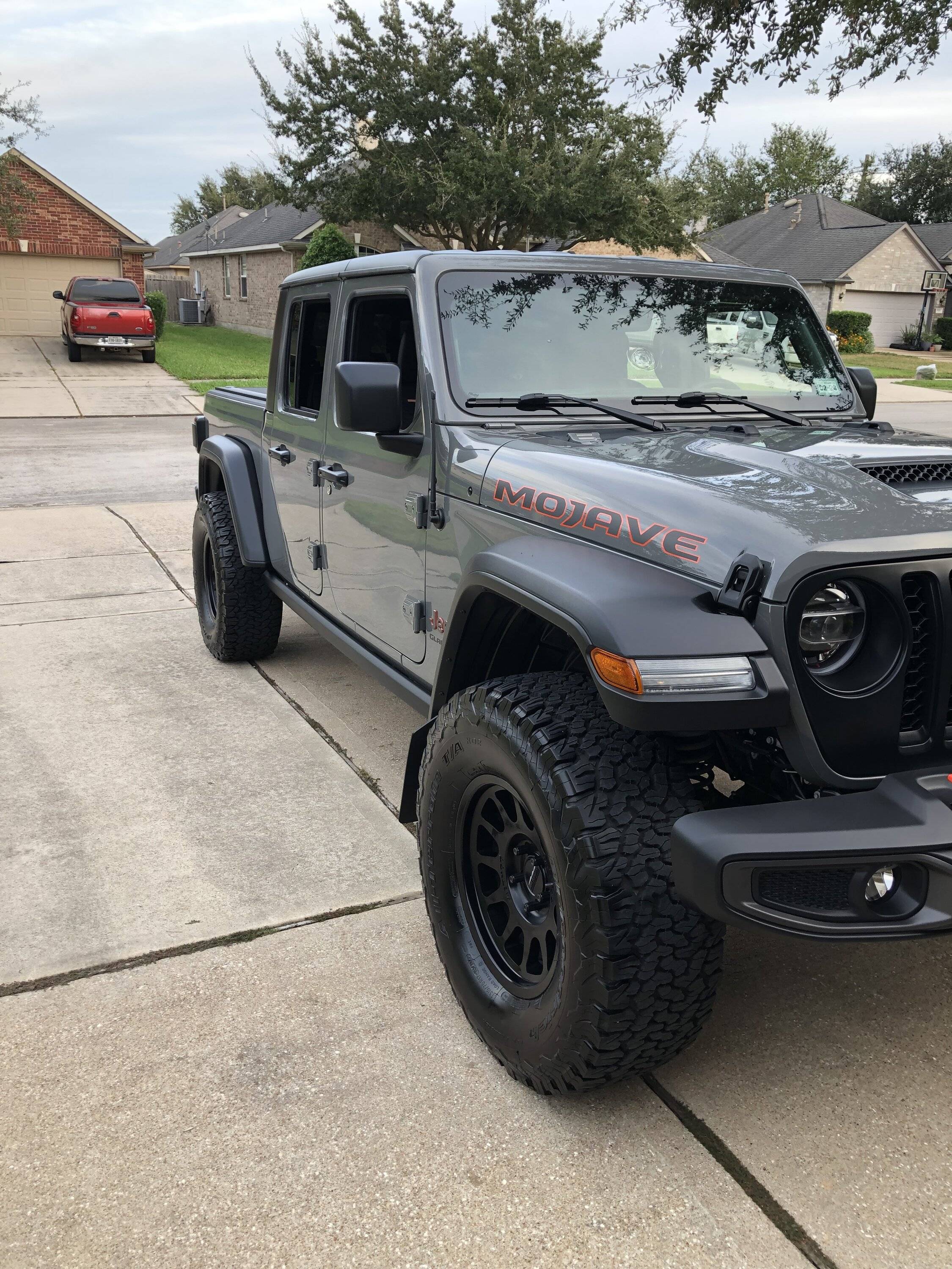

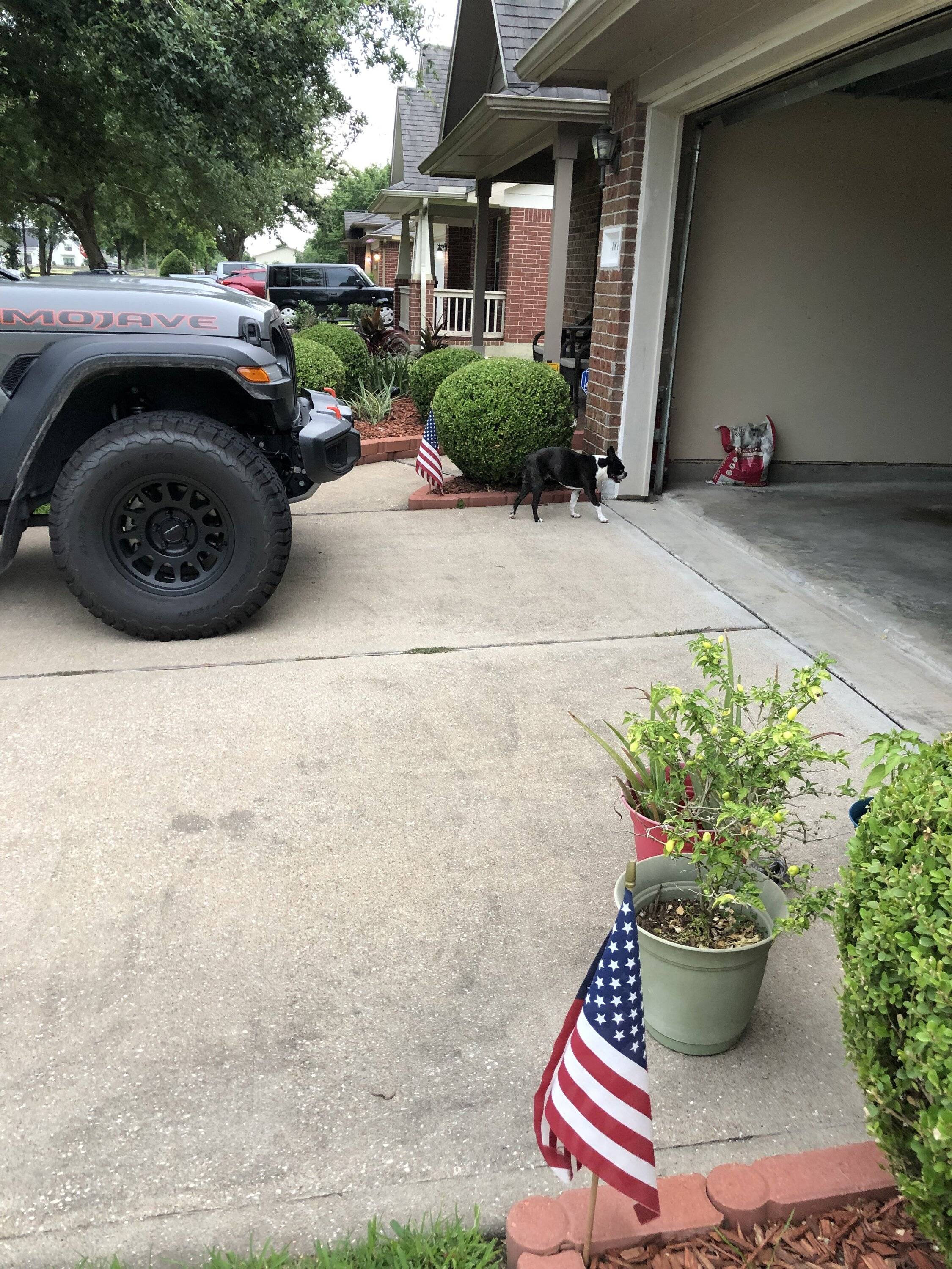

Stock height Mojave on 35x12.5 and no problem.
Jeep Gladiator Anyone running 35s on stock wheels without issues? 65620583356__89A9718C-3E45-40AE-B414-2C7556CBFECC
