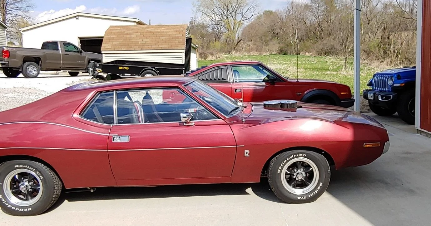

Mark Donahue design spoiler used in the Trans Am races
Jeep Gladiator Overland Owners:  anyone running aftermarket tires on stock wheels? javelin-new-tires007

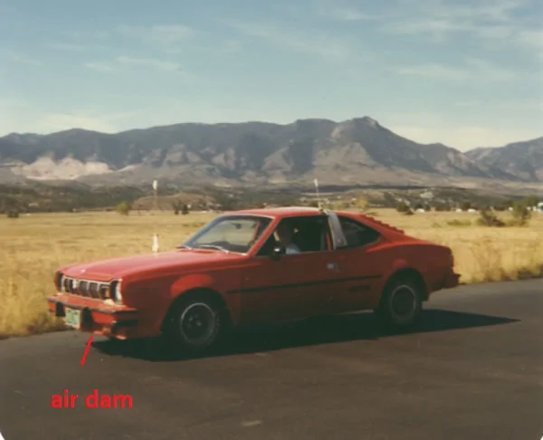

My 77 in Colorado, air dams and other effects.
Jeep Gladiator Overland Owners:  anyone running aftermarket tires on stock wheels? 77-amx-air-dam

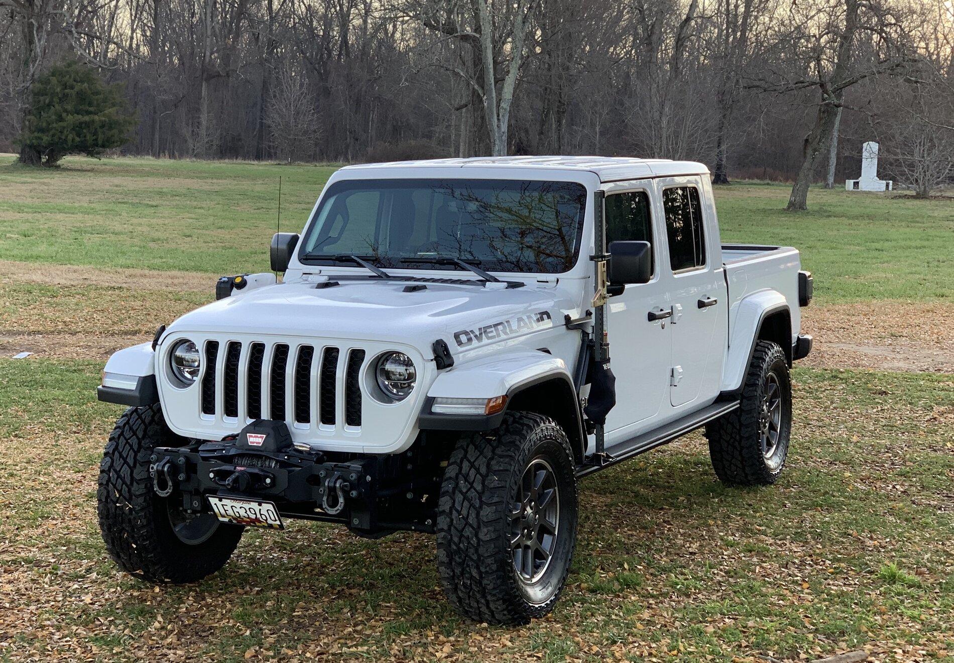

had Nitto Ridge Grapplers added to the Stock 20” wheels that came in my Overland high altitude
Jeep Gladiator Overland Owners:  anyone running aftermarket tires on stock wheels? E5626C56-931B-430C-9589-B5F5B5B94795
Jeep Gladiator Overland Owners:  anyone running aftermarket tires on stock wheels? BAEAE7C4-F59B-48D4-B385-31DDD1B6164D

Heh Spoiler!
So all JTs have an integrated spoiler option!
Note the little "flip up" at the back of the roof - AMC integrated the spoiler into the roof sheet metal so that it could be used in the Trans Am races -
And see - I got the JT worked back into things as it's sitting there in the pic!

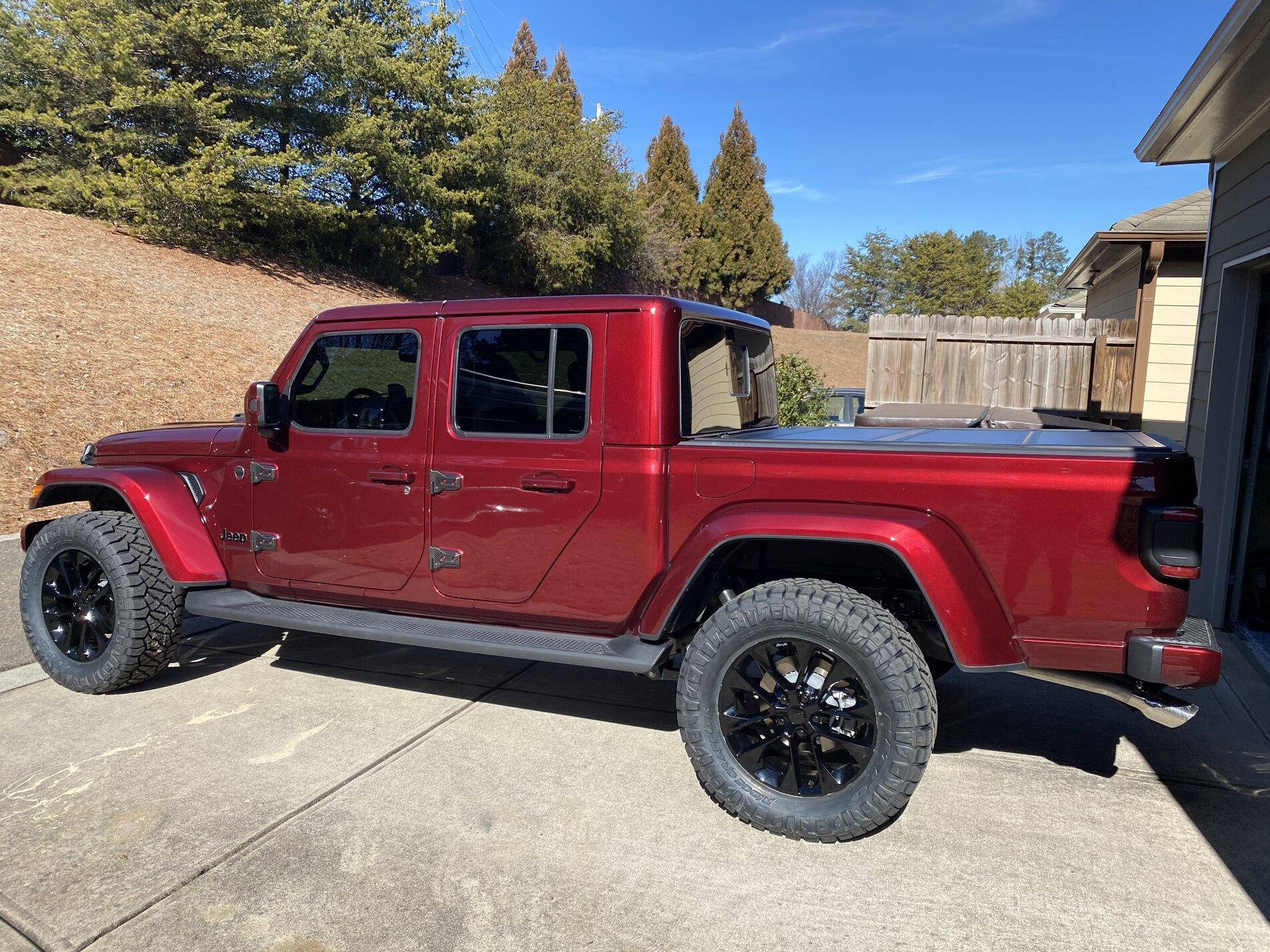

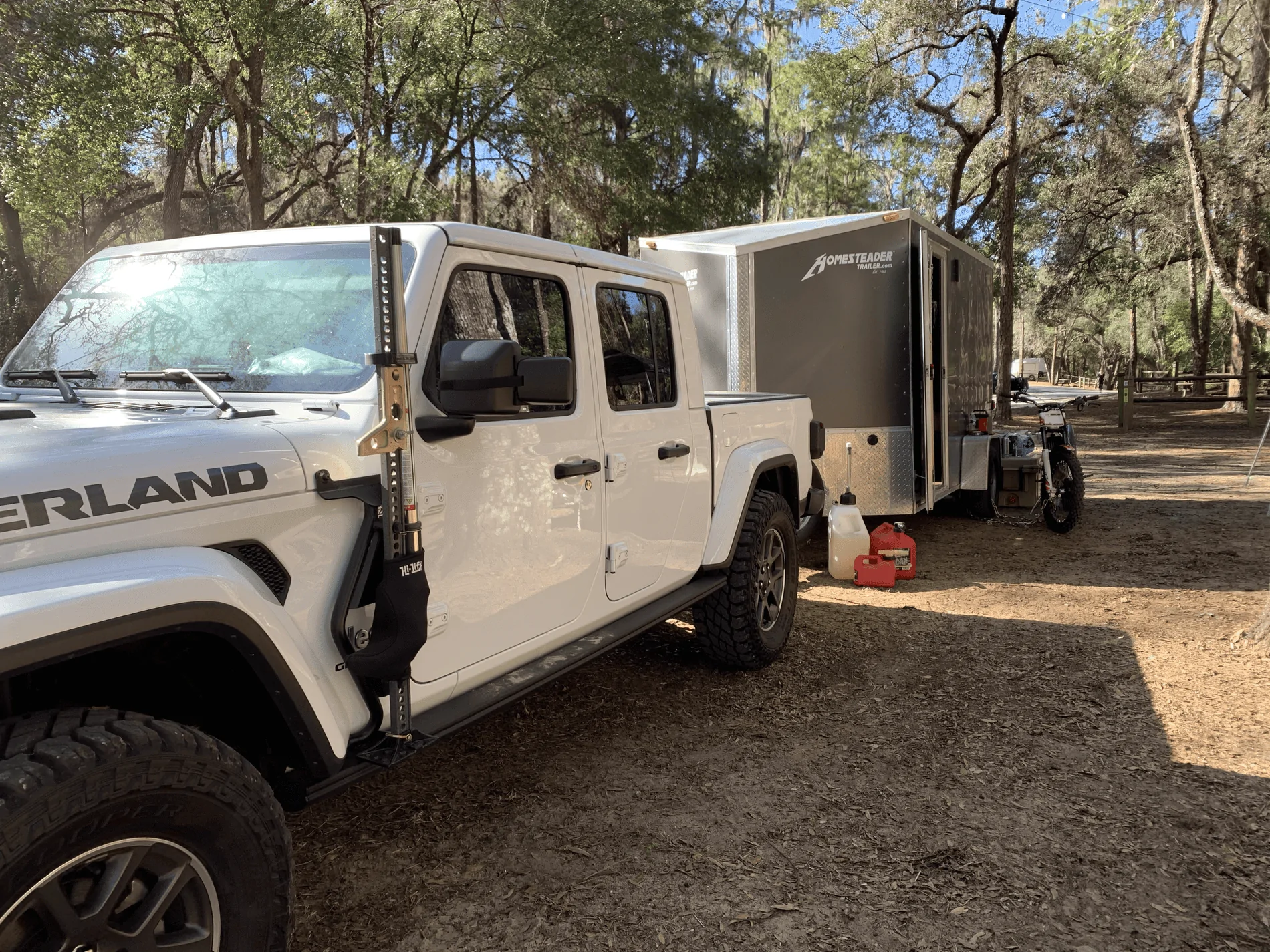

We went with the ST Maxx in 295s on our stock wheels, Teraflex front spacer on stock suspension. Just came back from a 2000 mile trip towing a 7x12 (3000lbs total with cargo). Found it most comfortable doing it on manual mode, just toggling back and forth on 5th and 6th, averaging 70-75mph comfortably. 70mph on 6th is approx. 2500rpm, toggle to 5th 3500 rpms when hitting inclines. 14hrs straight minus gas stops. Temps never read above 210 on cooling. Oil temps went as high as 225, drops down quickly by slowing down to 65mph
Jeep Gladiator Overland Owners:  anyone running aftermarket tires on stock wheels? 14999440-E358-46B8-A6CF-CEBC2D610E9C_1_201_a
. averaged 12mpg on stock 3.73 gearing. Seems this motor is making just enough torque at 2500rpms. I will probably go 4.56 to hit that target and possibly get an overdrive gear back. At this point though I don't see it being an immediate necessity, and get by just doing manual mode.
Jeep Gladiator Overland Owners:  anyone running aftermarket tires on stock wheels? tempImagedRuL7L

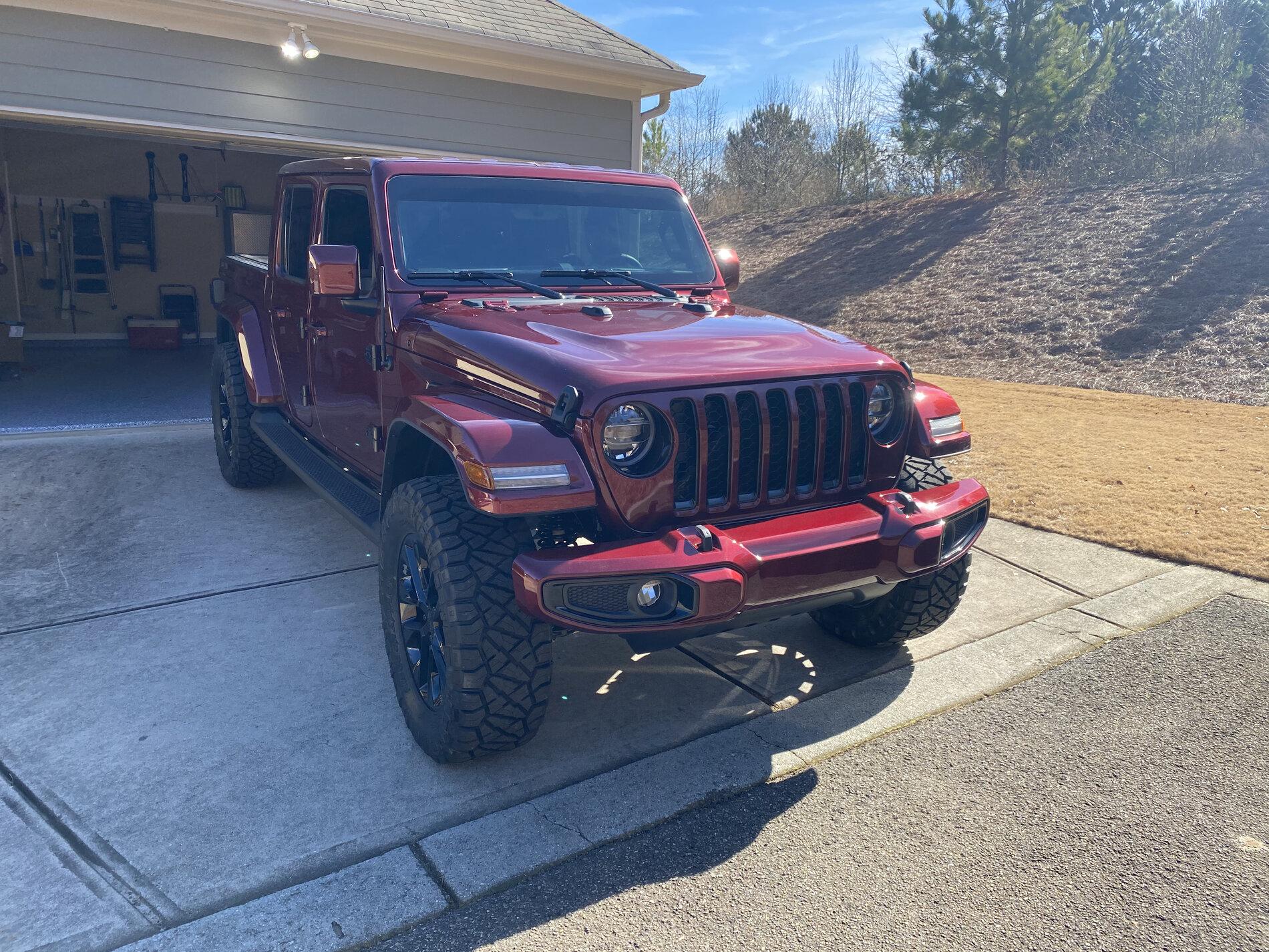

Discount tire tells me that tire size won’t fit. Yours mount up/balance ok ? I have the high altitude in granite crystal. What size spacer you using ?

Looking at my receipt I had a leveling kit done with it and 4 of '5 on 5 JL 1.25" 14x1.5 Hub centric"' used for the spacers. If you need to call Southern Off ROad Specialists at https://southernoffroad.net/ and ask for Ross.
