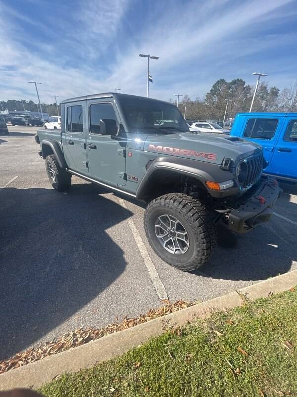

I test drove a 24 Mojave with these (pic) and the transmission seemed to struggle finding 8th gear. The Mojave only had 70 miles on it so, I guess I’m wondering if the engine just takes time to adjust? Pardon my ignorance 😔
thoughts?

Too many variables. Was the computer updated for the larger tires? What speeds were you running? Up hill/down hill? Headwind? Tailwind? On 37s and 4.10s I still see 8th, but it can't be the slightest up hill or headwind or speeds under 60mph. Anything that even slightly increases load and it cruises in 7th.

I took it on the interstate but there was definitely head-wind.
I’m not sure what computer calibrations were made.

No, it doesn't get better, it stays slow lol.
