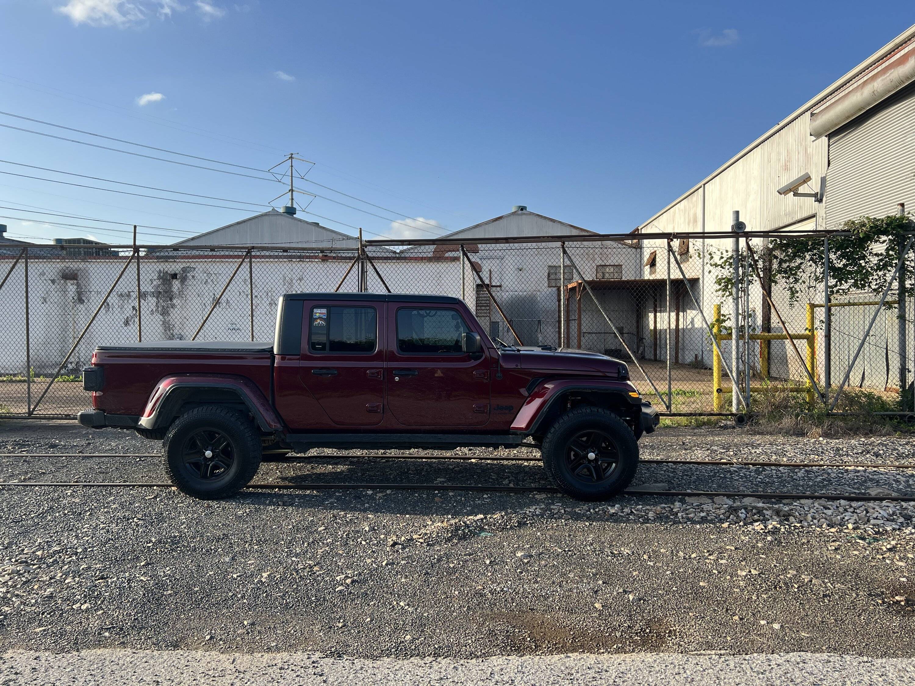

I'm looking at 315/70/r17s on stock wheels with a 2.5" front leveling kit. What size wheel spacer would I need, if any?

I do have a MaxTow. I'll probably just get 1.5" spacers. Ask the boys at Discount see if rubs without. If it does I got 'em. If not I'll send the spacers back.

I did with my max tow several weeks ago. 35x12.5 Goodyear Duratracs. I used 1.75 wheel spacers and had no rubbing on the street. Love the stance too.
Now, I have since added the ReadyLift SST 2.5 in the front and 2.0 in the rear. Honestly, it looks perfect to me..
