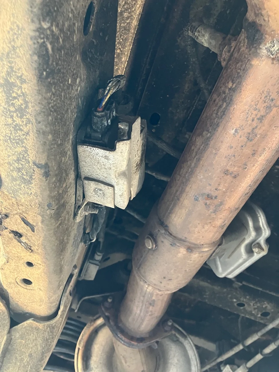

This is the only thing I saw that’s even remotely close to the size of a deck of cards. Anyone recognize it as something else?

Well that is a bummer. Sounds like it is integrated with the RFH, as they say.
