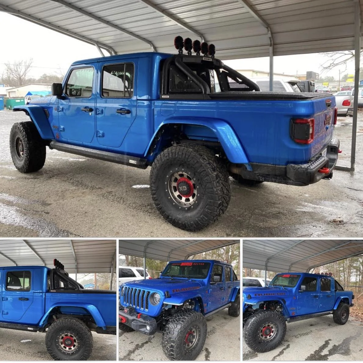

There’s a member on the Facebook Gladiator forum who installed a Go Rhino Sport Bar 2.0. From what I’ve read, it seems the Sports Bar 2.0 fitment for the Colorado or Tacoma will work for the Gladiator. Has anyone here tried this?

Looking at the measurements, yes, the Colorado version will work. The outer dimensions of the 2.0 bar is 61.5", which is nearly dead-on to the outer edges of the plastic Gladiator bed caps. Also, the mid-line measurements of the sport bars is 58.5", measures out in the middle of the two plastic groves on the Gladiator bed caps...so, in theory...yes it'll work.

That actually looks pretty cool!

Obviously it works we see it in the picture there but I did contact Go Rhino to ask about it and even though on their website it says universal for midsize trucks it isn't made for the Gladiator. No idea why not but that's according to them.

Need more pics of this. It looks awesome!
