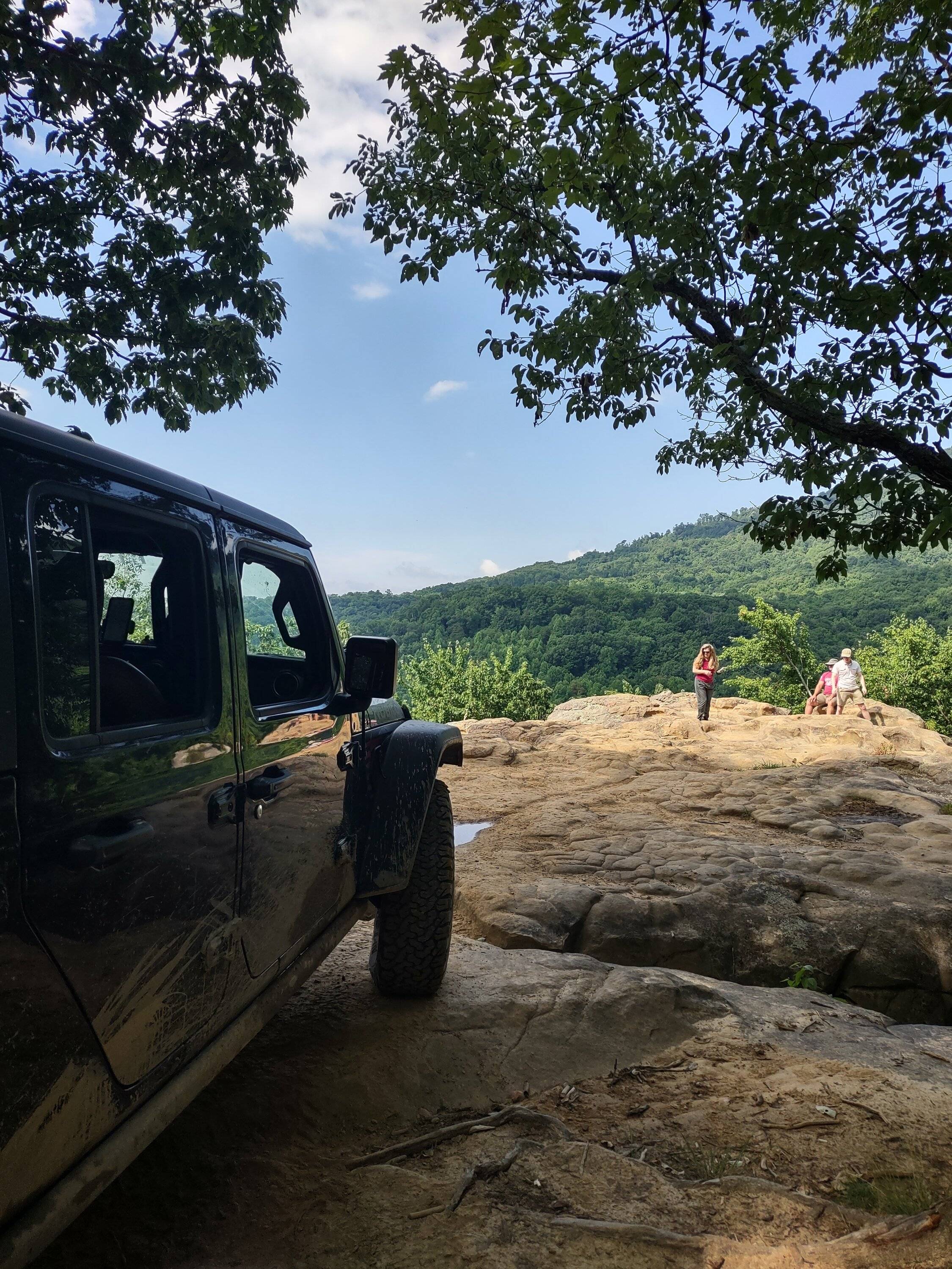

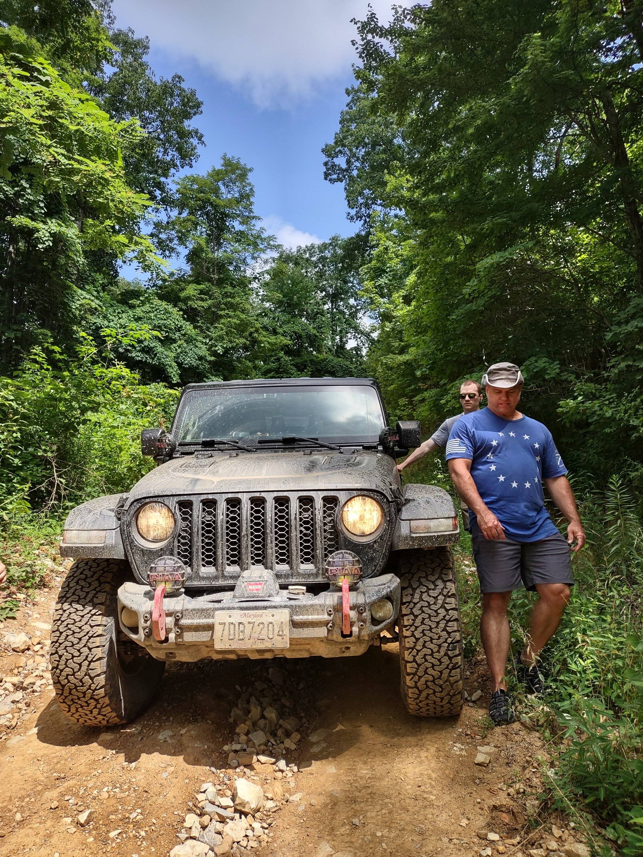

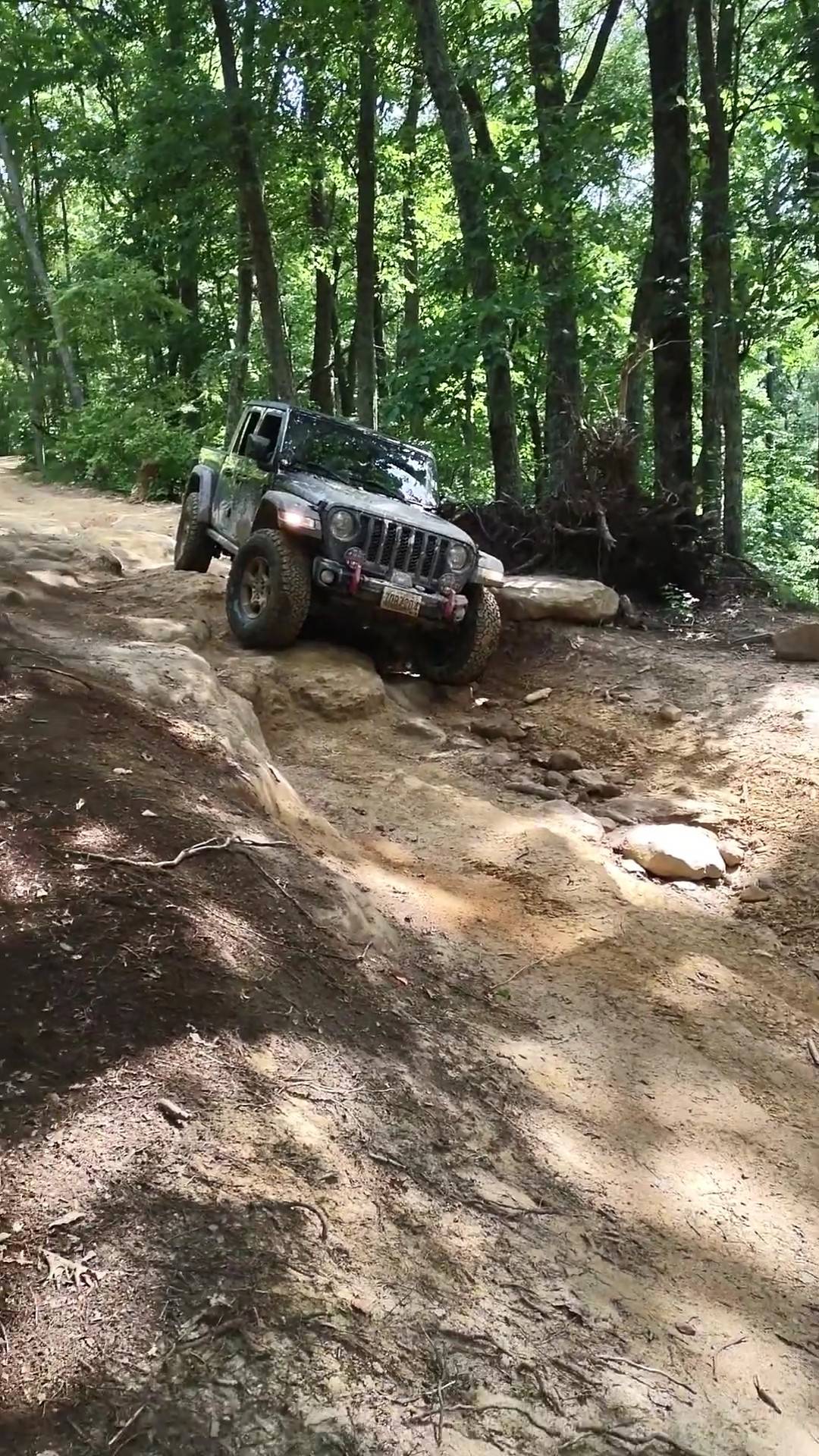

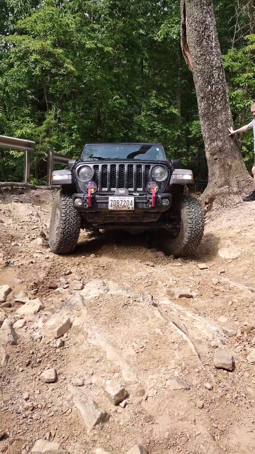

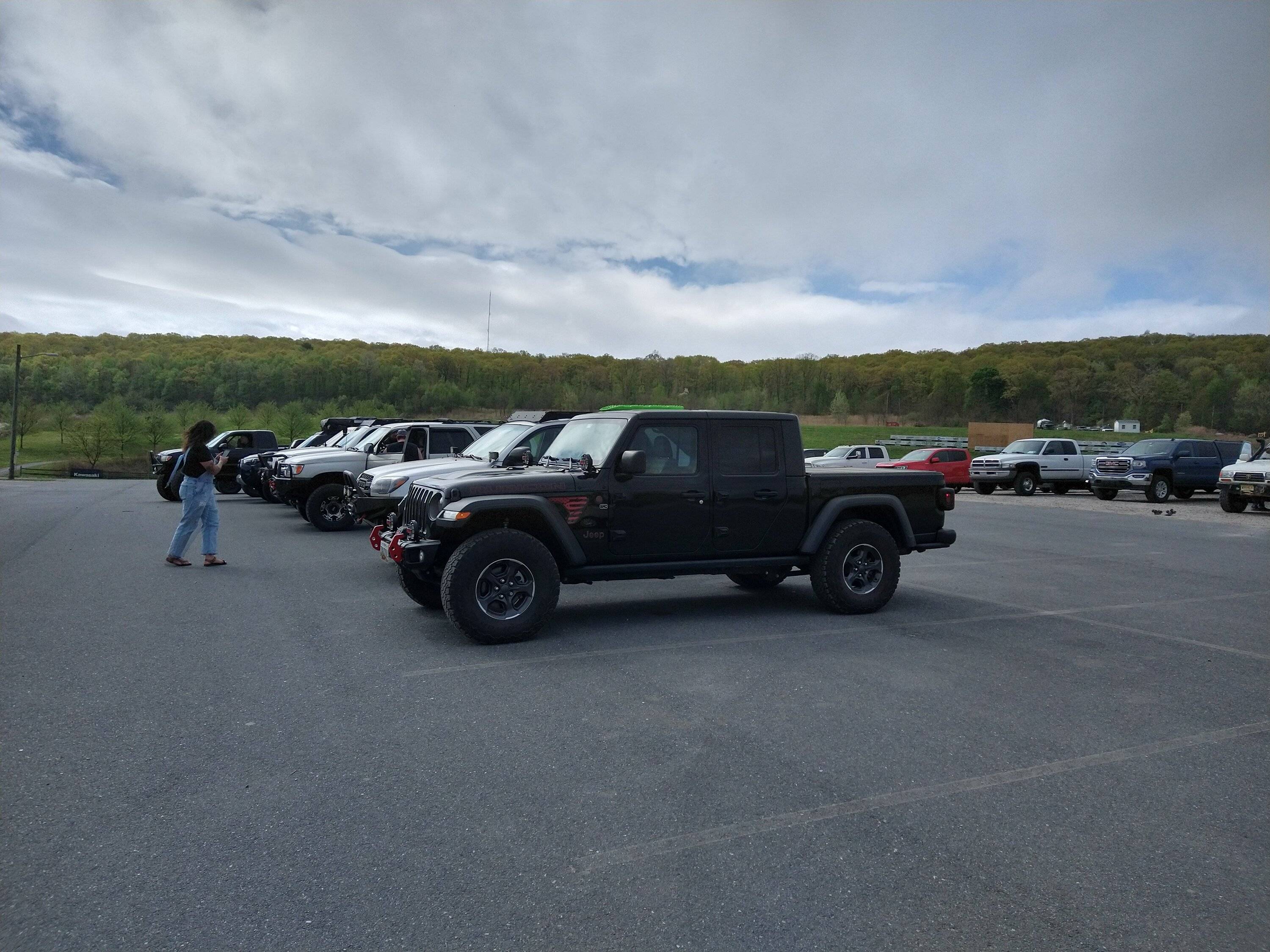

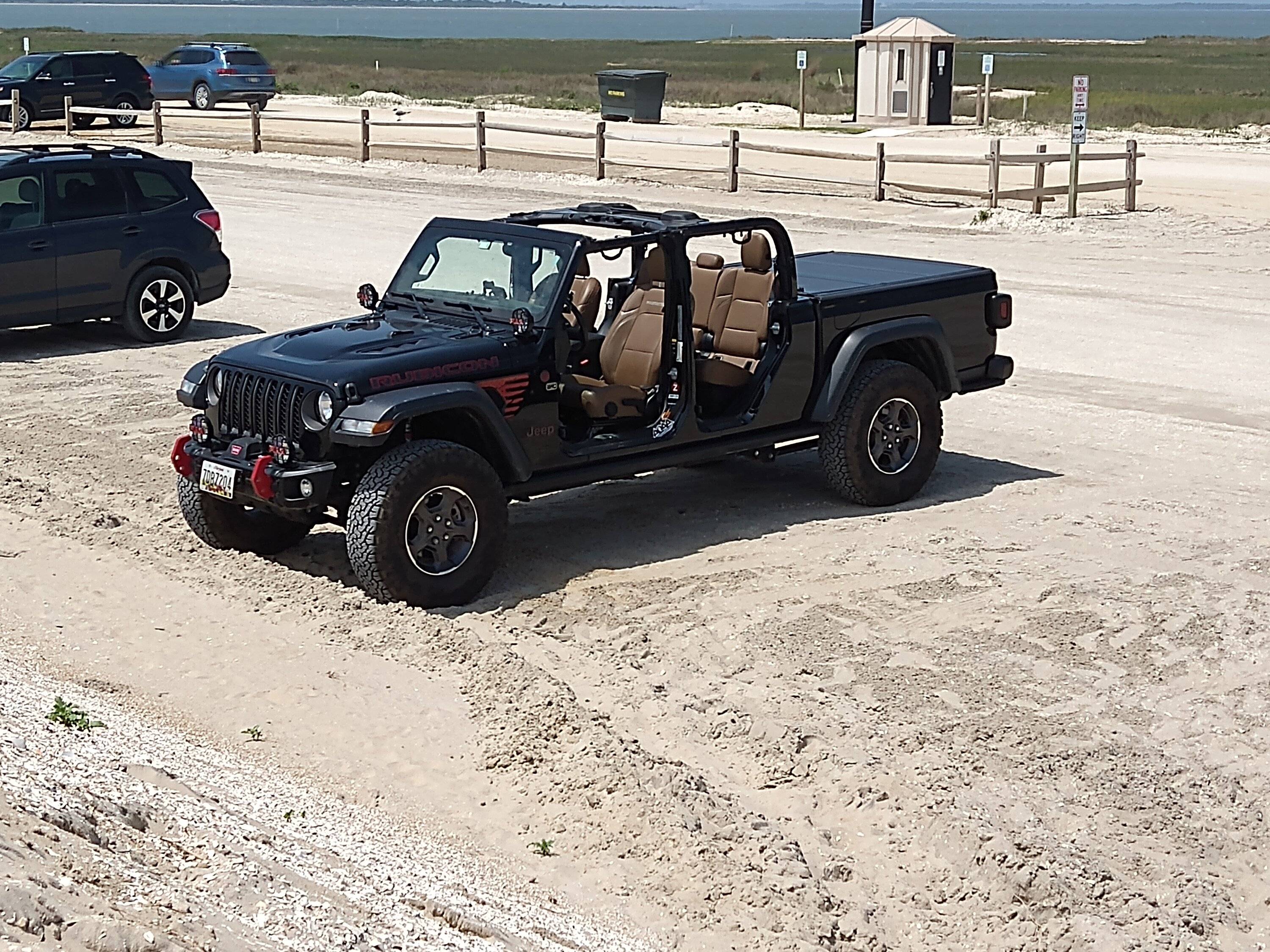

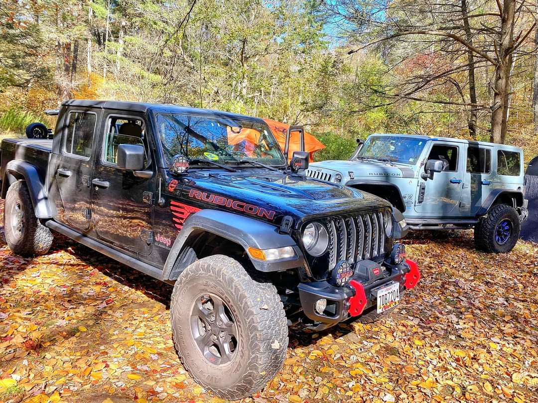

I have been running 37x12.5R17 BFG TA KO2s, C rated, on stock rims for over a year with a 1 3/4" level front 3/4" puck in the rear. They have held up fine to everything I have done including rock crawling. AOAA blues/blacks, Rausch Creek blues/blacks, Pott's Mountain. Uwharrie, Windrock plus heading to Moab in May. I currently have 12,000 miles on the tires.
I still have 4.10's and have averaged about 18 MPG day to day and on highway trips 19/20 if I keep it under or around 70 MPH. I air them at 33 PSI cold which increases to between 35/37 on the highway and seem to be wearing well. Also the spare fits in the stock location which is a plus.
Last year I did not seem to rub at all but a few weeks ago at Rausch Creek I finally got some rubbing on the front inner fenders. I added Metalcloak Undercloak belly skids this winter so I am guessing the extra weight cause that new issue.

Really appreciate that, have any pictures by chance? Did not want any rubbing, will be mainly on road minus some backwoods trails, no rock crawling.
I am not a big picture taker but here are a few from my phone.

Awesome thanks, its like my twin. Mines a black rubicon and just installed the Arcus bumper as well.

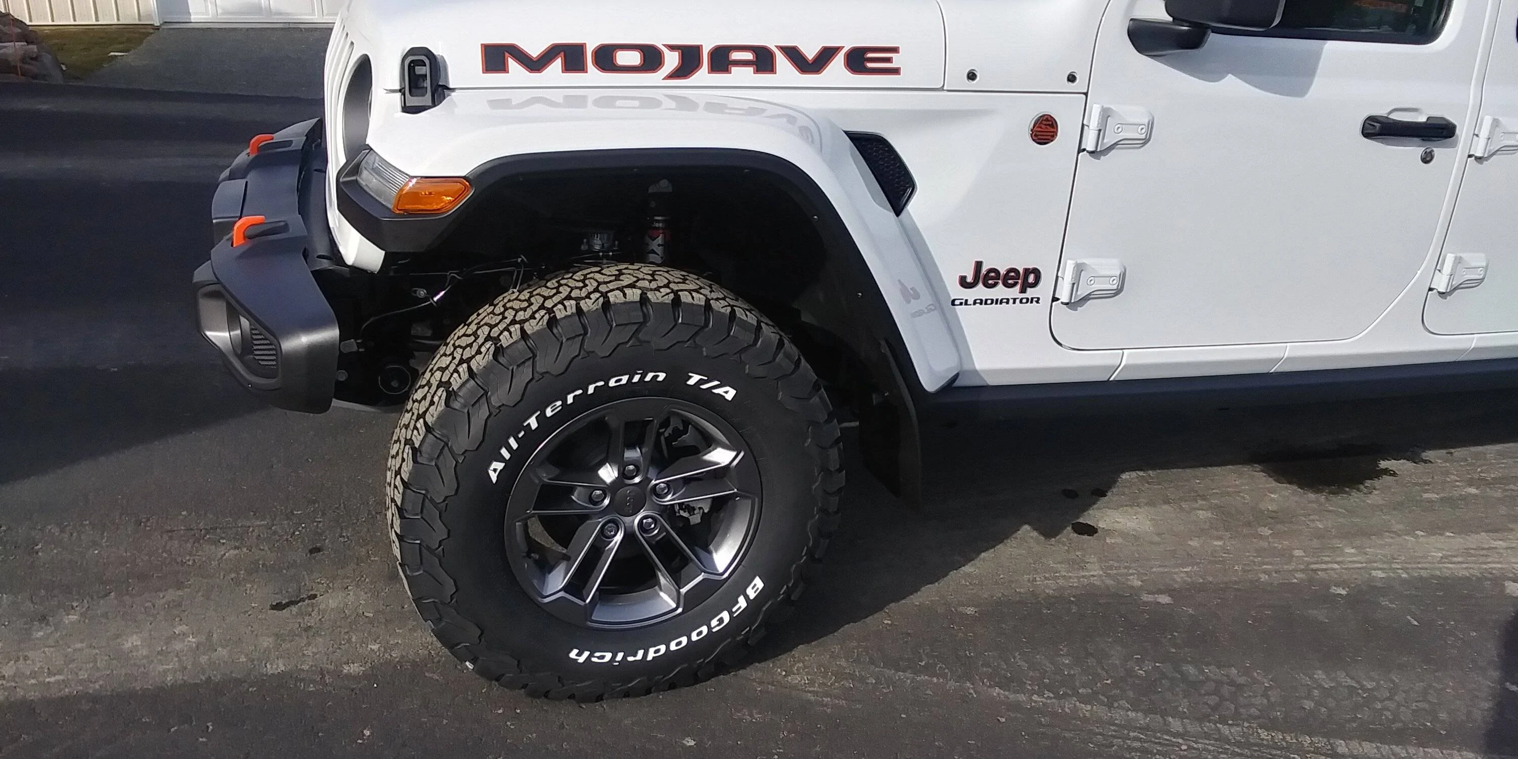

Not doubting what you state for your mileage. We just often compare here.
I am running load range C KO2's in the stock (Mojave) size of LT285/70R17. True diameter according to BFG is 32.8" with a weight of 51.4 lbs. Wheels are Quadratec Gunmetal 41 with a weight of 31 lbs.
But as we have all said in the past as we compare, these JT's were not built for mileage!
