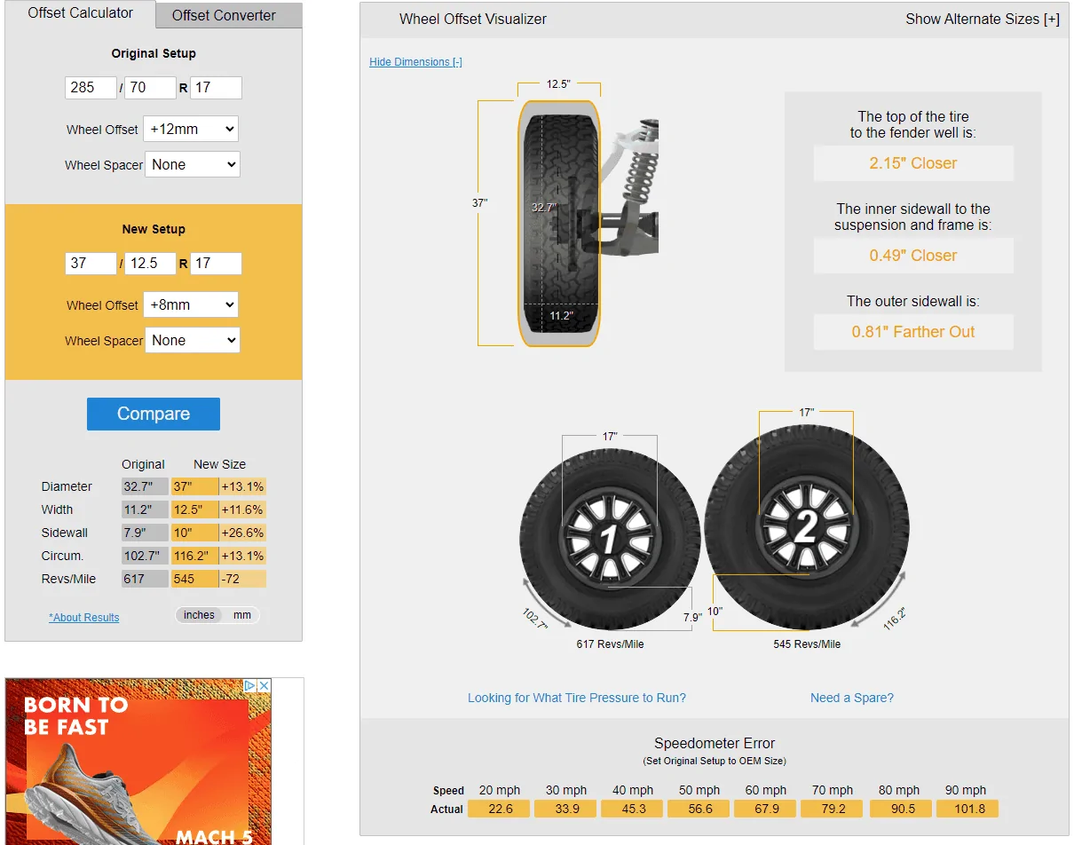

@CGilly6 What are the wheel specs on those KMC's, are they the KMC KM541 Dirty Harry's in 20x9 with the 5x127 bolt pattern, 0 offset? Did you need to add spacers or do anything else? I've been debating some 37 Coopers on 17's but those 20's do look fierce. I'm looking to add a AEV 2" lift kit but want to avoid any rubbing. Any indication of wobble??
I also found a cool site to calc and visualize offset: Wheel Offset Calculator (tiresize.com)
Jeep Gladiator Anyone Running 37s on 20s? Here's a Possible Deal Screenshot 2022-08-05 160027
