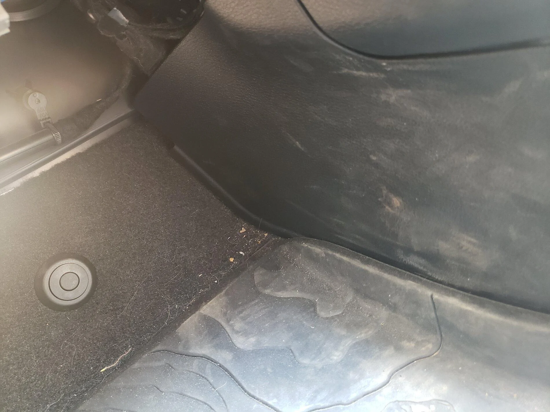

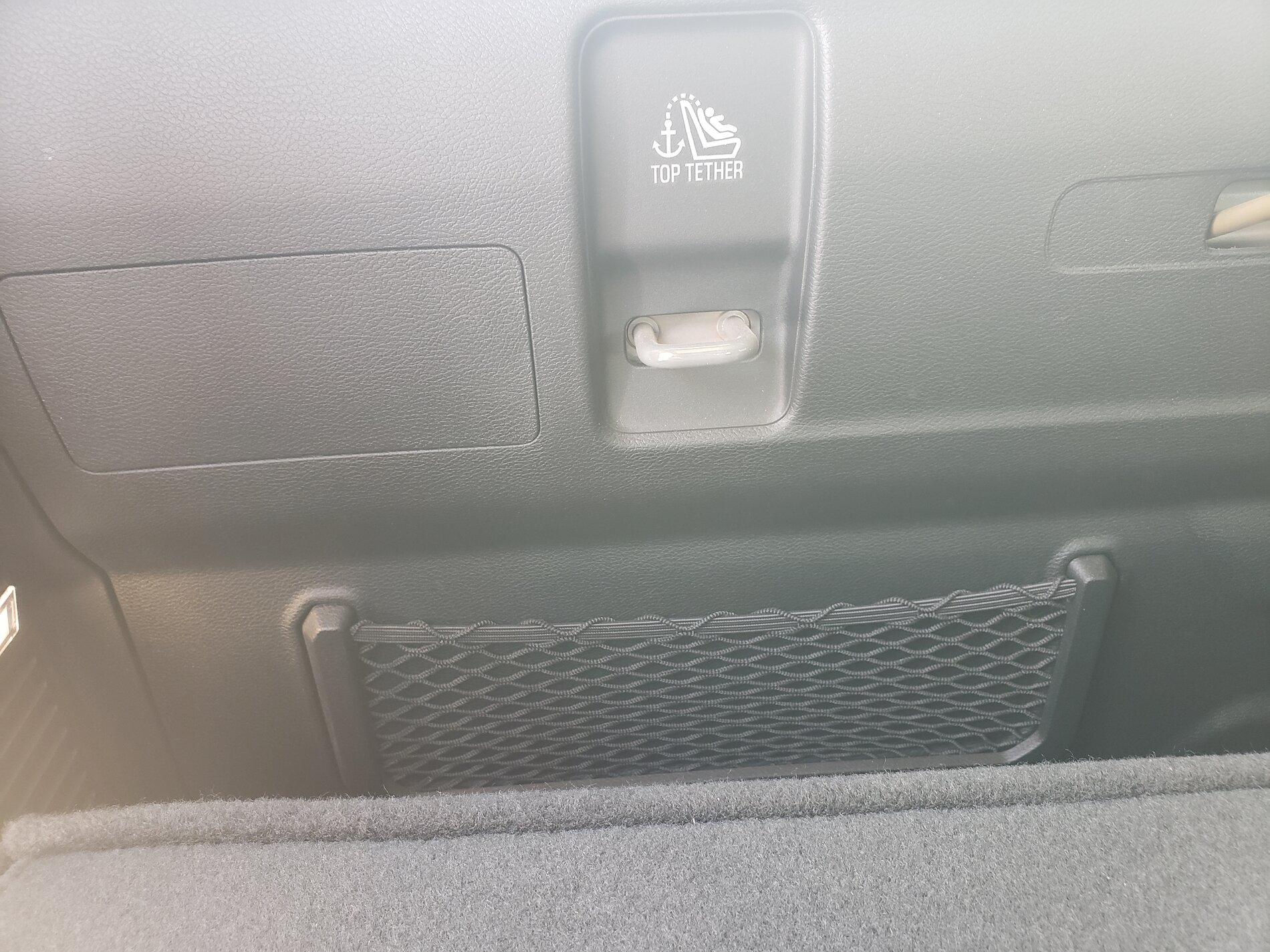

If you plan on installing your amps under the driver or front passenger, there is a ground stud near the center console.

Where in the cab are you installing your amps?
1 behind the back passenger seat.
Jeep Gladiator Ground inside cab? 20210701_100517
And one under and to the right of the glove box.
Jeep Gladiator Ground inside cab? 20210701_100610
I'm thinking I can ground to a seat bolt.

Also, grounding to aluminum works but not ideal. Safer to ground to a factory ground stud.

Also grounding to aluminum works but not ideal. Safer to ground to a factory ground stud.
[/QUOTE]
I agree, and my mistake, I wasn't aware that the tub was aluminum. I would not ground to aluminum.
