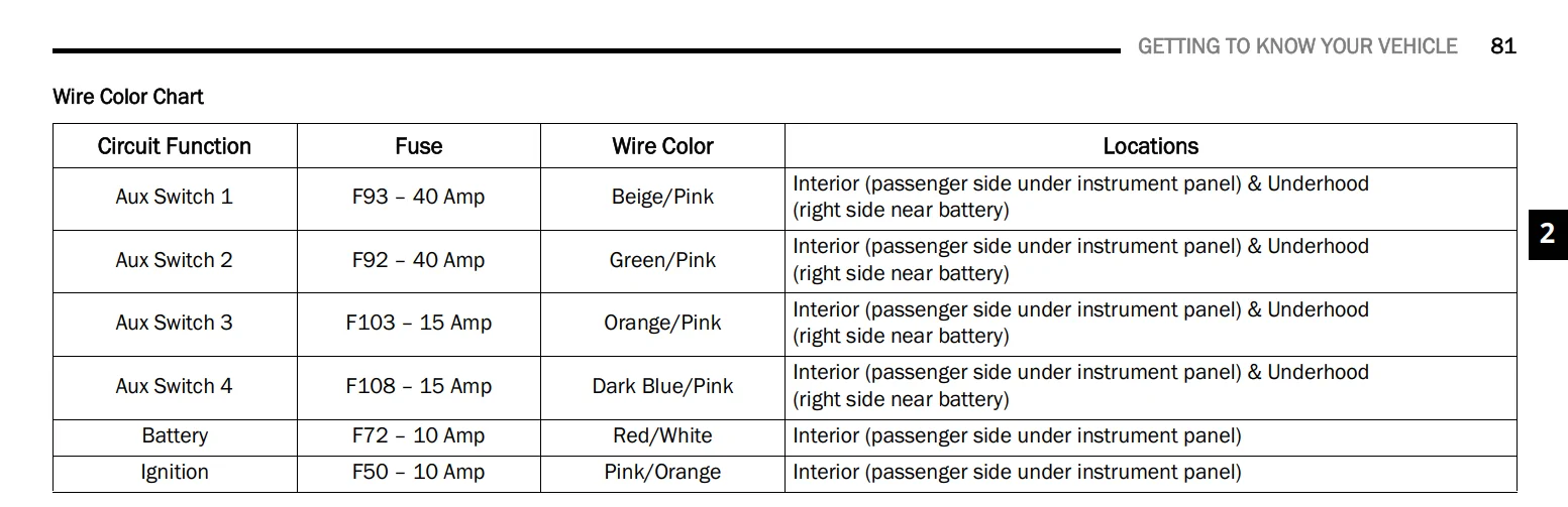

I found the 6 aux switch wires - 1 bat, 1 acc, and the 4 for the switches, next to the center by the passenger's left foot area.

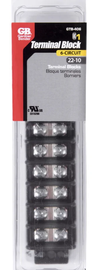

I didn't want to crimp connect, I wanted a simple/easy, way to disconnect if needed or even connect other things to those wires, so I got the bright idea (yet to be seen!) of using a 6 position terminal strip. In the end, all 6 aux switch wires would go to terminal screws like I've done under the hood for the 4 aux switch wires there.
The feed for the snow plow control would go to the terminal in the strip where the aux switch acc power wire is connected.
However - no place to mount the terminal strip!
Right now I have the terminal strip behind the glove box, zip tied to the wires that go to the CANbus connector to keep it from ratting around.

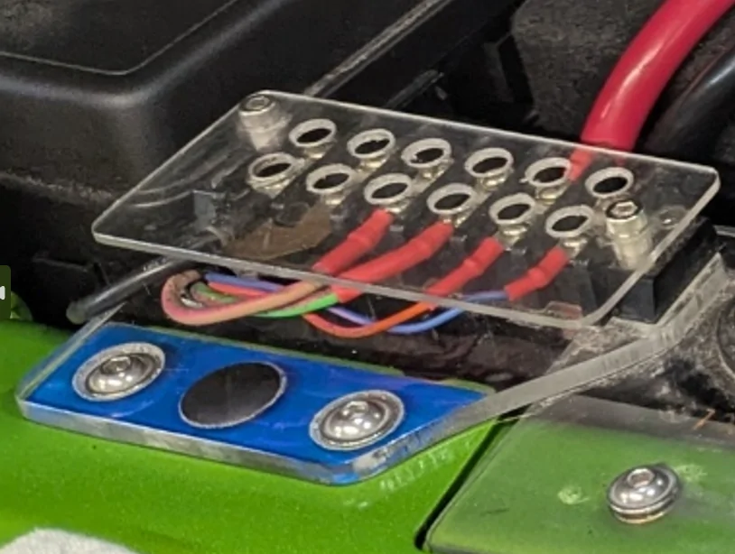

This is what I've done under the hood -

This is the strip I want to use to the right of the center "stack" or whatever, to connect wires to - maybe just screw it to the right side of the tunnel - screw it to the carpet ?
This is what I have zip tied at this point, to the CANbus junction wires to prevent rattling.
Aux switch wires to this then accessories, such as my plow remote control to this block.
6 position is perfect - ACC/BAT/AUX1/AUX2/AUX3/AUX4

Key word here is "factory". Factory has 6 wires inside the cab and 4 in the engine bay next to the battery. If the aux switches were added later via the Mopar kit, then there are the same 4 in the engine bay and only 4 inside the cab. The Mopar kit only has wires for the 4 aux switches, no direct to battery and ACC switch. The Mopar kit also adds a relay box and 4 fuses under the hood separate from the PDC. The RTFM warns for each AUX, use only one of the two available connections at a time. For instance my AUX 4 controls my Warn Winch Solenoid using the AUX 4 wire next to the battery. My AUX3 controls my GMRS radio using the AUX 3 wire inside the cab. The RTFM says not to use the same AUX for both.

TBH I didn't read your whole original post as I was also listening in on a meeting 😆
Terminal strip is pretty much your only option then. If I remember I'll look at my truck this afternoon some and see if I come up with any cool ideas. I wired new emergency vehicles for years but they have way more space to use than a Gladiator.
