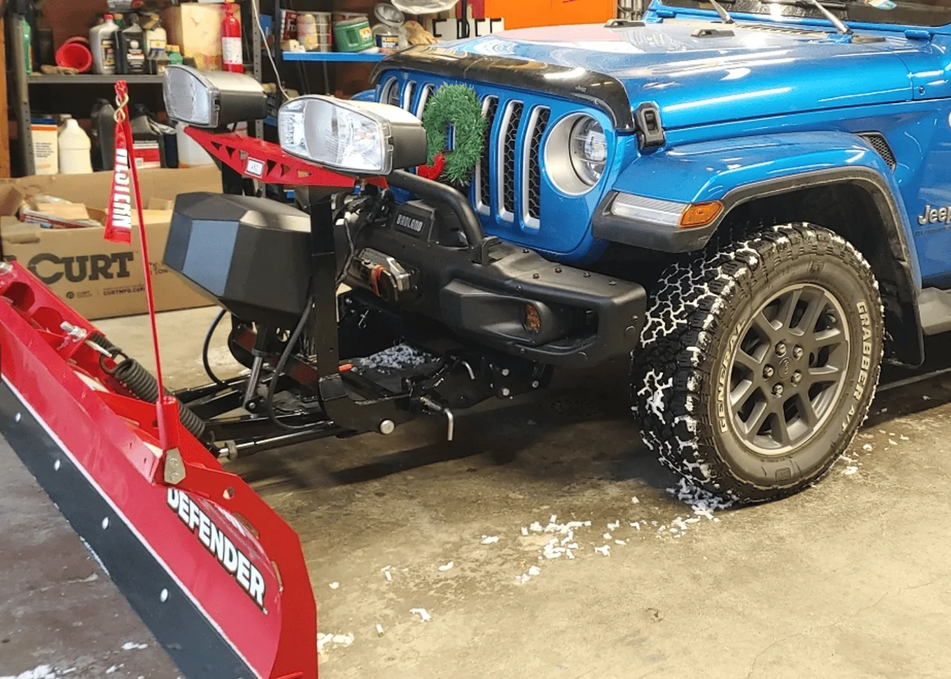

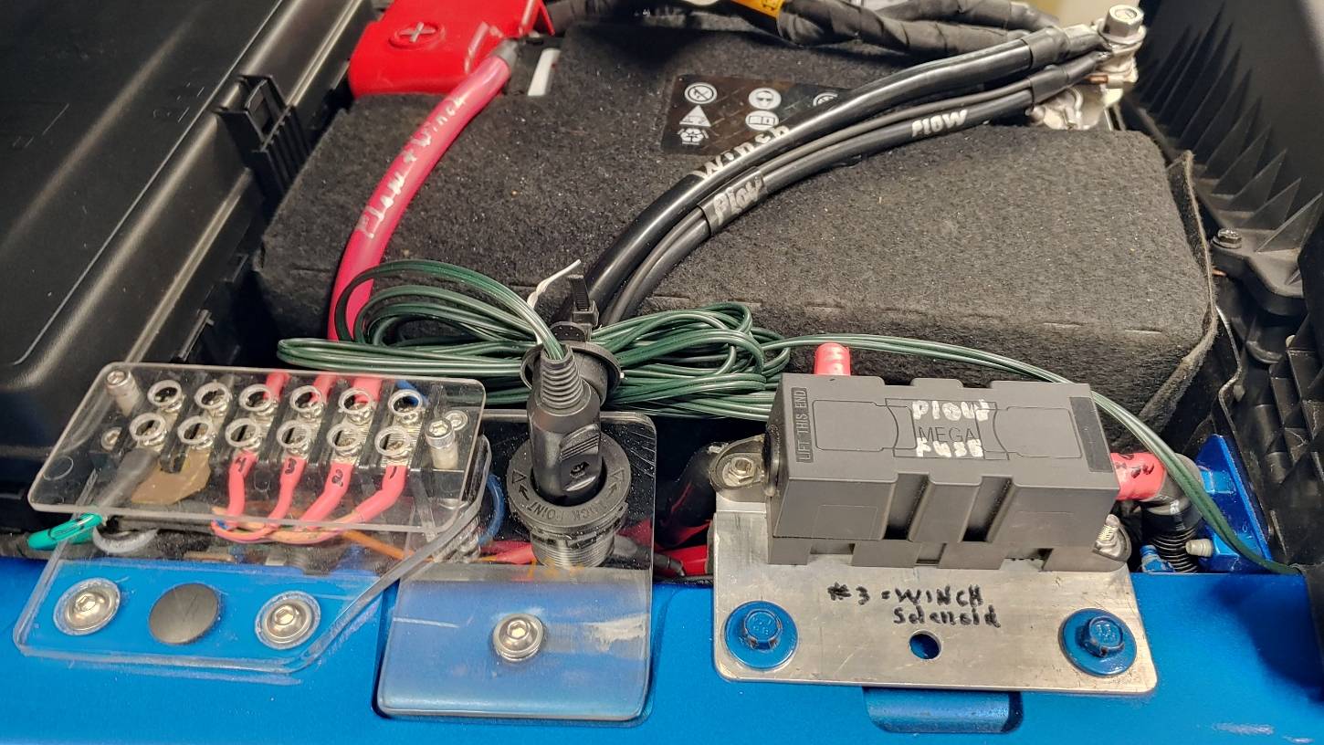

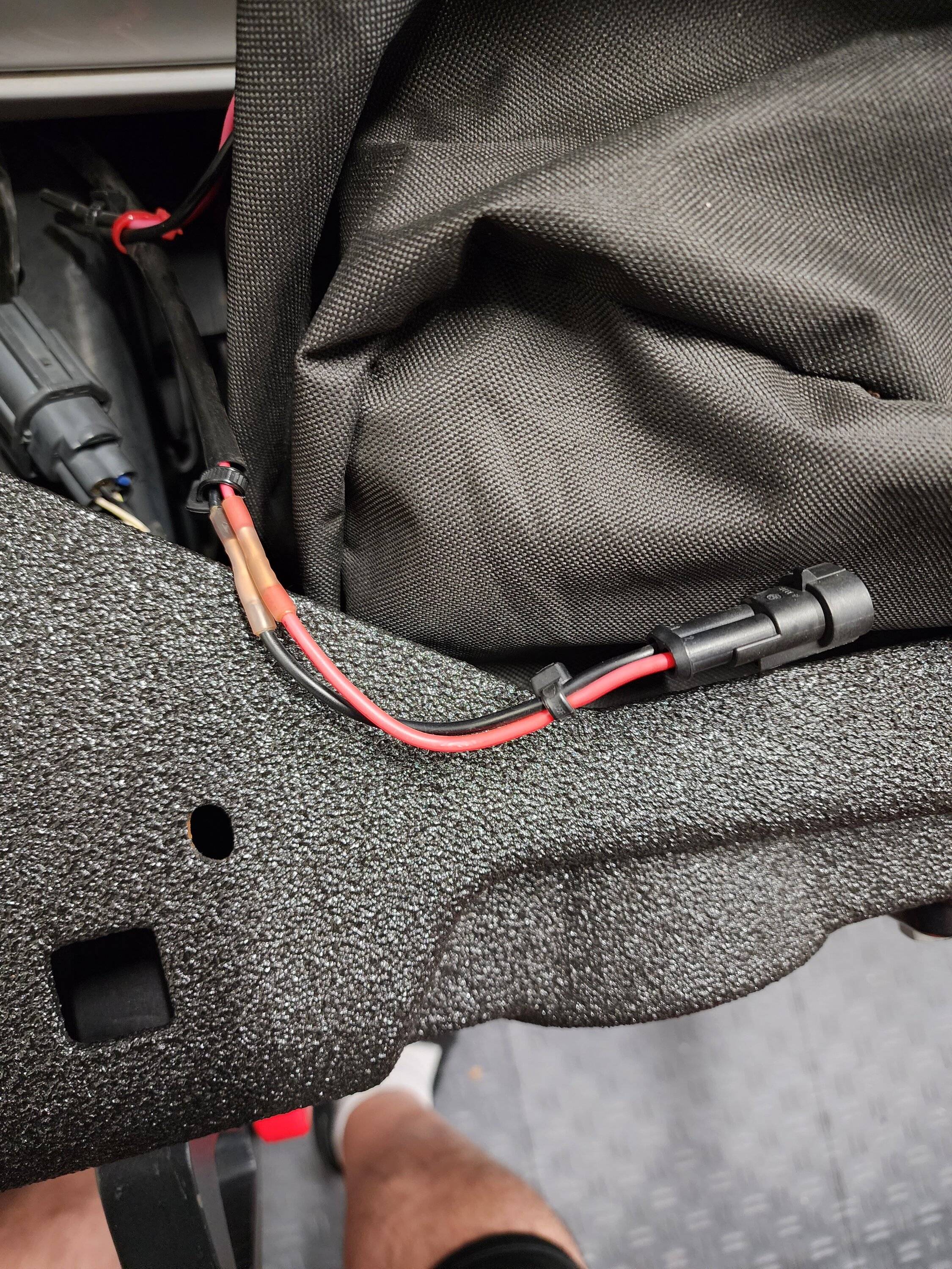

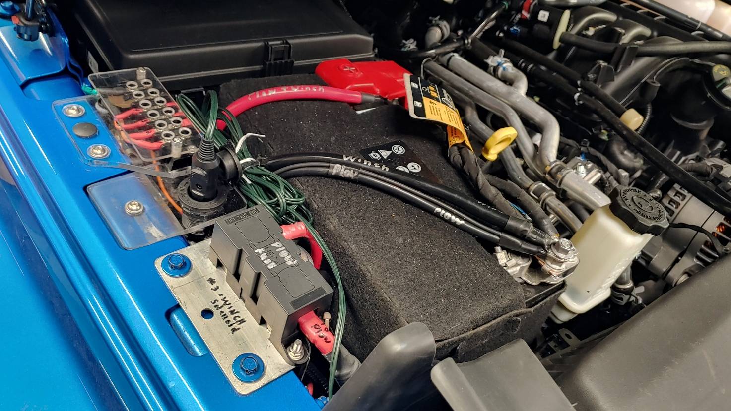

The wreath I have had a standard 12v cigarette lighter end on it. It has two wires, red and black. I cut the 12v end off. I then used a pair of waterproof heat-shrinkable butt connectors and attached one of the 2-pin terminal connectors I bought from Amazon onto the wreath's wires (matching red to red and black to black). I attached the opposite end of the 2-pin terminal connector to one of my factory aux switch wires (if your Jeep has them, they're found under the hood along the edge between the battery and air cleaner box). I posted a link to the 2-pin connectors in my first comment. Here's a pic that may better demonstrate what I did.

I forgot to mention - I got the 12v outlet on Amazon and made the mounting bracket for it. It was sort of an after-thought after running the wire from the wreath all the way back in the gap between cowl and fender, and in through the passenger front door to a 12v outlet inside. I thought that's a crock to do every time - so decided to keep it cleaner and easier plus I can plug in a 12v trouble light if I ever need to see in the engine bay in the dark.
