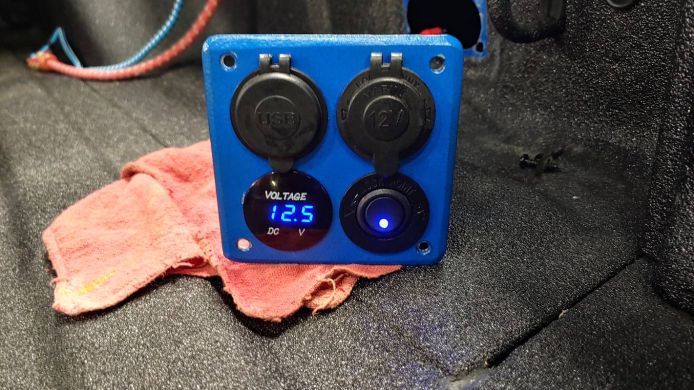

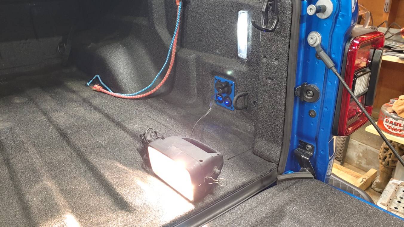

i run mine through one of the aux switches - 2 USB charging ports (not fast charge, but that's ok with me), a 12v outlet, volt meter and switch - so when sleeping in the back I can also turn them off without getting out.

I can charge my hearing aids and phone on the USB outlets, and use the 12v for lighting or whatever else it will handle.
I have a truck tent and it's nice to just get in the back, plug stuff in and it's right there for me, charged and ready in the morning, and an extra light if I need to make a middle-of-the-night trip (older guys know the drill)
When not needed, I turn it all off via the aux switch and have no power running back there.
