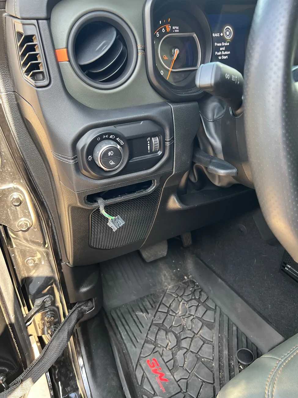

Trying to identify if I can put a factory bed outlet in… but can not find the pigtail needed to run to the switch inside. Does anyone have a picture of the plug and the wire colors? i found one plug taped up but it looks too big? Its a 25 Rubi.

Ok happy to report I found it… took panel below steering wheel off, just clips.. worked my way to unscrew headlight bezel..and removed, loosened speaker bolts and unclipped both electrical lines and gave me enough wiggle to pull her thru.. I did have to pop the top leather part of the dash to get at a few screws but all and all not too bad!!!
I hate you!
Just joking of course. If anybody knows the story, I had to take most of my dash apart to get to that wire! Ha! I'm glad you found it. I think having the wire means that you have the inverter which is required. Hit up Benny @AllMoparParts.com for the complete kit. It's a fun install. One out of three wrenches. Blow off the area under the bed before you start. Lots of hidden dirt up there falling in your face otherwise. A good trim tool set helps too. Lots of plastic clamps on the wire harness. Have fun!

Yea having a 24+ it sure was easy compared to what you pre 24 guys went through… I did hit Benny up for the parts!
