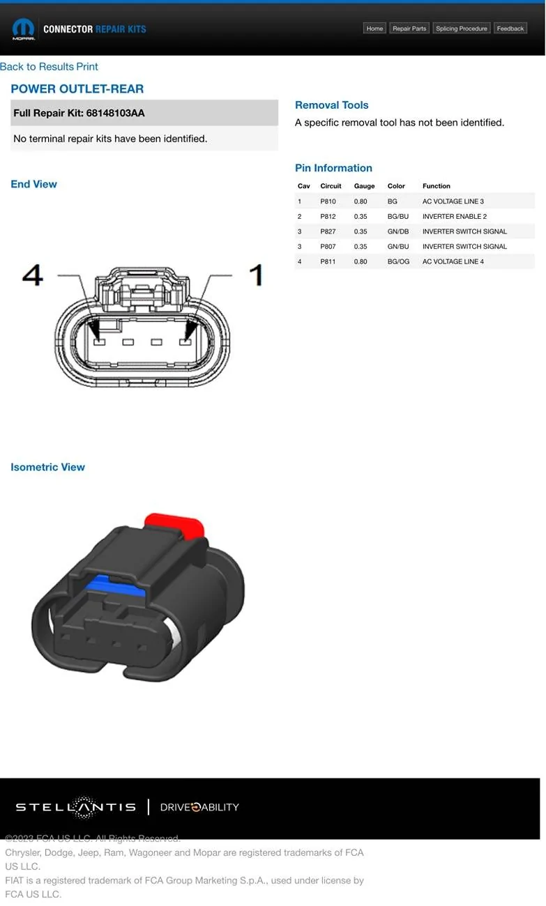

So I have my inverter set-up and it works all that is good.
I want to use the oem bed outlet and just wire it up to a cord I can plug into the inverter.
I already have the outlet and the connector so all I have to do is wire it, but I’m struggling to figure out how the ground pin functions in the outlet itself.
Jeep Gladiator Outlet Wiring Help Please IMG_9567
I poked around testing the wires and the load and neutral wires are there, but ground is not. I would think mopar wouldnt give the 3 prongs on the outlet if the ground wasn’t there.
So I guess I’m curious if others just connected the load and neutral and called it a day or if the inverter enable has something to do with this.
I know others have wired up the OEM outlet to their own inverters, but no one explains how they actually wired it.
The center console plug has a ground so I’m just confused why the bed outlet wouldn’t.
Also I would open the outlet to figure it out but unlike the center console outlet the bed one is completely sealed, which makes sense since it could come into contact with water, but it’s still annoying.

Just speculating here, so do test this theory . . .
Is it possible that the 120V ground is tied to the chassis ground? You can confirm that with a simple ohm meter. If so, then is seems reasonable that you could tie the remote outlet's ground to the chassis ground to secure the ground plane.
If anyone has this already set up, they could check for continuity to ground from the remote and confirm this is the standard.
Just an idea

I would get a meter and check with the engine running, and with everything off. The neutral and ground are possibly tied together inside the inverter. The ground in the outlet may not be connected to anything. The 120v wiring should be isolated from the 12v, but it is possible that the neutral in the inverter is tied to the frame ground.
