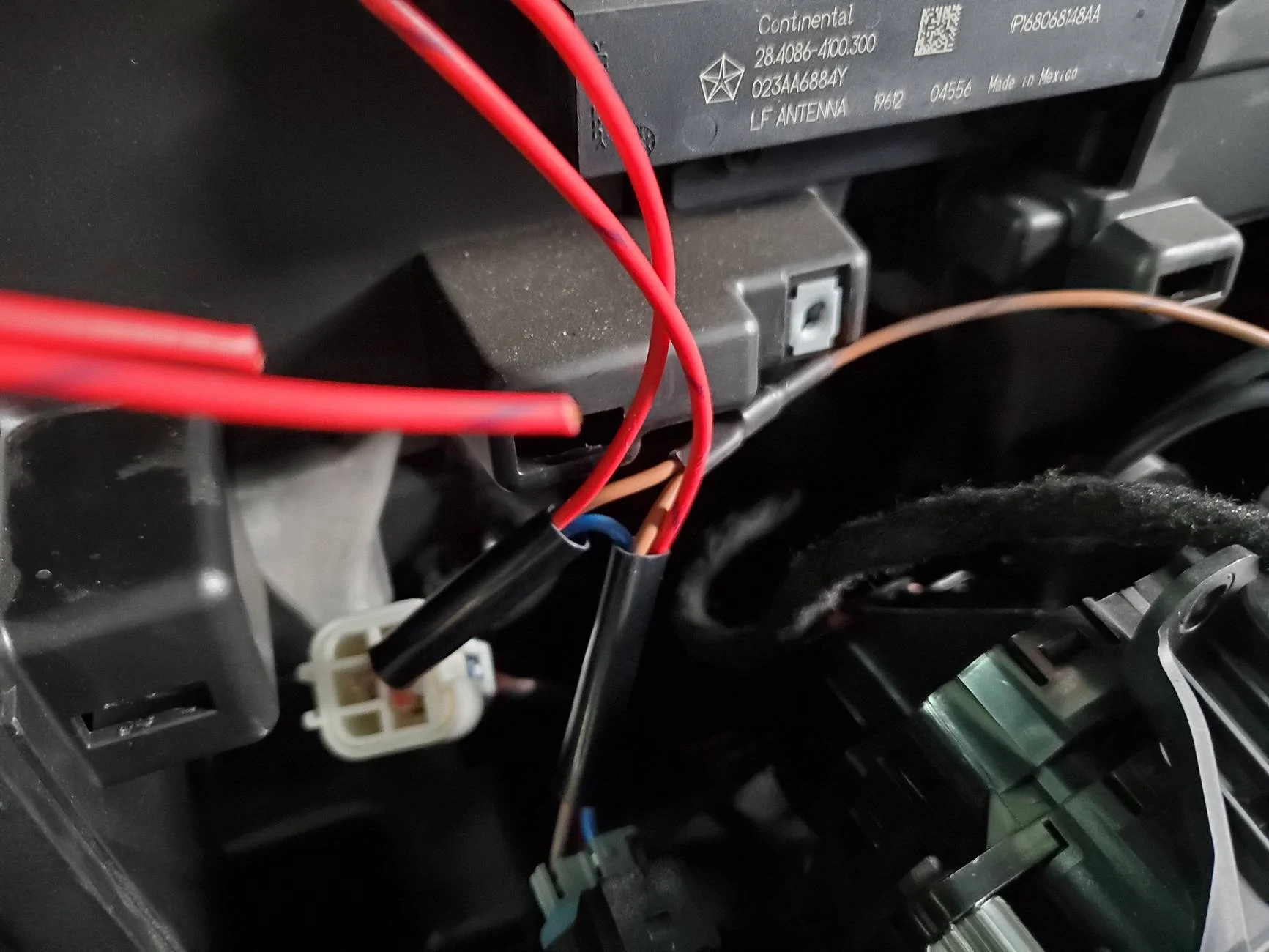

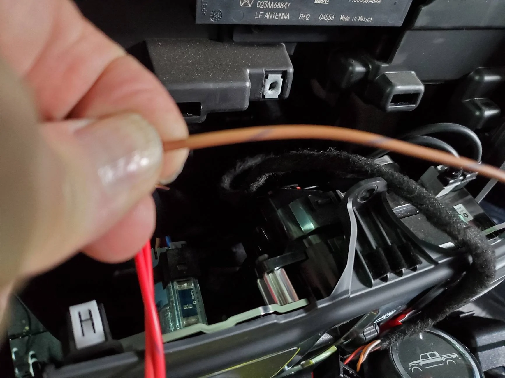

Back from the dead..I bought a used MTX575 and it came with a 12v power tap but fuse was cut out I think.. so the 2 red wires are 12v+ and need? to have a fuse connected to them and add a 12v+ out to the 575. The orange? with blue ? tracer is a negative.
Then tie to the +/- that came with the 575 and then the ring terminal to a good ground.
Any help would be appreciated.

l could forget the fuse just tie the 2 red wires together with a female spade connector and plug the + lead to the 575 into it. Safe off the harness ground and tie the ring ground to the dash aluminum frame. ???
