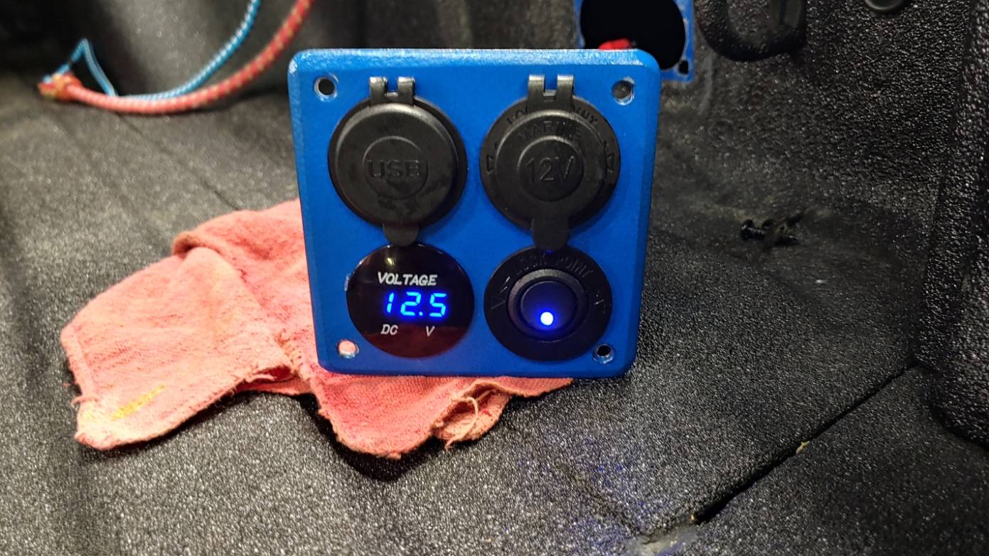

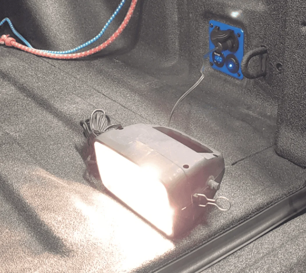

You can buy them with a panel, but the panel has a lot of wasted space between the outlets and so on, so I made my own panel putting the outlets and switch and volt meter closer together.
I crimped the ends on the wire I used, and use dielectric compound/grease on all connections. Usually doesn't even get wet up there, just really dusty.
Had to trim the truck bed a bit because even spaced really close together in my own panel, the hole in the truck bed wasn't quite enough.
Figure your largest load, figure the wire size and be generous - not conservative on choosing wire. If it's on the edge of one gauge with your amperage draw, go up a gauge.
I can't see anyone using 2 12v outlets as that sort of draw if using them at the same time would require some hefty wire. I just did one. Two USB charging ports in one terminal. The switch isn't really necessary if you run through one of the aux switches or some other type switch. I didn't want a wire back there with 12 volts and the amperage capacity live all the time so went through aux 2. I did want a volt meter so I could see at a glance if I was sucking too much from the truck batteries.
I made the panel from acrylic, didn't do a great job as you can see - it's really amateurish, especially the bevel on the upper left, that sucks. I used a textured paint, then blue over that, to give it a finish that sort of goes along with the rough bed liner.

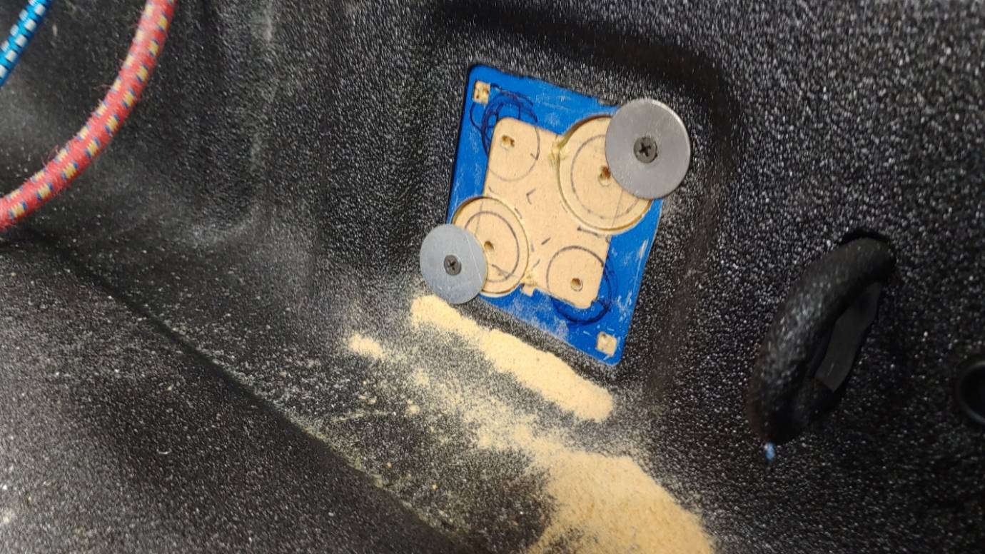

Jeep Gladiator Bed outlet 20220820_153408_HDR

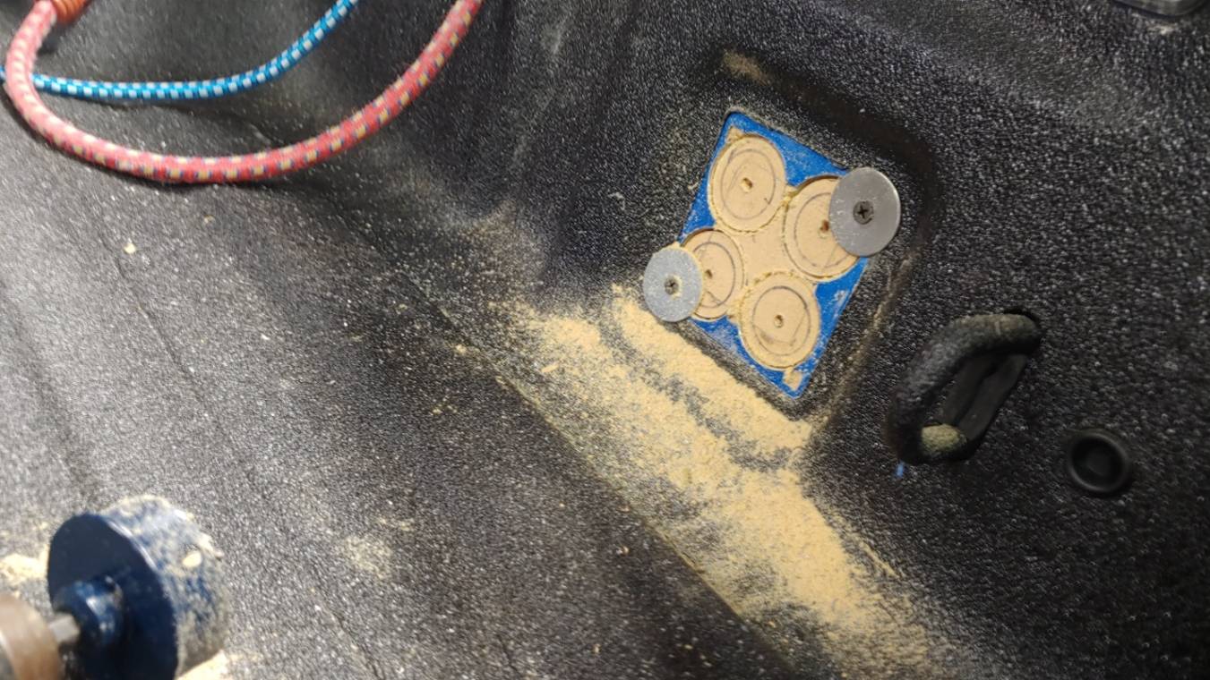

I made my panel, then transferred the device spacing to a wood block, drilled pilot holes to guide a hole saw. I secured the block to the bed, used a hole saw to cut the truck bed to clear the electric outlets, volt meter, etc.
If I trade or sell, I can still pop the factory block/cover back over the hole after removing my electronics. May have to glue it in place - oh, well.
Jeep Gladiator Bed outlet 20220819_111713
Jeep Gladiator Bed outlet 20220819_111813
Jeep Gladiator Bed outlet 20220819_151408

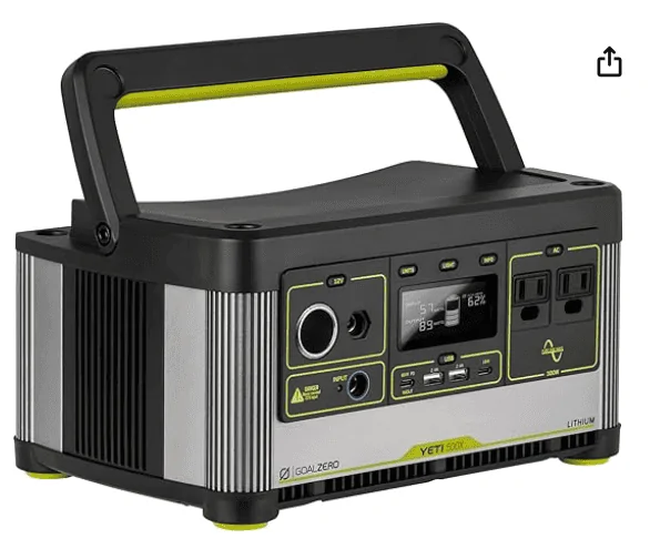

The 12v outlet can be used to charge many different power supplies. Or in my case, used for a light, cooler, whatever. The USB ports charge my phone and hearing aids while I sleep in the back of the truck with a truck tent.
Charge one of these while you drive, or couple it with solar panels, as talked about in the solar panel thread several experienced people have commented on........
Jeep Gladiator Bed outlet 1695916637410
