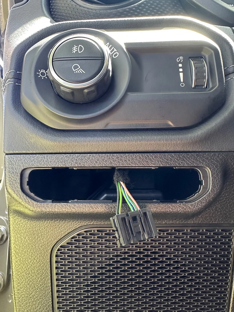

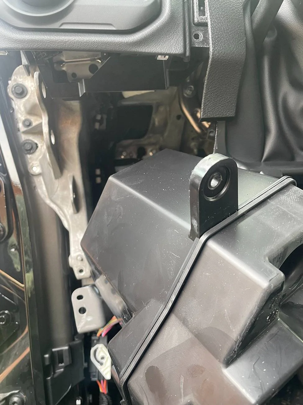

Found it!!! Only took 4 attempts. But had I seen that latest video prior to attempt #1, I would have been one and done.
Holy! What a nuisance!

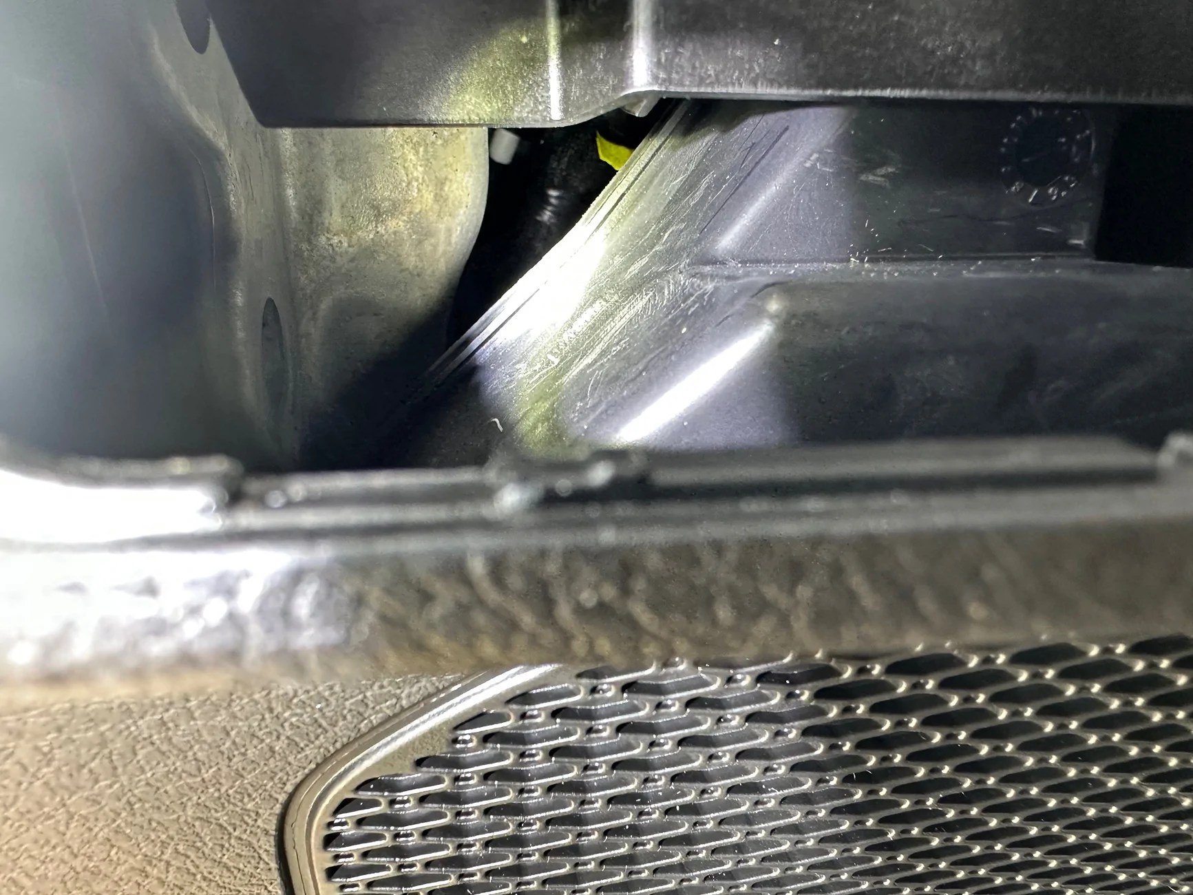

I used the latest video that was posted to help with getting the biggest panel off so that the speaker pod could come out and there it was tucked up behind it. Knowing where it was. I'm sure I could have found it without the disassembly. However, to route it through to where the switch is wouldn't have been possible.
Besides that ridiculous location, the placement of some of these screws is just as bad. 4 times taking them off and on, didn't make it any better. Crazy...
I also couldn't figure out how to reattach the center 7mm on that metal cross bar (see vid). I tore that plastic and metal up! Then just put it in wrong just so it was at least there with all the pieces.
I did check and of course the outlet isn't already activated. It seems like a pain to buy the Tazer, etc... just to turn that setting on. But most likely a whole lot cheaper than paying the dealership to do it. I'll be getting a quote from them tomorrow.

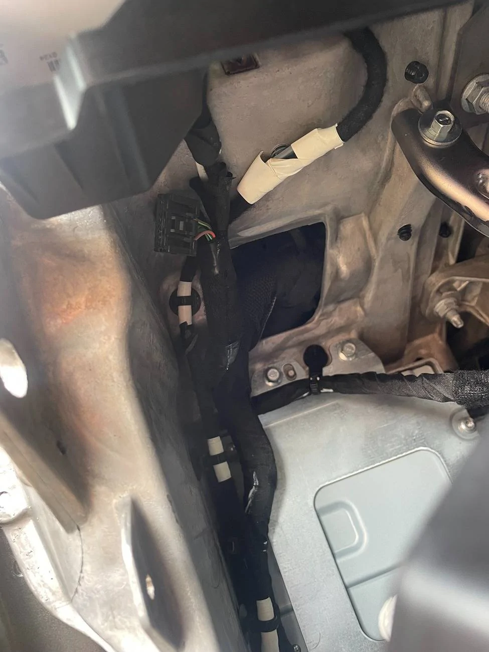

this was the money pic right here! on my 2025 Gladiator Rubicon X, I was able to pop the 115V switch plate out (rather than remove the panel). From left side of plate cutout, I shined a flashlight into the back of the void where I saw the electrical tape (2 separate spots were taped about 1-2 inch apart). I followed that wire up to upper right of void and saw the green wire, the connector was not visible. I used an xacto knife taped to a screw driver to cut the 2 pieces of electrical tape. I used a small fish hook on end of long screw driver to pull the connector down through the switch plate.
Jeep Gladiator 2024 Mojave X Add Bed 115v outlet IMG_6493
Jeep Gladiator 2024 Mojave X Add Bed 115v outlet IMG_6496

So just to confirm you just popped out the blank plug where the on-off switch would go. I also have a 2025 Rubi. Thanks in advance
Some can and some can't. It depends on how far back the wire is taped. It should be your first check though. Just follow the light switch wire it's taped to that.
Maybe I misunderstood you. The switch itself yes, you pop out a little blank panel and the switch pops right in.
The connector for that switch requires a bit of dash disassembly to retrieve the end it plugs into. There is a video (around page 6 or so Post 84) that shows dash disassembly and will be a big help for you. Read this thread carefully and you will have any and all information needed to install 110VAC in the bed of your truck.
