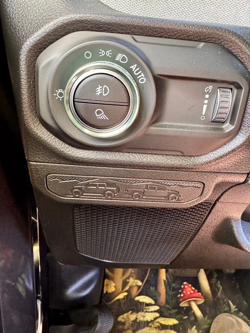

Thank you for confirming. I do have the factory inverter (115V) between the rear seats and there seems to be a neat little plastic “pop in” fascia piece right below my light switches where the 115V bed on/off switch would go which is intriguing.
I’ll DM you my VIN if that works? Thanks so much.
AllMoparParts.com
Summit Sponsor (Level 3)
Benny
Sep 16, 2019
1,821
1,185
New York
JT's!
Yes I will await your VIN
Cattywumpuss
Paul
Feb 13, 2026
287
371
Anchorage, AK
2026 Jeep Gladiator Sport S
Thanks so much, I’ll send it in a minute or two.

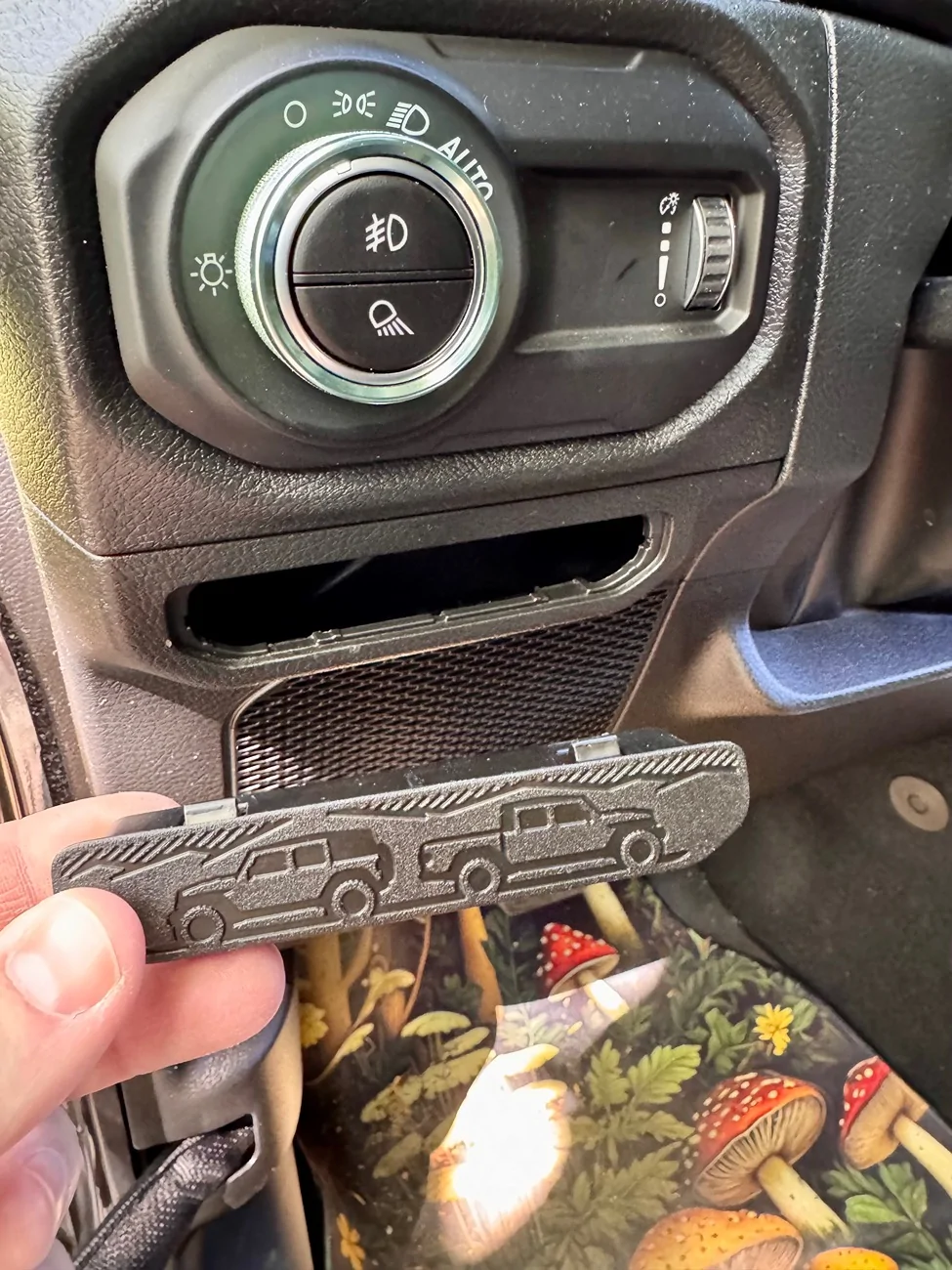

On an interesting side note that pre-installed bed power outlet “switch panel” I was talking about seems to be legit. Either that or it’s a portal to another dimension! 🤣
Jeep Gladiator 2024 Mojave X Add Bed 115v outlet IMG_9868
It comes off:
Jeep Gladiator 2024 Mojave X Add Bed 115v outlet IMG_9869
So this really has me intrigued about putting in the 115V outlet in the bed now.

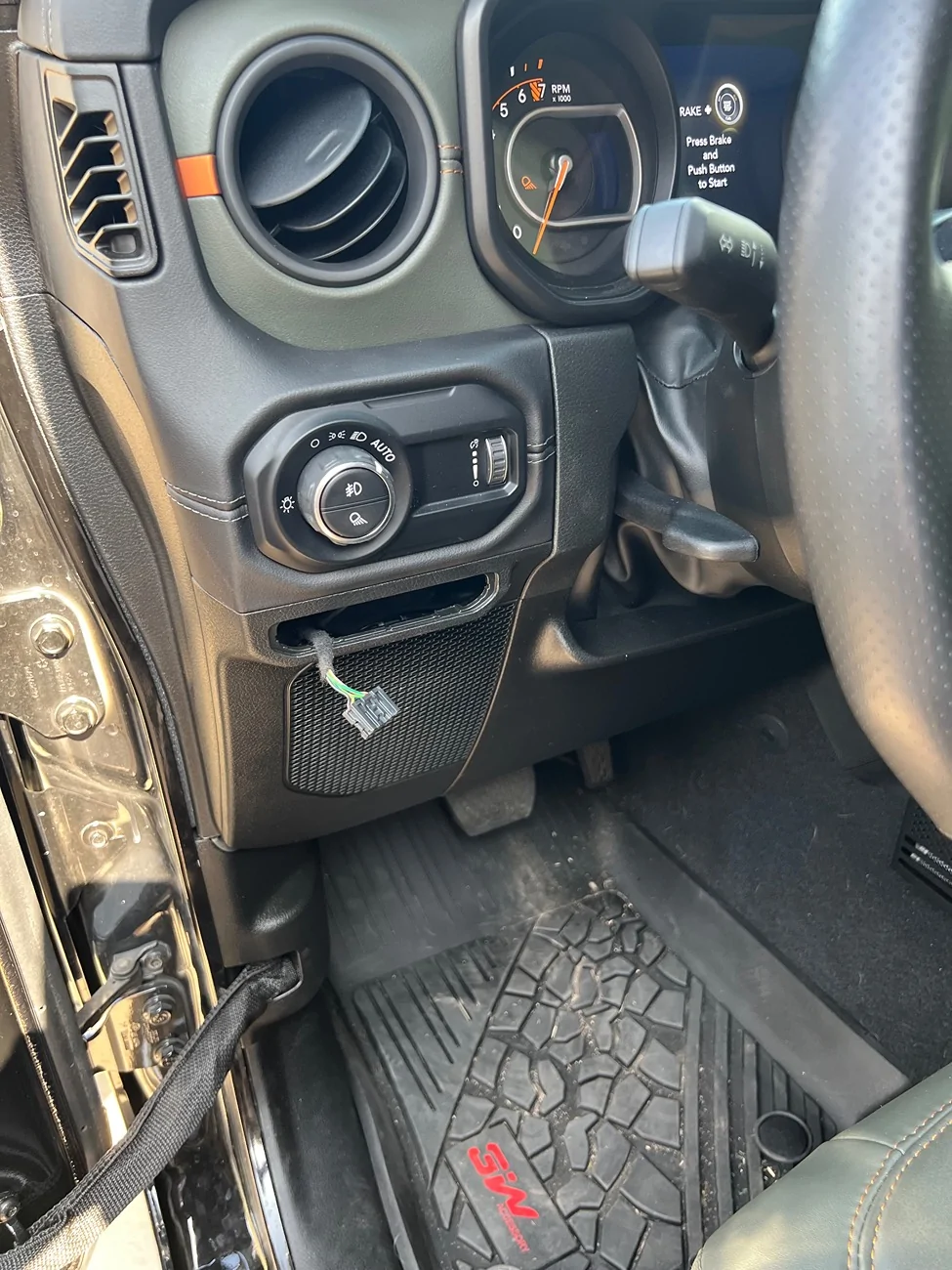

Yes, mine was buried behind the speaker. Lots of disassembly required.
Jeep Gladiator 2024 Mojave X Add Bed 115v outlet 17805329666213901958835913921515
YGBSM
Oct 29, 2024
712
1,714
Oklahoma City
2025 Rubicon 392, 2024 2-door Rubicon X, 2024 Mojave X
I fly da plane...

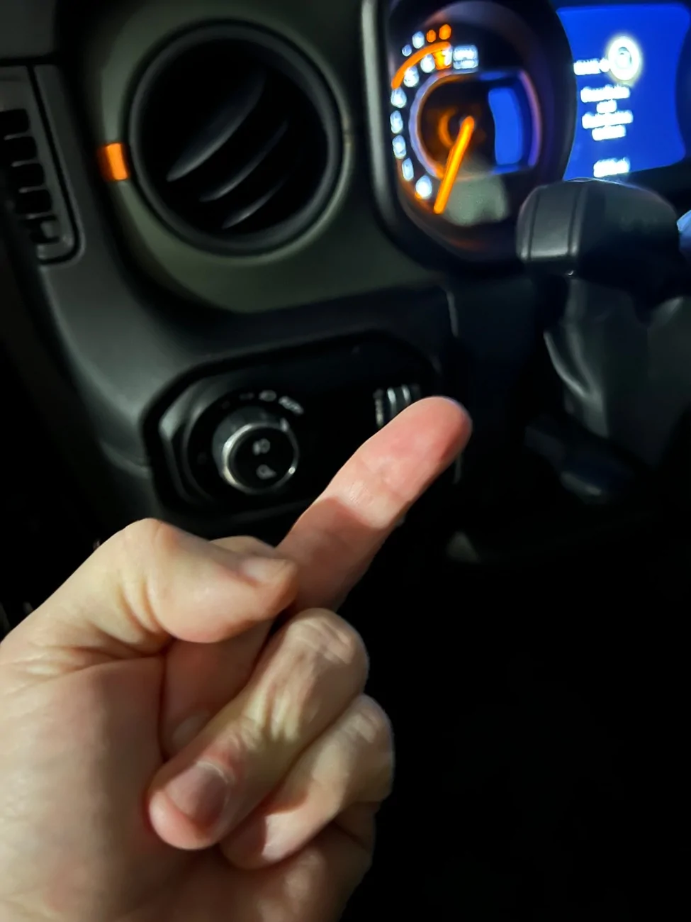

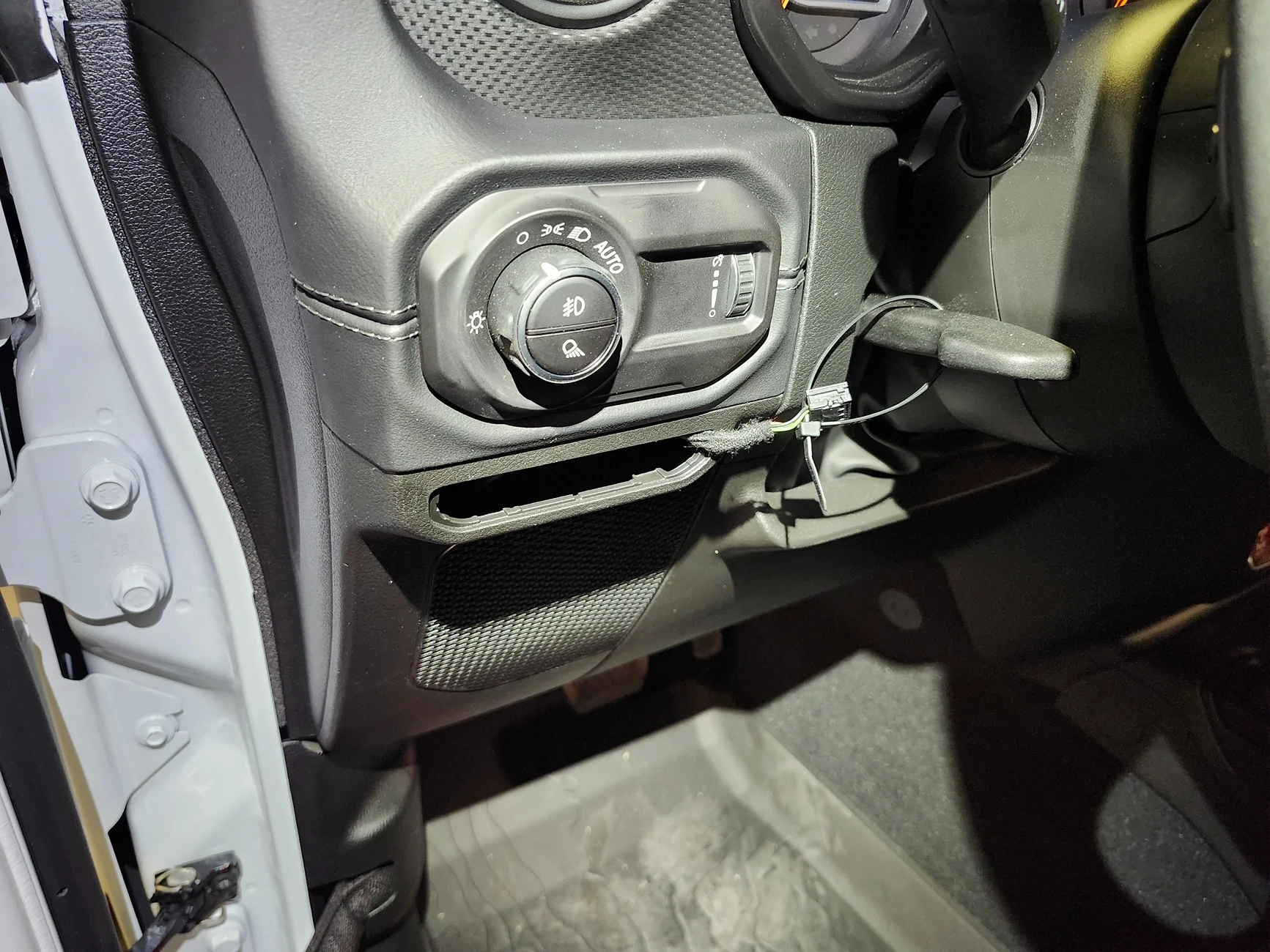

Legend has it that you can still hear my curse words echoing if you open the light switch panel on my Gladiator...
Jeep Gladiator 2024 Mojave X Add Bed 115v outlet IMG_2385
Jeep Gladiator 2024 Mojave X Add Bed 115v outlet IMG_1979
