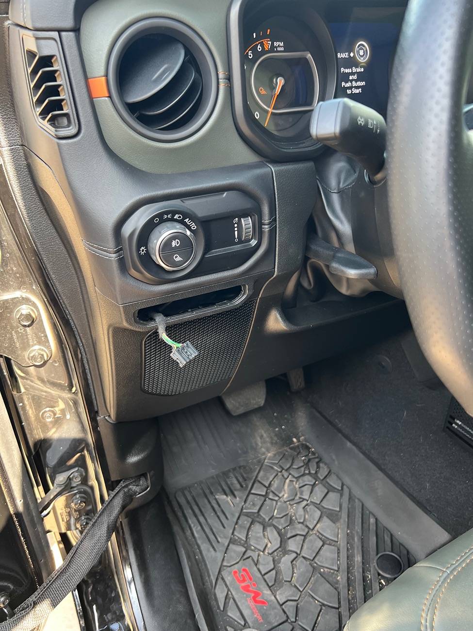

My kit is on the way from Benny. But I may just keep it like this. It reminds me that I was victorious over a small plug.
Dont forget to give it a little tug when you get in and out of the car just to make sure it aint going nowhere
- Benny
If it slips behind the dash you'll know. Because I'll be ordering an entire dash from you! 😂

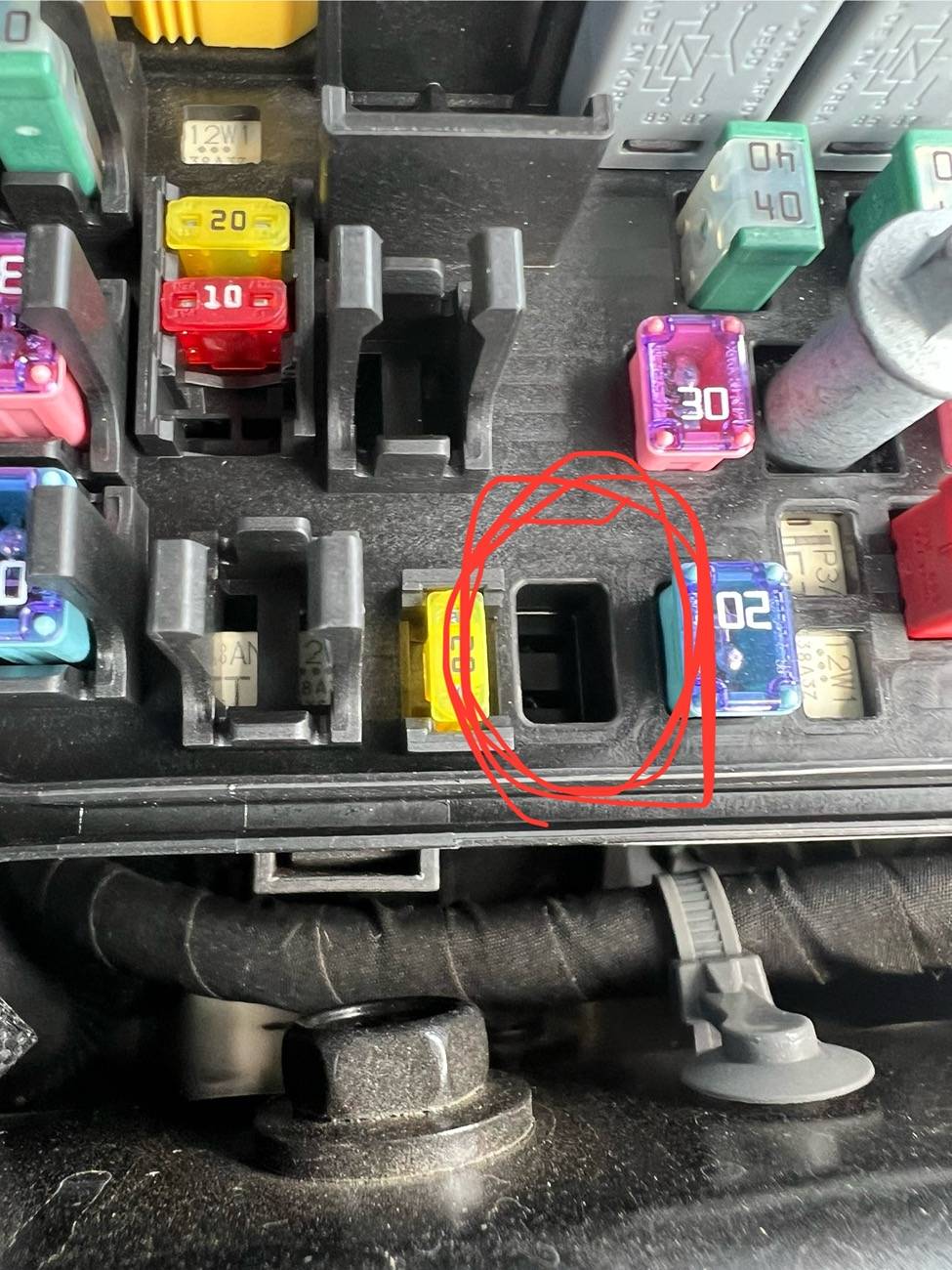

Annnnd the saga continues…..
I found the switch plug after a long fight with the dash. Got the kit, thanks Benny @AllMoparParts.com, installed it, and now I’m at the dealership and they can’t activate it because there’s something missing in the TSP???
They do have a 2025 on the lot with the outlet…. So a $250 job may be a $20,000 job. 😂

The dealership tech said the the instructions told him to inspect a fuse that isn’t there. Does anyone else with an inverter have this fuse?

heretic
steve
Jan 2, 2025
145
104
florida
2024 JT Rubicon X
take a pic of the known working '25 fuse box please. others may be in the same boat.
OK my 24 has the inverter in the cab it works, but I too do not have "that" Fues as well????

Kevin,
I dont have the PDC fuse schematic but lets look for fuse F110
Same here. My inverter works and my 115v outlet in the cab has power but the dealership can't get the code to take.

I'd Like to add here that I reviewed Kevin's VIN and the sales code that I believe is required is not available to "select" within Mopar's service system. This means Dealer programming is not an option however 3rd party programming via Tazer, Jscan or Alfa OBD will be the solution.
- Benny
Thanks Benny! As always you've come through for us! Have a great weekend.

Interested to see how any programer can over come the fuse not being there?
I am wondering also. 2024+ seems to be a little different wiring wise also for this system.
