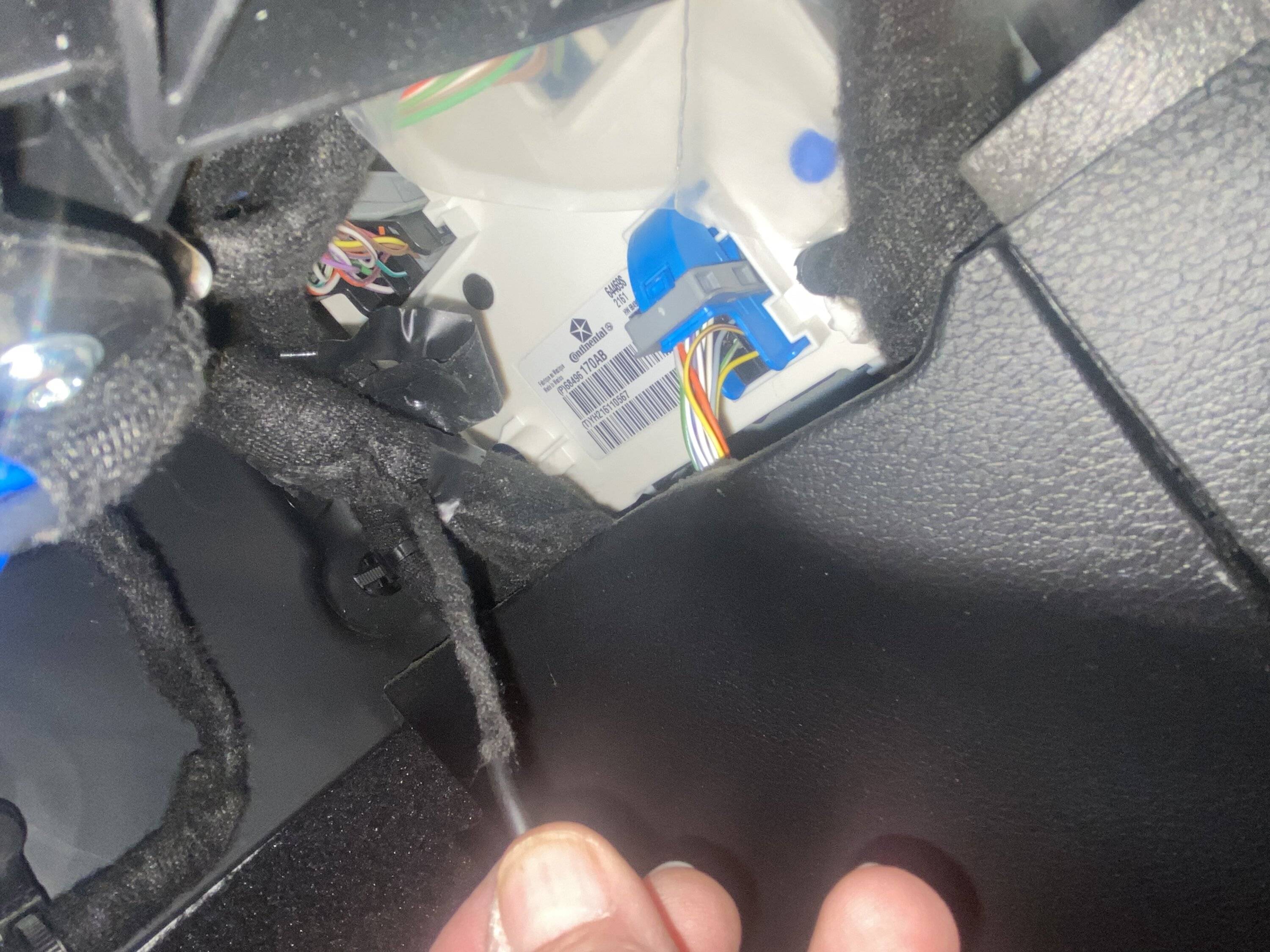

So, in looking for the aux wires, I found a single wire coming out of the harness on the kick panel side. Anybody know what this is?
Jeep Gladiator Missing interior Aux switch wiring (solved) 4CF2AC26-E938-4122-AC21-6CE802EA62BC
JTR178
Apr 27, 2021
479
845
Goose Creek, SC
2020 Rubicon
5-0
Either the battery or ignition power wire.
