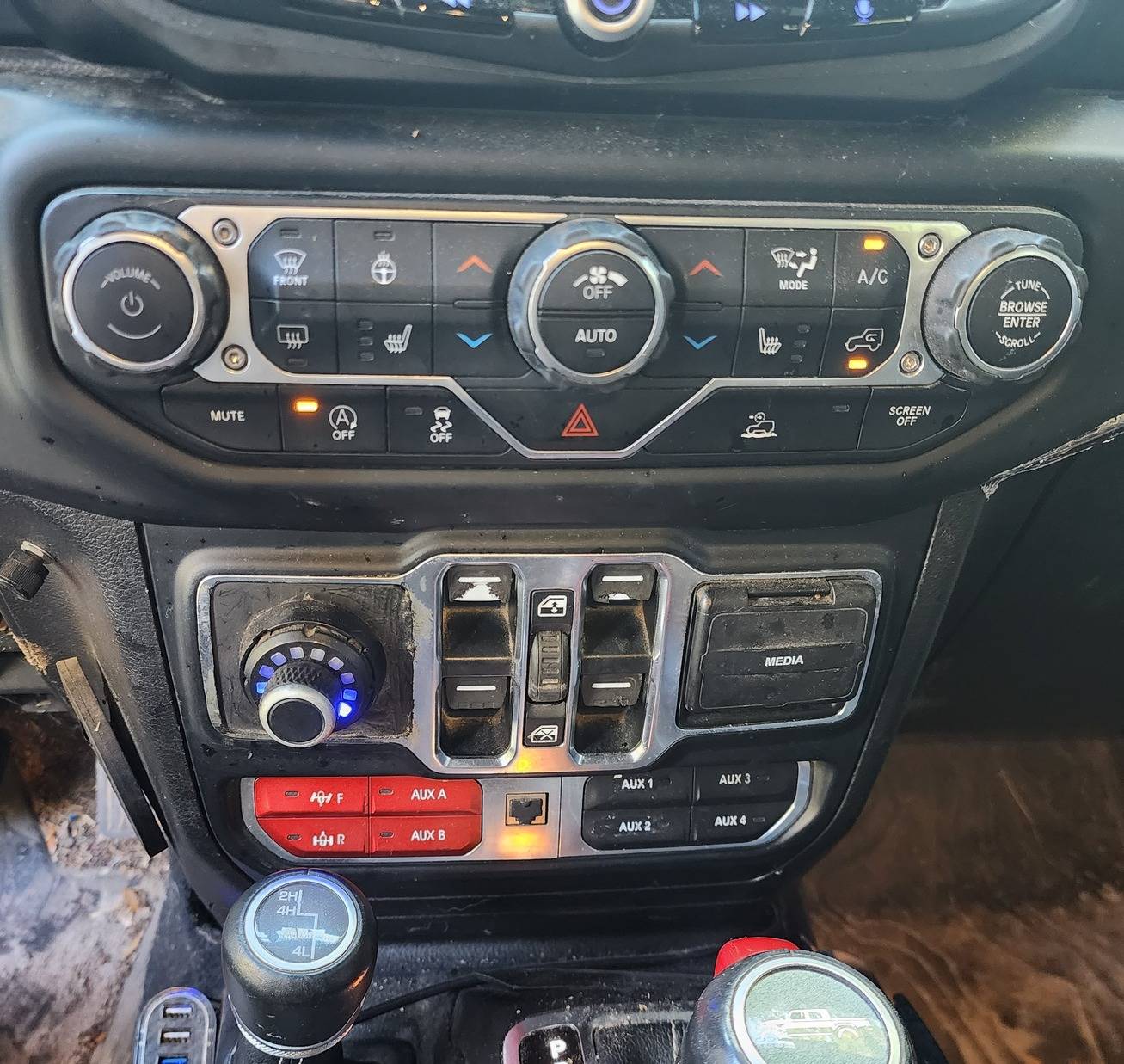

Ok so I searched and did not find anything specific to this question here in the forum, and yes I might have still missed it... Google and all the wonderful AI nonsense wasn't any help either.
Simple question(s).
If you do not have the factory 4 button switch panel, is the factory wiring behind the panel in place to add one?
I know you'd still have to program it but can you buy a Mopar OEM switch panel and connect to factory wiring?
E.g. did FCA put the wires in place for it even though the panel is not there?
Hopefully I've made the question clear enough 😂.
Also, if anyone knows, is the wiring in place for the factory bed power plugs? Essentially same type of question just for another location.
Appreciate any assistance.

No, wiring is not already there. You will have to buy the mopar kit that includes the switch panel plus wiring harness and run it yourself. Worst part is getting the harness through the firewall into the cab but overall it’s a pretty straightforward process. There’s some reconfiguring of pins to tie in the new harness properly to existing connectors that is a bit tricky so you’ll want to do some homework there if you plan to tackle it yourself. I do not know about the bed power plugs.

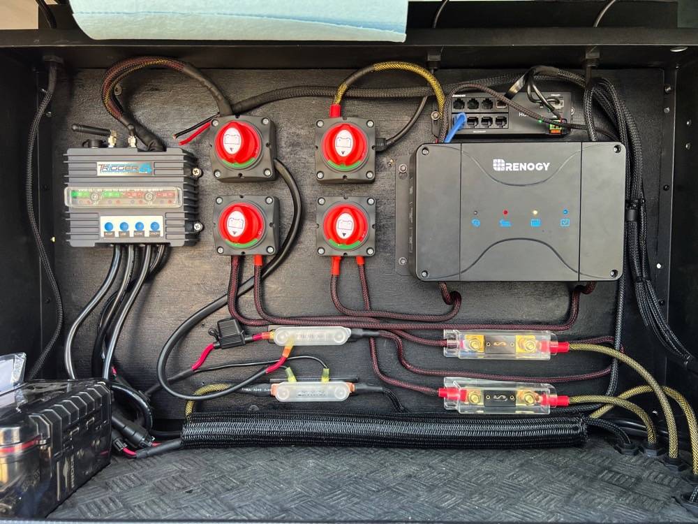

I actually use one of these to control the House loads in the back of my Jeep:
Jeep Gladiator Aux Wiring with no factory Switch Panel 15_HouseElectricalPanel_1

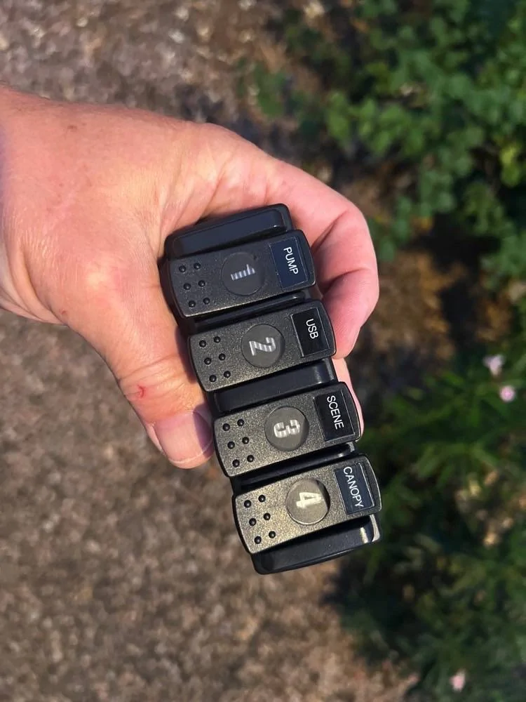

What I really like about it is that you can control it locally with the buttons on the front of the panel, or with the RF remote it comes with:
Jeep Gladiator Aux Wiring with no factory Switch Panel 17_HouseLoadRemot

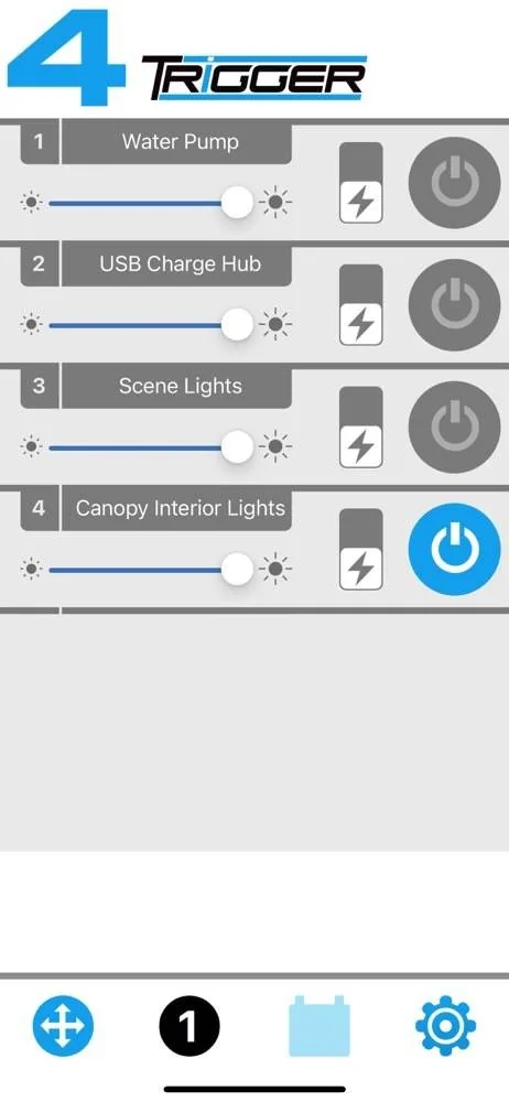

Or with an app on your phone:
Jeep Gladiator Aux Wiring with no factory Switch Panel 18TriggerPhoneA

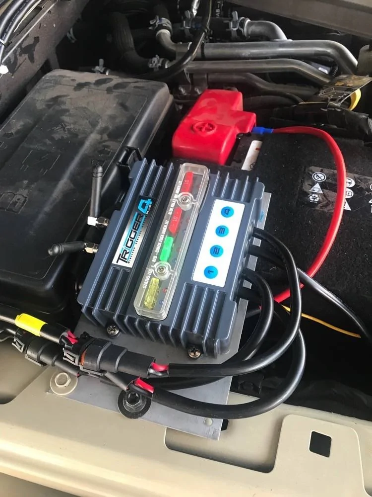

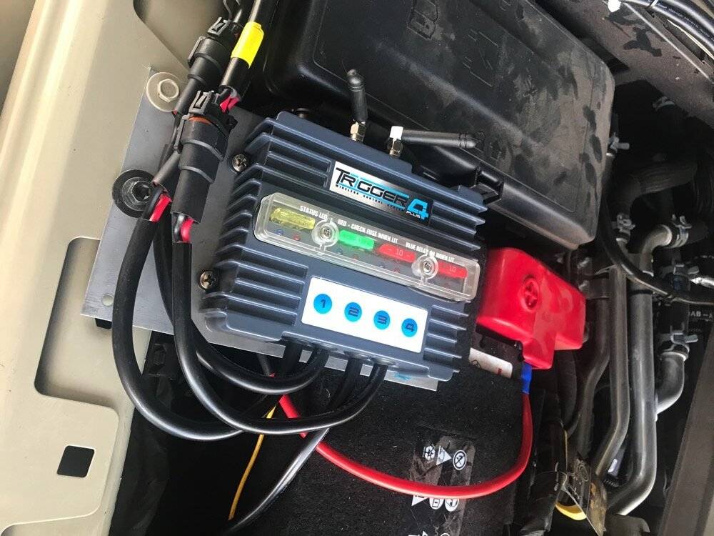

Before I had it mounted in my "electrical cabinet", I had it mounted under the hood. They sell a nice bracket for this mounting. I currently have one mounted under the hood of my 2016 JKUR to control it's accessories.
Jeep Gladiator Aux Wiring with no factory Switch Panel IMG_1633
