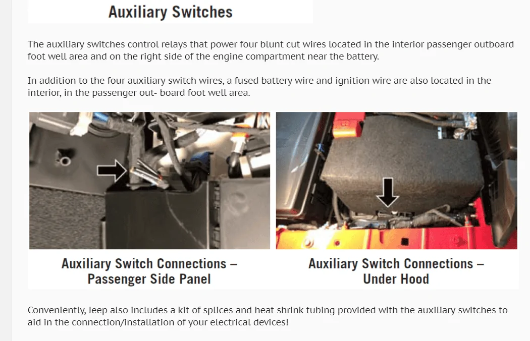

Hmm, trying to figure out how to wire these to my winch...I'm thinking one switch set to toggle winch power on/off and two others set to momentary to reel it in and out. I'd do just two momentary switches but I wouldn't want them to get hit accidentally. I'm thinking switch 1 turns on a large solenoid (like starter) on the winch power cable and have switch 3 and 4 be momentary and run directly to the solenoid box, 3 reels in, 4 reels out. That or have switch 1 control two small relays that 3 and 4 run into (which then go into the solenoid box), that way I don't have to turn the winch on in the cabin to use the external control.
That only leaves one other aux switch, but I don't really have any other power accessories I need to switch that I plan to use right now.
I don’t think you want to only be able to control the winch from inside. Just use one switch for power to the winch, and use a direct attach control, or wireless remote, to operate the winch.
Bobzdar
Apr 3, 2019
523
641
Richmond
2020 Gladiator Rubicon, 1989 grand wagoneer
I want both - so I only have to get the remote control out if I need to winch from outside the vehicle, otherwise I can use the dash buttons for control as I'd say 80-90% of the times I've had to winch I've been inside the vehicle. I just don't want the dash buttons always enabled, hence using a 3rd for enabling the winch. I'm now thinking I can use the 3rd button for power to the solenoid box, so I'd have to always turn it on whether using the remote or in-cab controls, but it would be the most simple to wire up and not require any extra relays or solenoids. Just disconnect the relay power from the main winch power line and run a wire from the aux switch to it instead.

Can anyone help with this idea: I would like to wire a radar detector to an aux switch and hide the wire behind the dash for a clean install rather than have the wire dangle down and plug into the cigarette lighter. I have no idea how many wires I will find when I cut the radar cord or how to make the connections. Thanks in advance.
Tortooga Custom Works
Ralph
Nov 29, 2018
80
1,704
1,623
Central NJ
Could you do what you are planning? Yea, sure.... but, this was a good setup: https://www.jeepgladiatorforum.com/...-on-the-jt-to-connect-a-radar-detector.17818/

I found the wires under the dash on the passenger side. I have the cable to connect my dash cam. I am wondering where I would find a place for my ground wire?
There are grounding points behind the passenger’s kickboard.

is that wiring harness available on all JL's even without the switchgroup?
