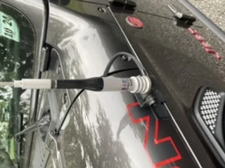

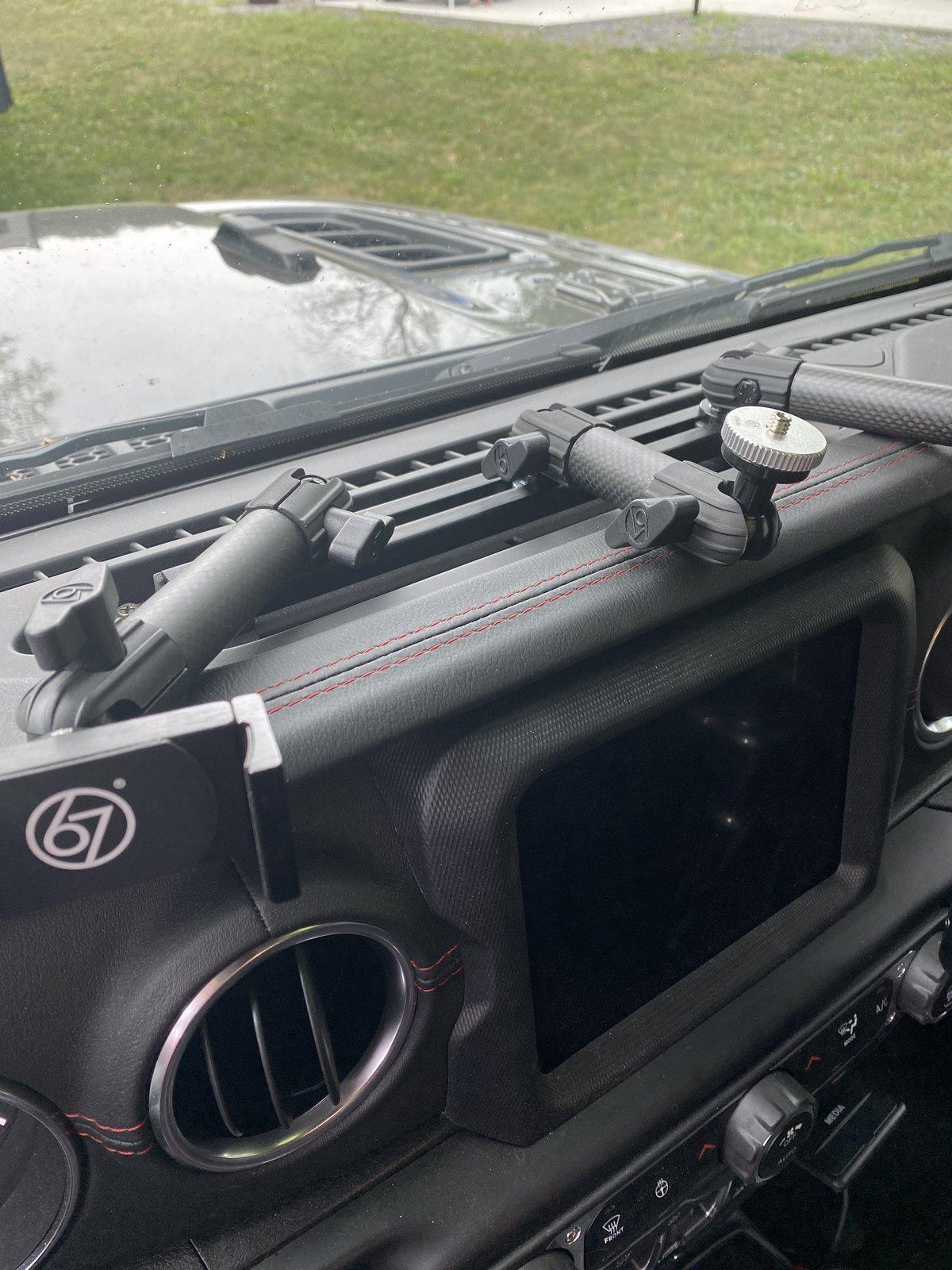

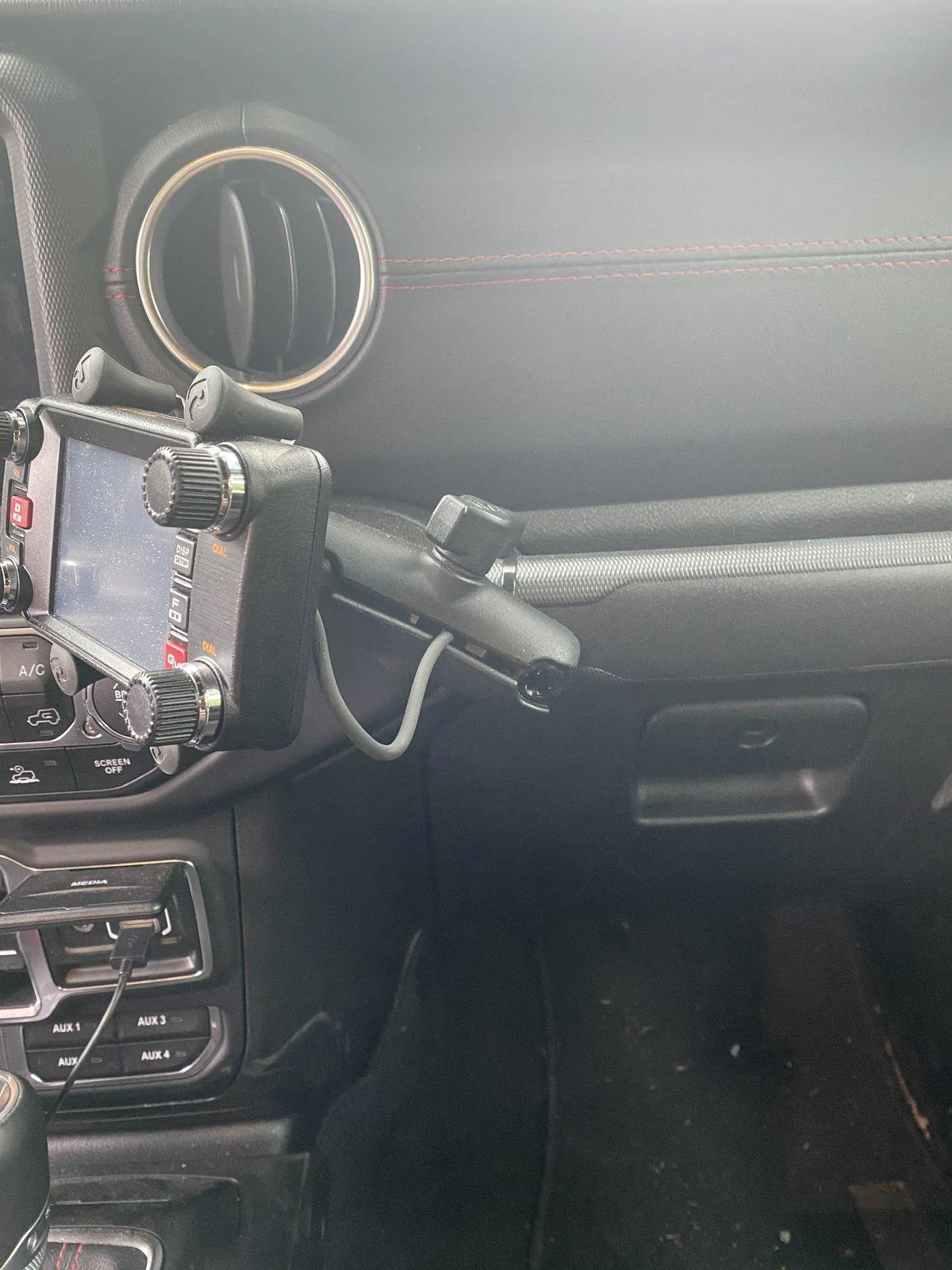

I mounted it in the glove box and used the power leads and ground point that are inside the cab passenger foot well. The antenna is a Diamond SG7500 and is mounted on the driver side on the hood with a Diamond K400 body mount. The control unit is temporarily mounted on a RAM phone mount siting on a Carolina Metal Masters grab bar ball mount. I have a 67designs rail that I intend to move this to eventually, but the 1/4” camera mount from them is a larger bolt than is at the back of the Yaesu control unit.

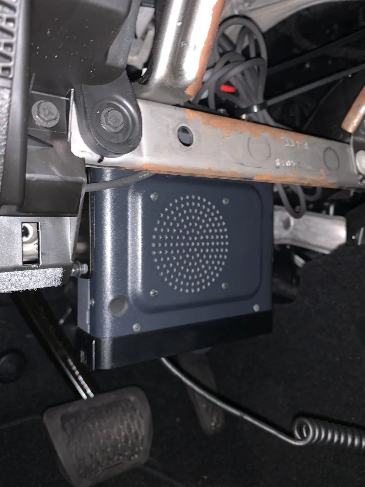

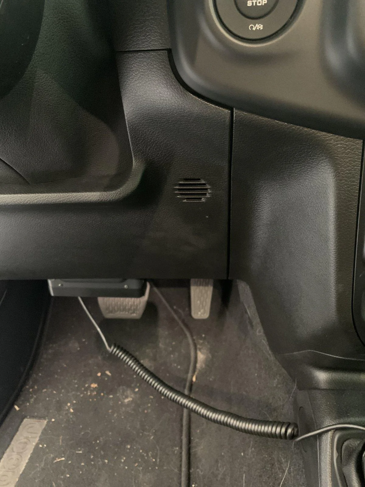

Nice! I mounted my FTM-100 behind the panel directly beneath the steering wheel. The pics makes it look like it hands down more than it does. At 6’-3” I can’t even see it while driving but it makes it easy to access the SD card.
I have the head unit on the a-pillar but I’m thinking of using the CMM Freedom Top Ram ball to keep it more out of the sun.
