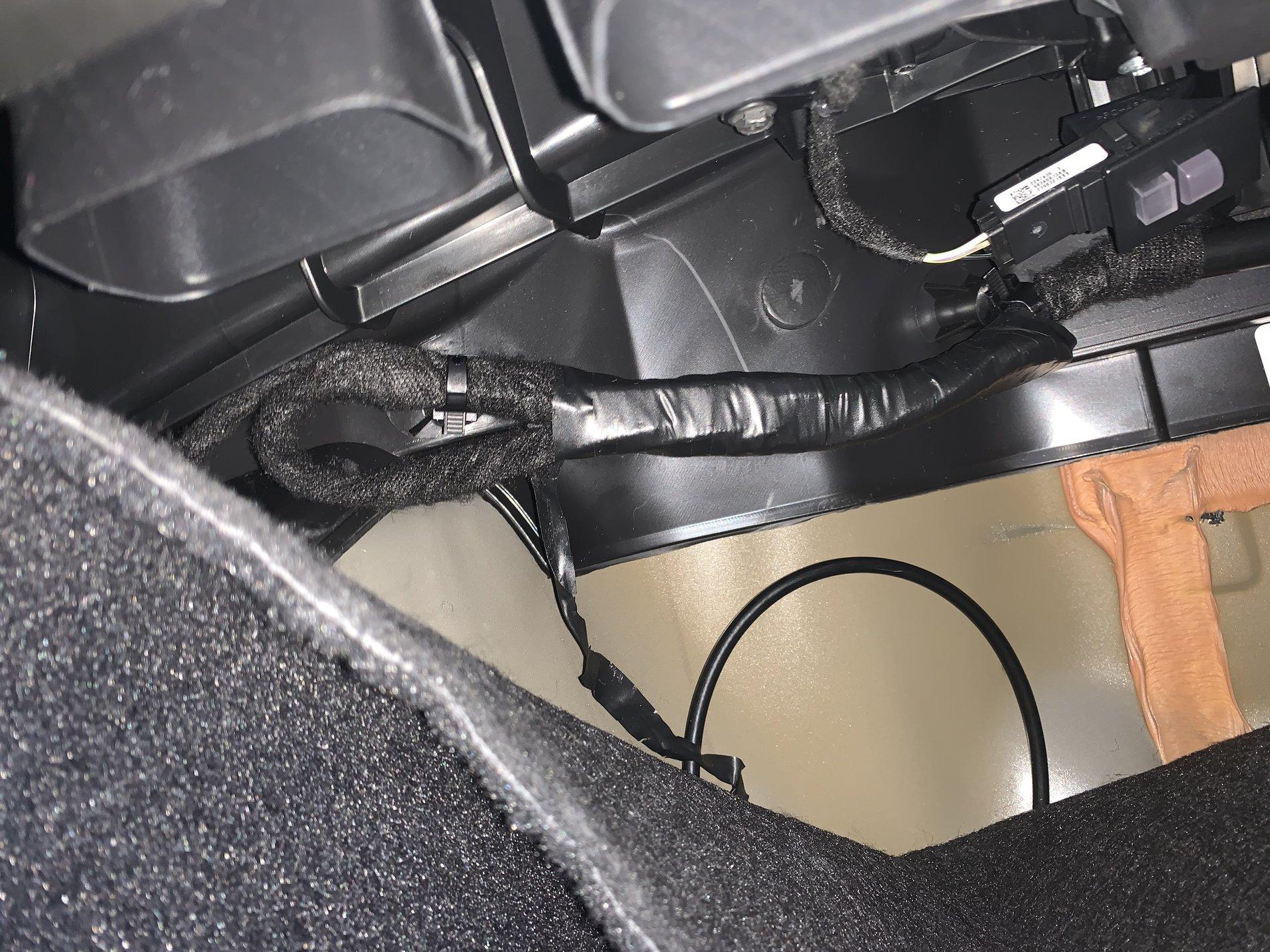

Pop off the lower right kick trim. The leads should be tucked under there.
The photo I attached had the kick panel completely removed I believe or maybe there is a different panel? Thanks for your help

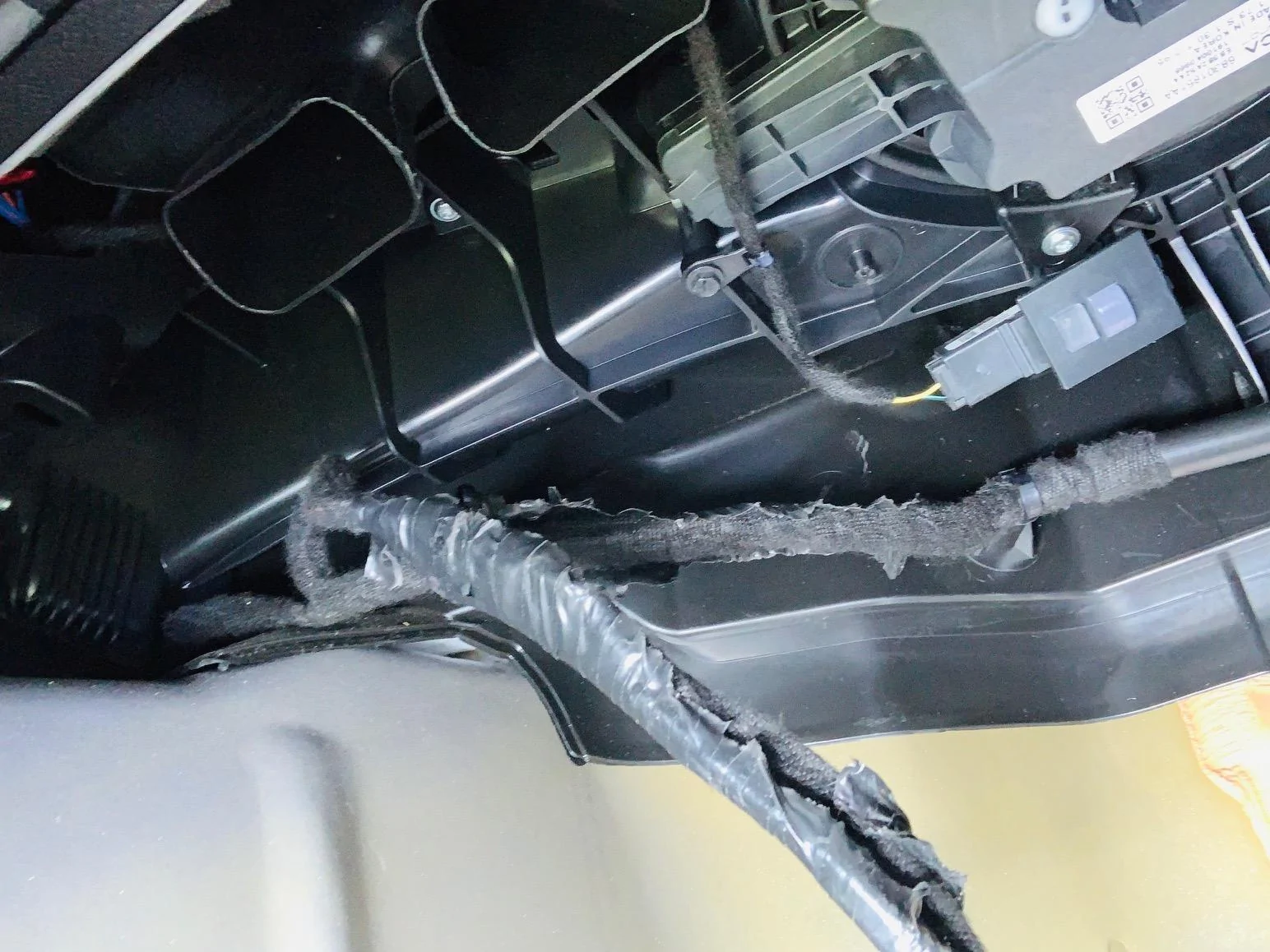

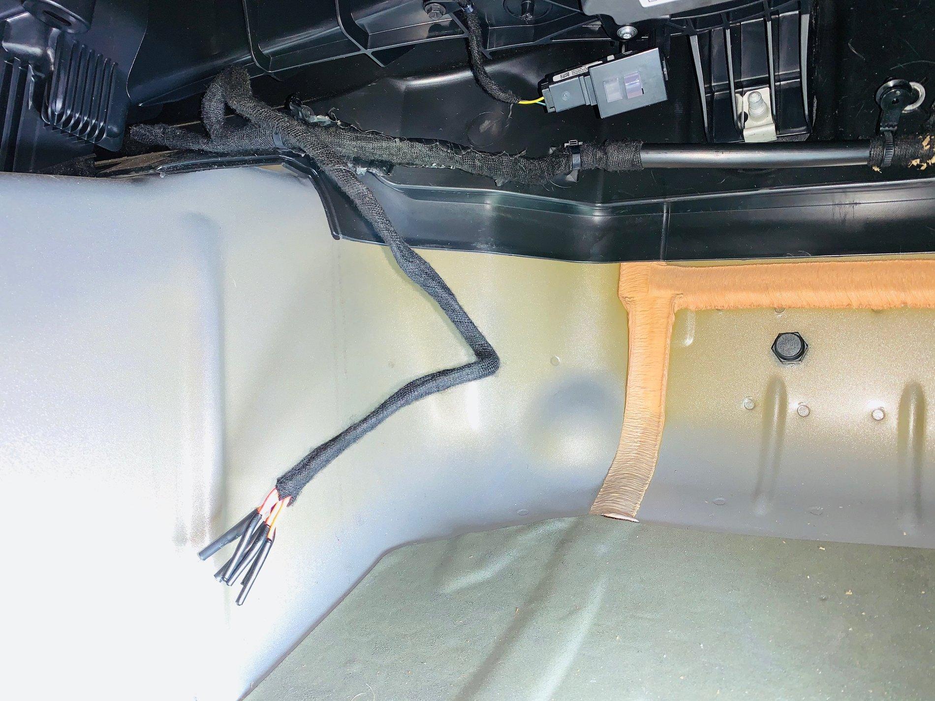

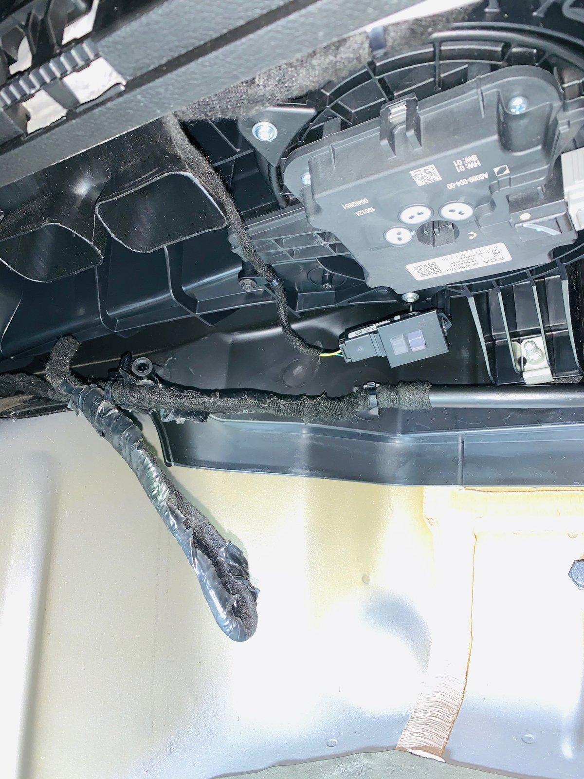

Cab Aux Switch wires located under glove box. Just throwing some words on here for searches. Heck of a day finding these today. Glad I gave up on the rubber grommet on passenger side. If I get static on CB I will revisit a more direct line to BAT POS. Great Jeep but designers did not leave us many choices through the firewall on passenger side.
Aux Switch Wires Interior Passenger Side
Jeep Gladiator 4 Programmable Auxiliary Switches Aux 3
Jeep Gladiator 4 Programmable Auxiliary Switches Aux 2
Jeep Gladiator 4 Programmable Auxiliary Switches Aux 1
