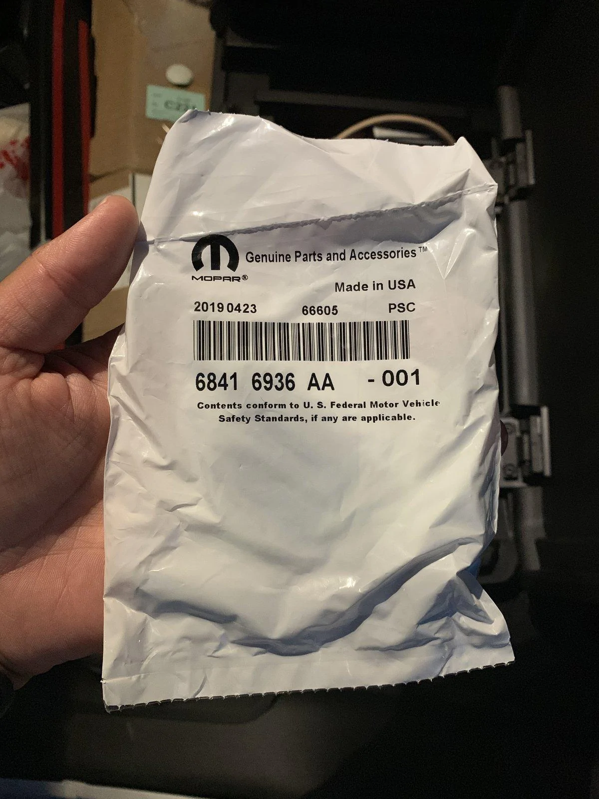

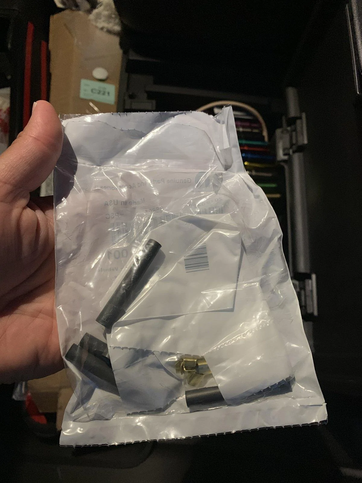

Where is the kit of splices and shrink tube to be found??? I've been looking.......
Tortooga Custom Works
Ralph
Nov 29, 2018
80
1,704
1,619
Central NJ
We're talking about the wire splice kit that comes with the aux. switch option.
Unfortunately, my truck has the switches but not the splice kit swag booty.
I don't think I even noticed a splice kit... I'll have to look again. What is it supposed to contain exactly?
Rokon
Bob
Jun 18, 2019
480
703
Maine
Gladiator Rubicon
Butt splices and heat shrink tubing. Probably a small plastic bag.

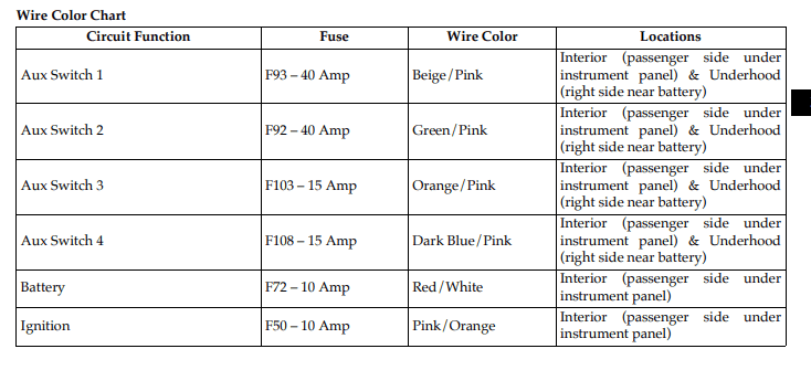

Hmm, trying to figure out how to wire these to my winch...I'm thinking one switch set to toggle winch power on/off and two others set to momentary to reel it in and out. I'd do just two momentary switches but I wouldn't want them to get hit accidentally. I'm thinking switch 1 turns on a large solenoid (like starter) on the winch power cable and have switch 3 and 4 be momentary and run directly to the solenoid box, 3 reels in, 4 reels out. That or have switch 1 control two small relays that 3 and 4 run into (which then go into the solenoid box), that way I don't have to turn the winch on in the cabin to use the external control.
That only leaves one other aux switch, but I don't really have any other power accessories I need to switch that I plan to use right now.
