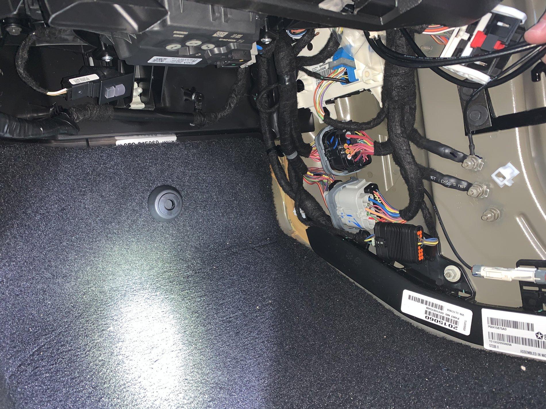

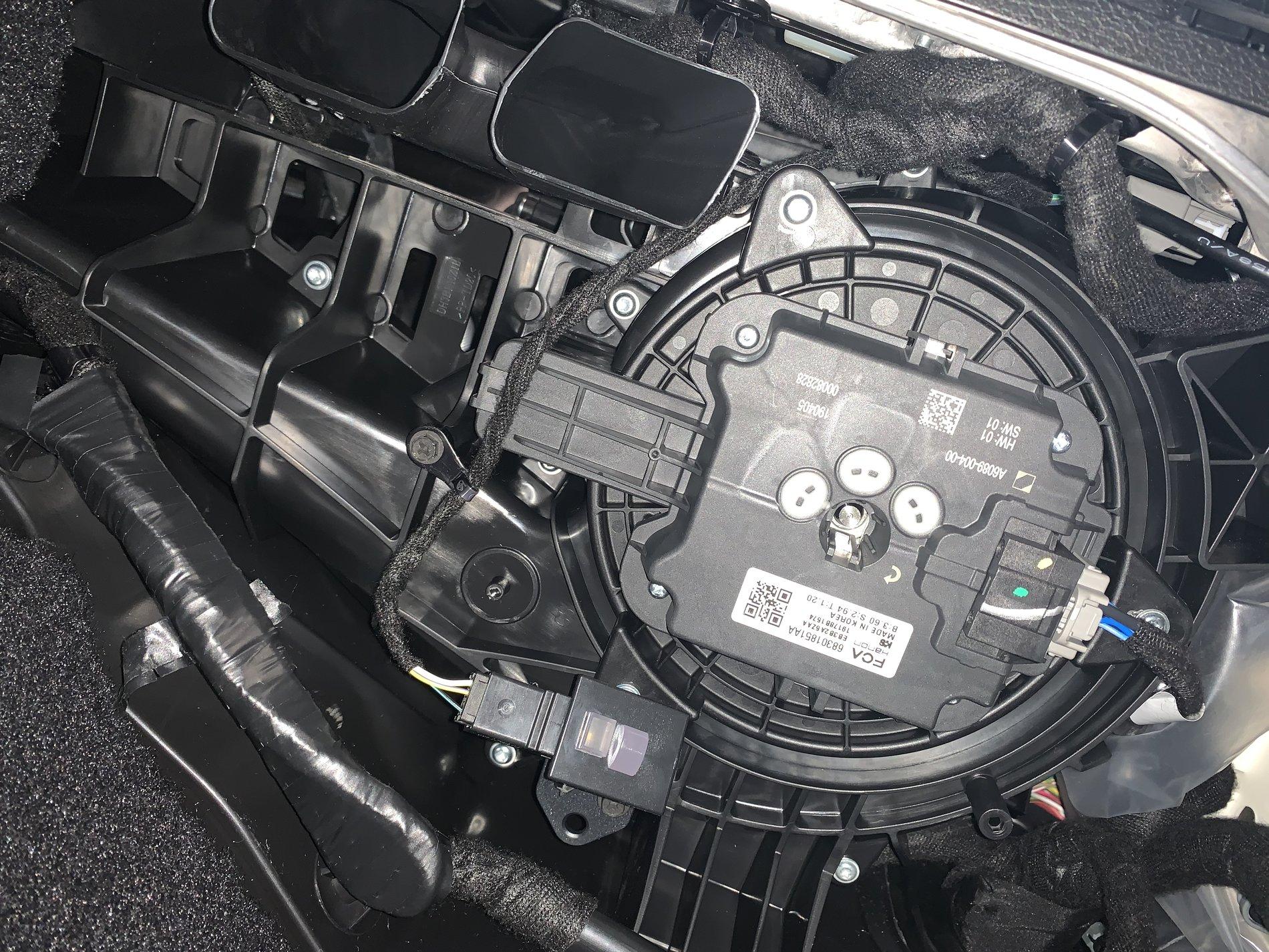

Hey guys...I have the mopar aux switch group, for the life of me I can’t find the interior wires, I went as far as completely removing the side panel, glove box, looked around carpet ect....did anyone else have a hard time finding them? Do you have any suggestions?

Pop off the lower right kick trim. The leads should be tucked under there.
