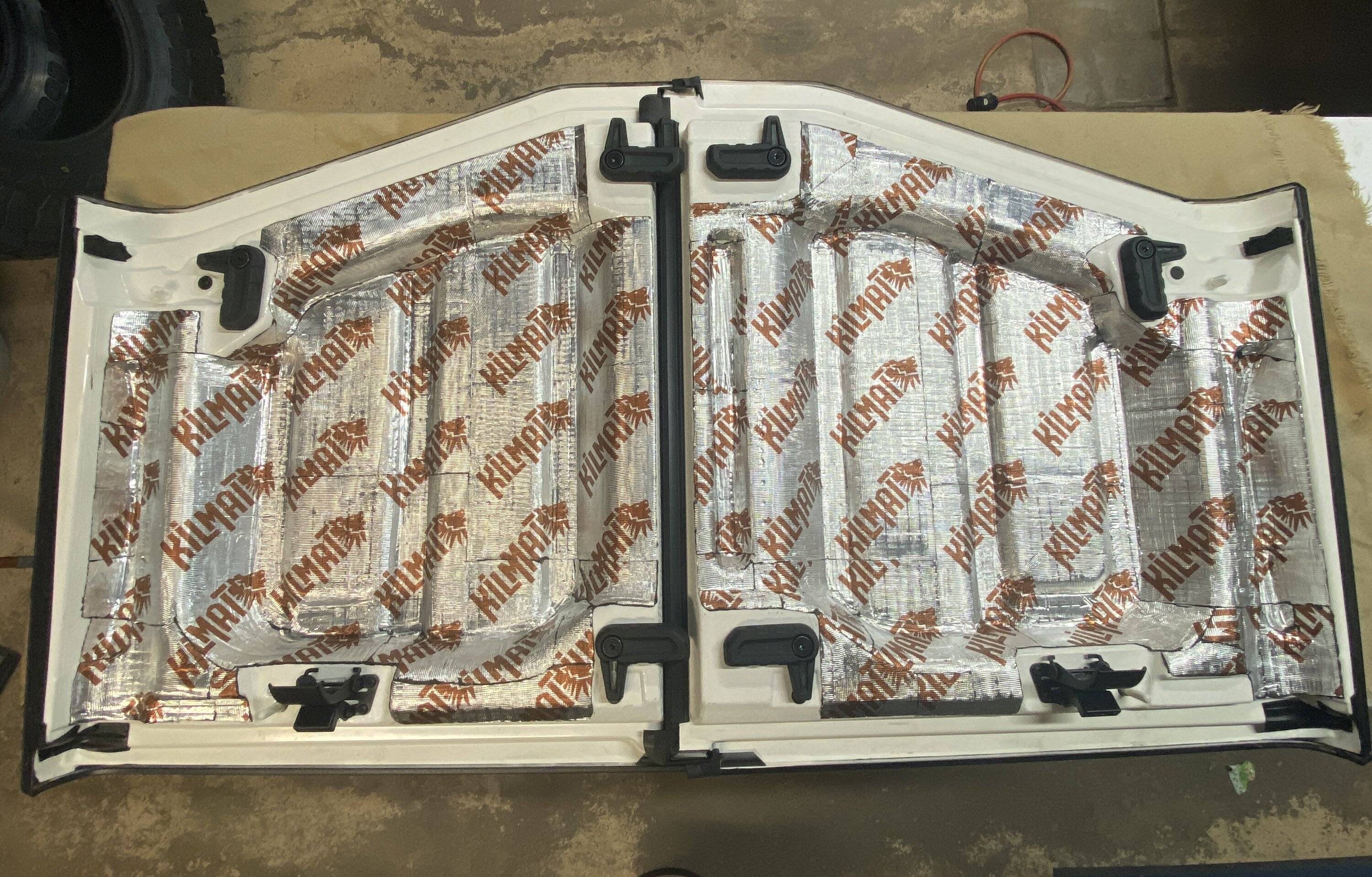

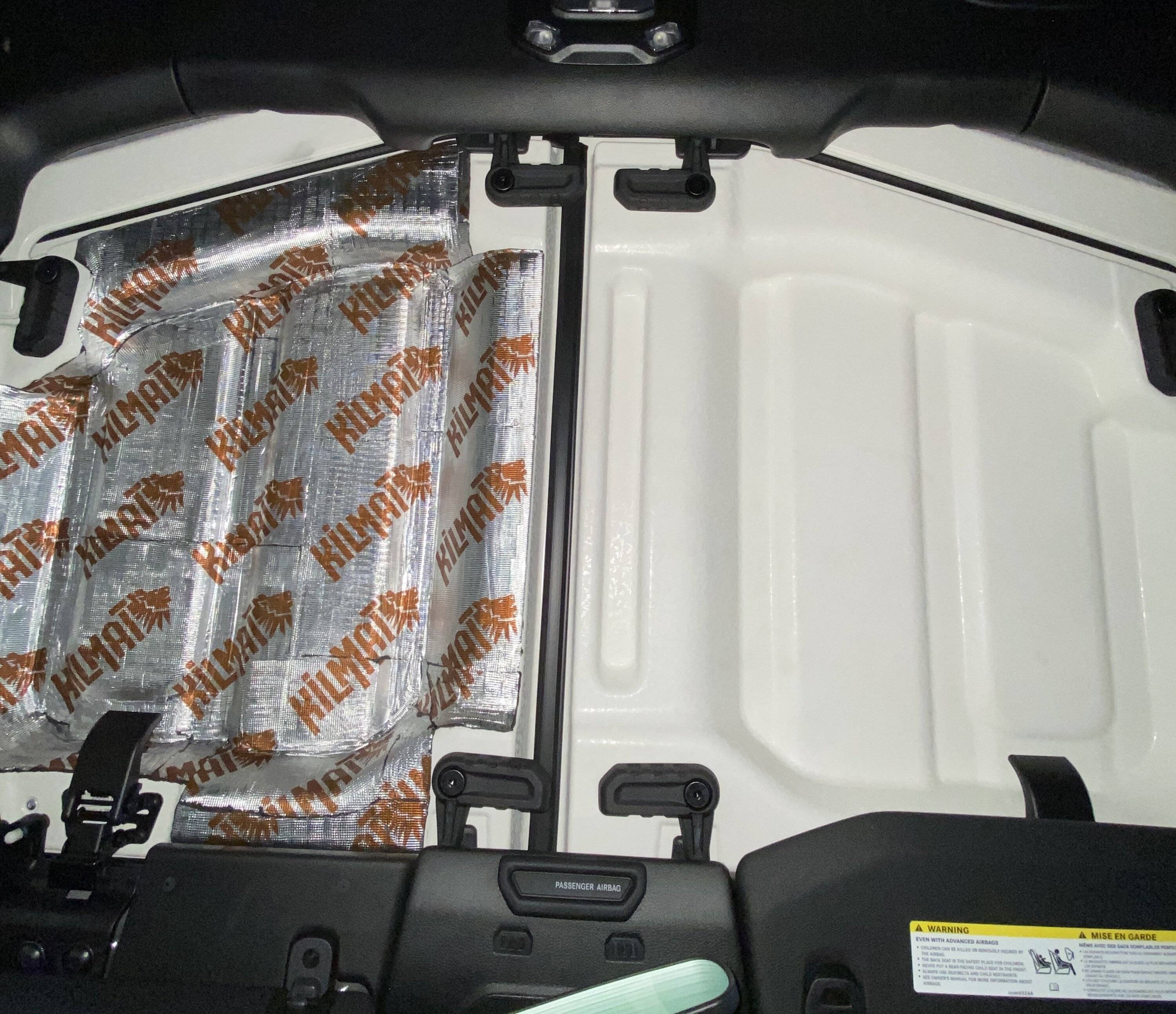

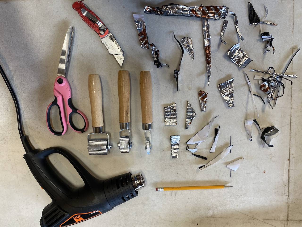

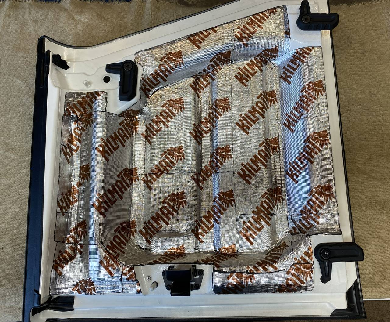

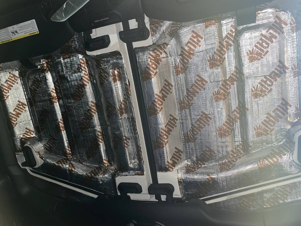

Went for it. Wind noise was bothering me at times. Also ordered the CoverKing carpet headliner. Rather simple to install. Sticks really well. Kilmat 80 mil and grooved rollers. The Kilmat sheets are not uniform. Print runs both ways so getting the overlap seams to cover really isn’t possible. Other that that looks goooood. Installed in garage that was 60° and -10 outside. Tried with and without heat gun. Heat made it floppy and not easy to work with. Warmed it up after install and pressed it in. Worked much better. Kept it away from latches so carpet installs easy. Last pic is what I had for tools. Wife’s scissors?, shhhhh. And the waste is from the drivers side panel.

Have you had it out yet. Do you notice a noise difference?
Yea for sure. Had it out on hwy at 80 mph with only drivers side done. It was -4 outside. Hollow echo was gone. Hear people talk much better. Wind noise on front edge is still there. After doing passenger panel it was more gooder. Hope when back half comes off tomorrow it tones down more. Still have carpet coming which is suppose to be shipping… suppose to be ?

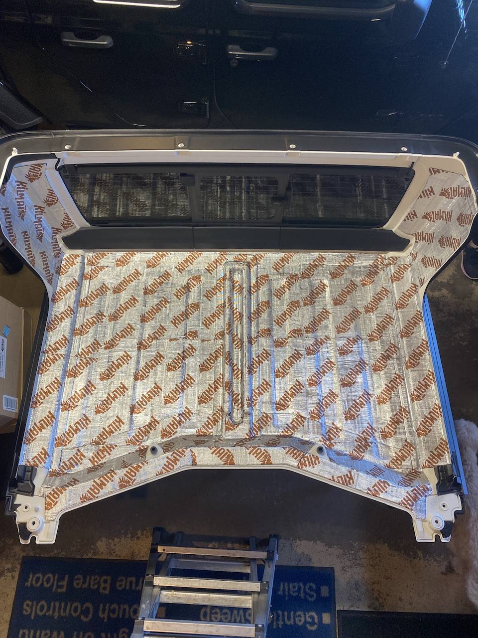

Got the rest of the hardtop done, but hit a snag. The Hard Top Headiner from CoverKing I order was canceled by Realtruck. Called them, they said they’re backordered. Ok then, Called CoverKing. Christine in customer service said “black is available with about a 2 week lead time. All other colors are on hold because they cannot source colored material. So like Henry Ford said a millennia ago, “ You can have any color you like, as long as it’s black.”

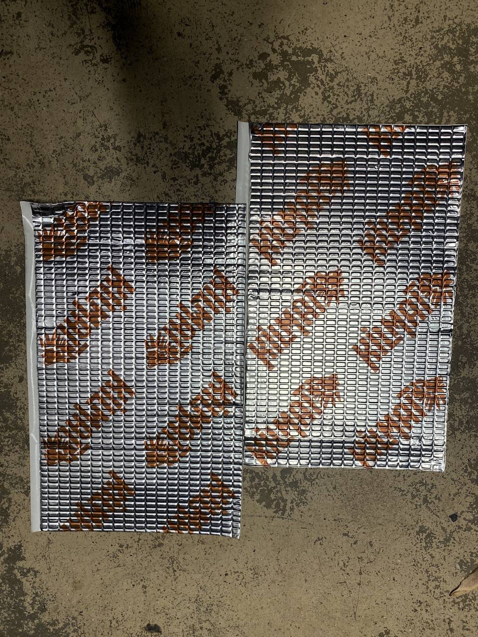

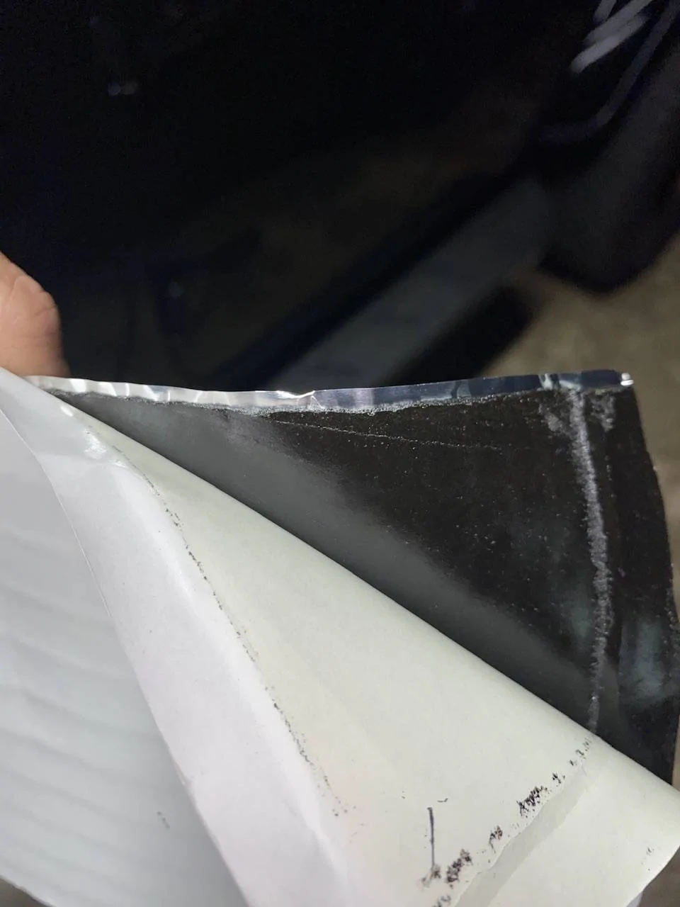

what did you mean by this?

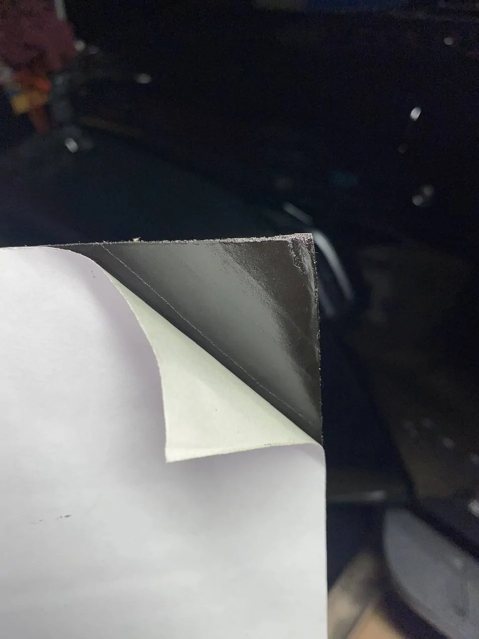

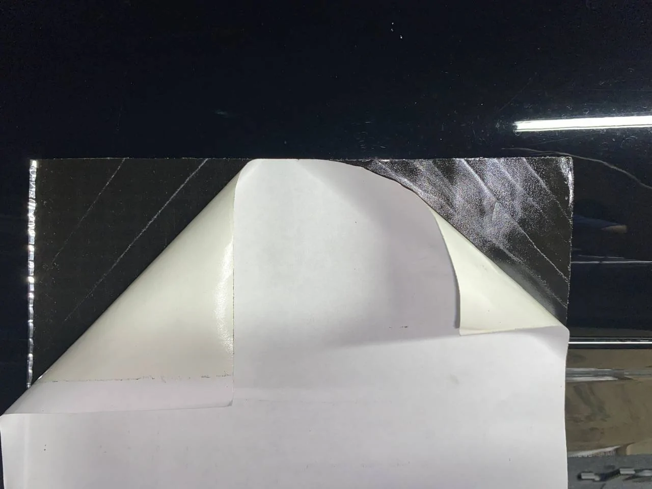

The sheets themselves are all the same size. Their not “uniform” refers to the “Kilmat” labeling on each sheet. The sheets have an overlap side. The overlap side covers your seams. When put together it covers the seam so you don’t have a black line where the two precut pieces butt up against each other. Well when I laid out the pieces to get the Kilmat logo all facing the right way I noticed it. Not a big deal if you going to cover it. I wanted a clean uniform install and wanted the logos all running the same direction. Attached some photos for help. 1 is 2 sheets butted up, logo is wrong way. 1 is my top looking up. 1 is the backing pulled back, last two show butt side and overlap side

Oh ok. Thank you for that. I suspected that that was what you meant. I’ll be covering my kilmat so logo alignment doesn’t matter. Thanks again.

didn’t use heat gun. Rollers with ribs worked great. Smaller rollers are easier to work with. Cooler temps the better. You’ll notice a bit of an odd smell for couple weeks when first open door. Other than that it’s great. Cab is quieter, radio louder. ??
