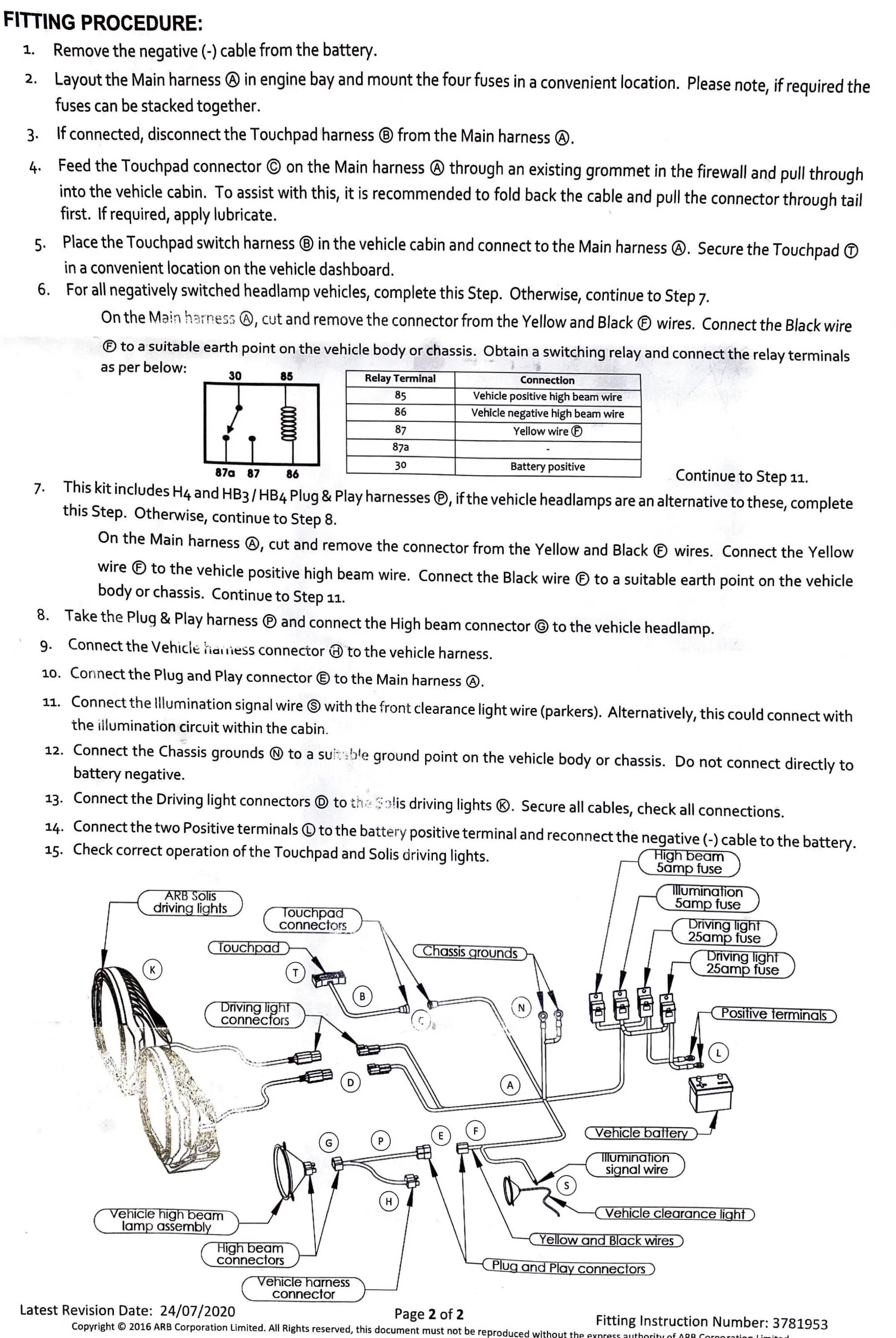

Hello.
I have the "Premium LED Lighting Group" on the jeep.
I need help on were to I need to tap the wire in jeep.
I have mount the light and pass through the firewall and install touchpad..
I review the Quadratec install video , but on the video from QuadraTec It don't show were to connecting to the High been only from red cable to the red battery terminal and black cable to the chassis of jeep and also they not mention about a "vehicle clearance light". I think that is the running lights.
I call ARB for support and it tell that it need to be connected ? they are no help at all. special when a mention it for a jeep!
1. what it is a "clearance Light" I think that is the running lights. witch cable is that I need to top in ?
2. for the High Been . do you know a adapter ,that I can used for a plug and play. like I mention before I call arb and ask for one.
they have adapter but It docent fit the Headlights,

Instead of tapping into the high beam, most people just wire that signal wire (yellow) directly to the battery. This allows you to use the light without the high beams on. If you wired them to the high beams, you could only use them with the high beams on.
For the illumination wire, I wired it to an ignition hot source in the power distribution block (fuse block). My lights come on when the Jeep is on. I have the ARB light set to the lowest setting and it's on all the time as a running light.

thank you so much Steven_B
I have the Aux switch bank from Mopar. so I am ponder to used Aux 3 because that is a 15amp switch. "don't know how much I need from ARB"
Connect the black cable to the chassis of jeep "3 total black cable to grounds"
Connect the yellow and red wire together with the wire for the Aux switch you chose " 2 total red cable to the battery" and " 2 total cable to Aux 3"
Thanks for this! I've been loking all over for info on wiring these lights with the premuim lighting group.
