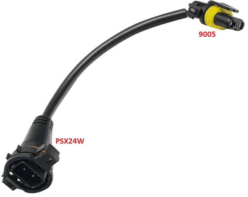

Are you using the "Plug & Play" adapters?
The 9005 plug side on the "Plug & Play" adapters can be plugged in either way. Commonly, this can be plugged in backwards. Try unplugging and rotating those 180 then plugging back in.

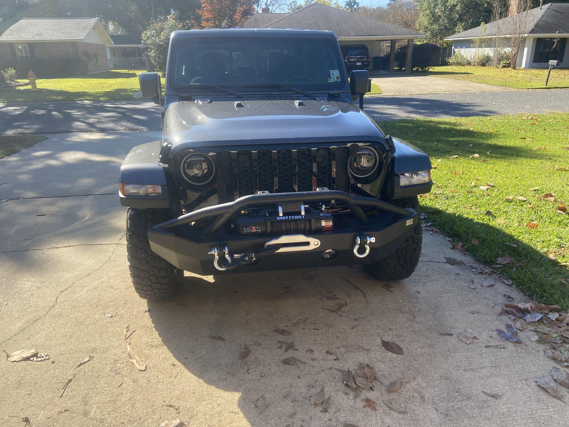

I figured it out. When I was checking voltage last night, I didn’t think to verify polarity. Had the PSX24W end of the plug and play harness reversed. All good now. Lights work and look good.
