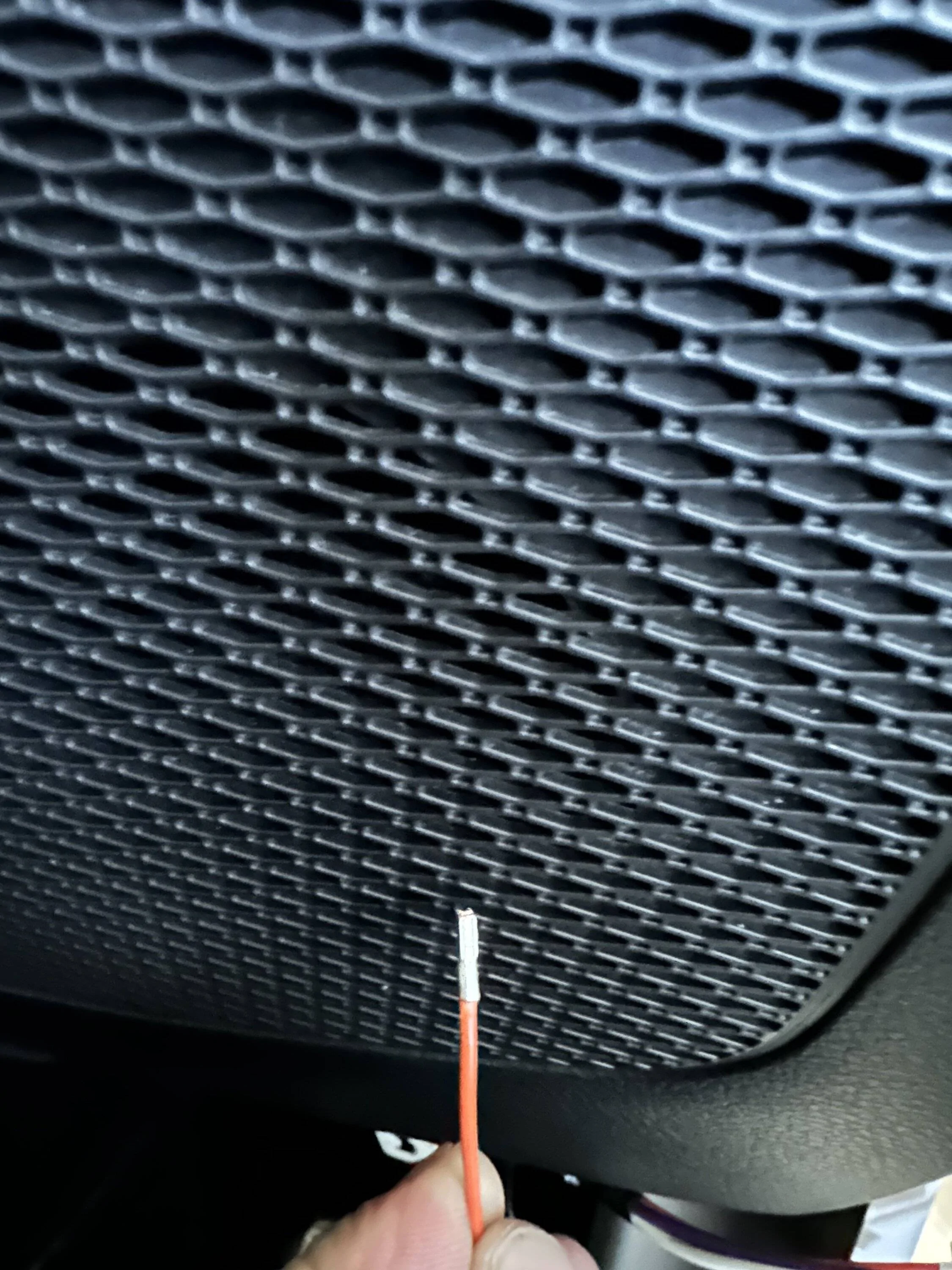

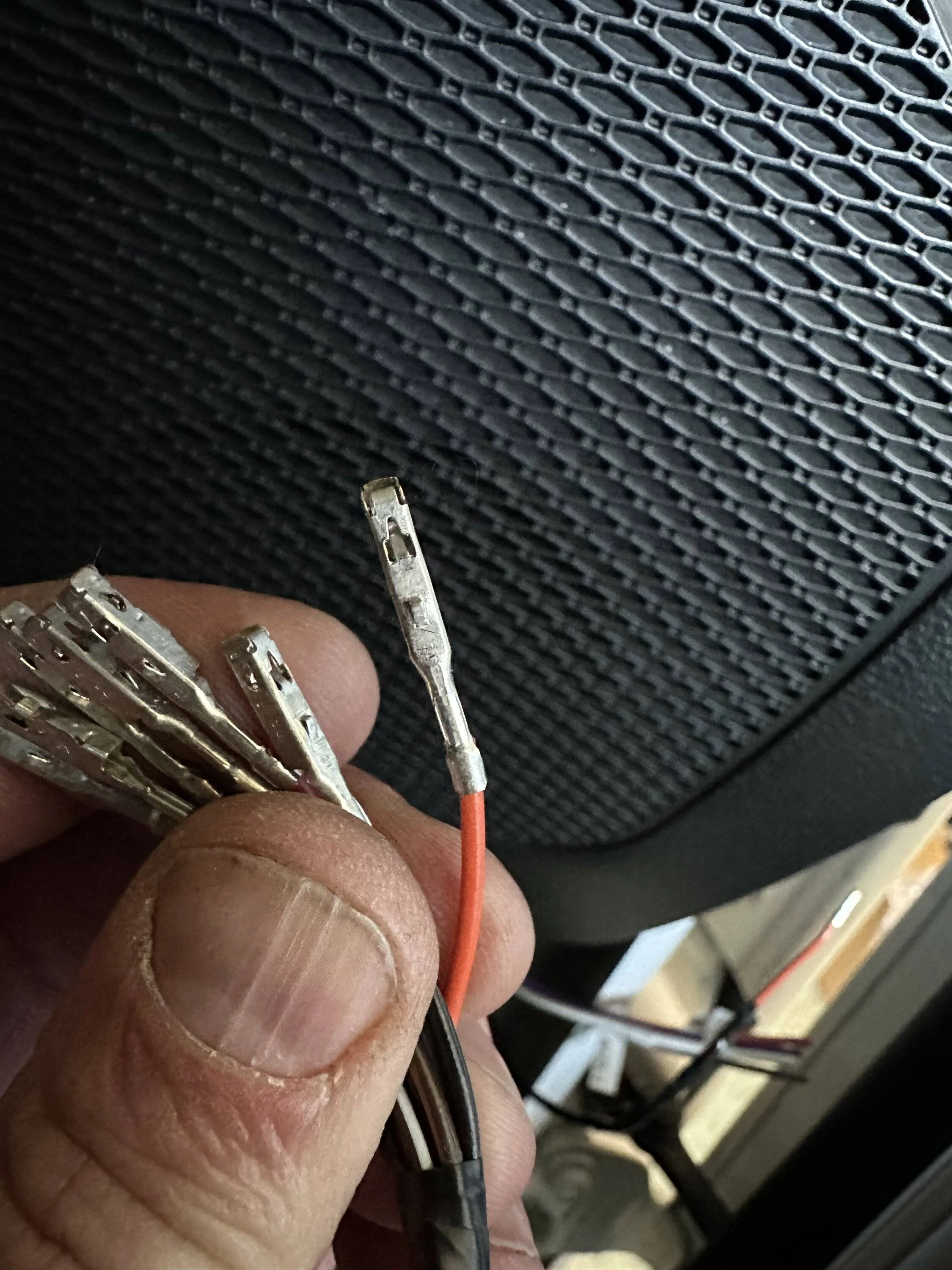

I’m installing the mopar aux switches and when I went to plug in the orange wire into the big grey harness the connector snapped in half. Must of been faulty or something. Anyway, can anyone point me into the right direction to repair the connector? First pic is the broken one second pic is what I need.

I like the idea of the lead and just splicing it but just not sure what the exact connector is. Most of these look completely different.

Those are Molex 33012-2003

Awesome thanks. I was able to rob some pig tails from the door harnesses I just replace when installing my proximity handles. But I’m sure others will break them at some point and need to order them.
