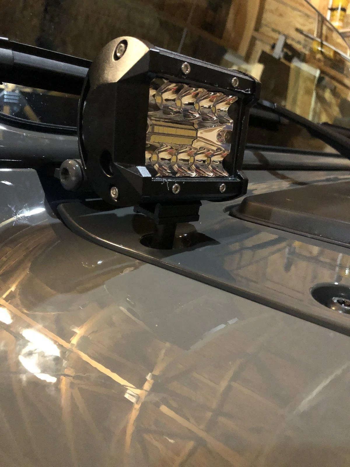

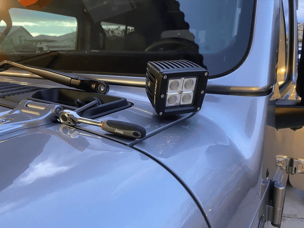

All of the A-pillar mounts are really ugly, and expensive. So I started looking around at things I already had or could make. I found some small aluminum spacers that fit into the cowl screw holes well, and some extra long bolts that worked (6mm). The bolts were from a TV mount, and the spacers might have been too. I had them sitting in a spare parts drawer in the garage. I cleaned and painted them, then just put the screw through the light bracket and into the Jeep. Super easy. The cable runs into a gap by the hinge, and along an open channel, to the factory AUX switch wires. A marine heat-shrink butt connector hooks it up there. They work great, and I think the look is fantastic.

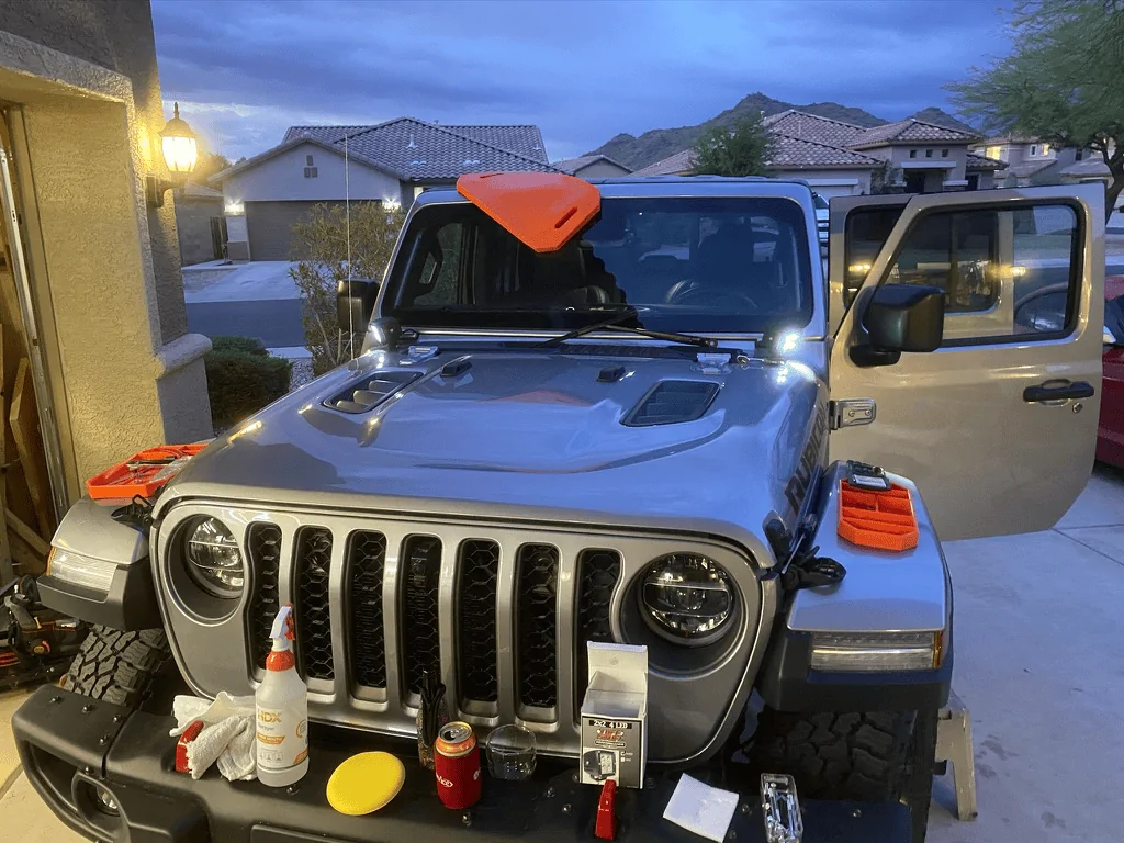

The lights are not in the way at all. That orange thing on the windshield was there because I had the hood folded all the way back to do the wiring. No issue with clearance.

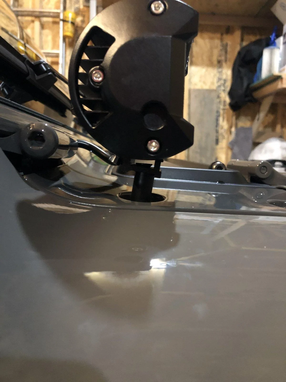

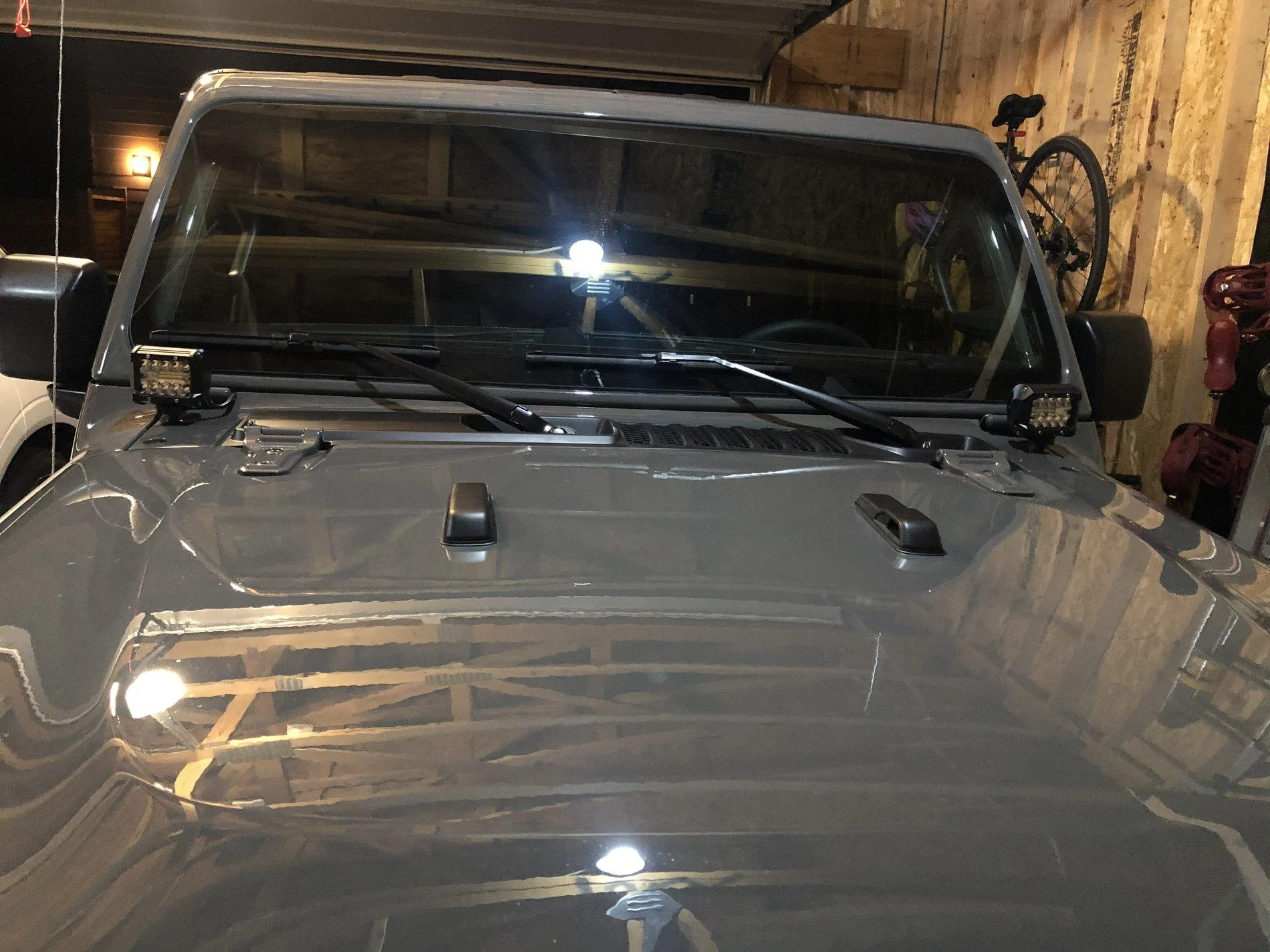

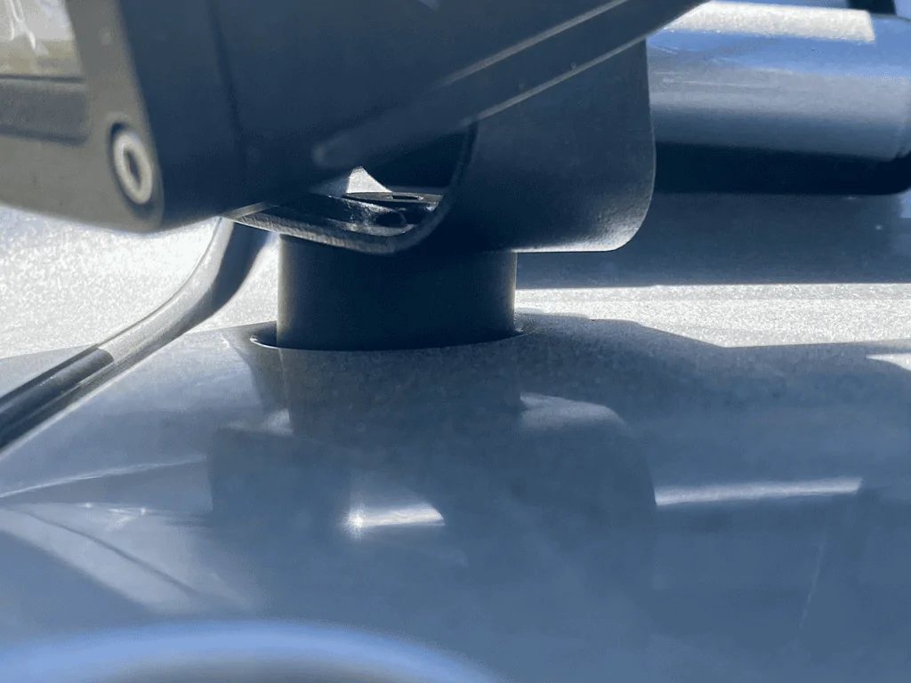

I copied your idea, except I didn’t have any spacers in a drawer and my local Home Depot only had these little narrow ones. They seem to be pretty sturdy though. Thanks for the suggestion!
SwampNut
SwampNut
Carlos
Apr 20, 2020
1,588
1,567
Peoria AZ
2020 Gladiator Launch Edition
Geek
Looks good! They should be fine as long as you don't take any hits to them. Around here it's common to have trees hitting the sides and the lights, hence the term, "Arizona pinstripes." If you decide you want heavier spacers, I just saw something very similar to mine at Ace.
