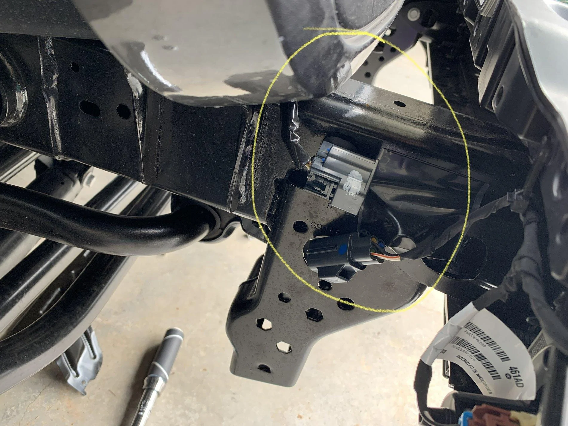

The connection from the vehicle to the front bumper for the fog lights is on the passenger side frame rail at the bumper. If you’re ditching the fog lights, I imagine you could use the existing fog light harness in the bumper to fab one up for your light bar. Once the lights are wired up use the existing connection that’s on the frame rail to hook it all up to the vehicle’s system. I have no idea about the wiring diagram though.
