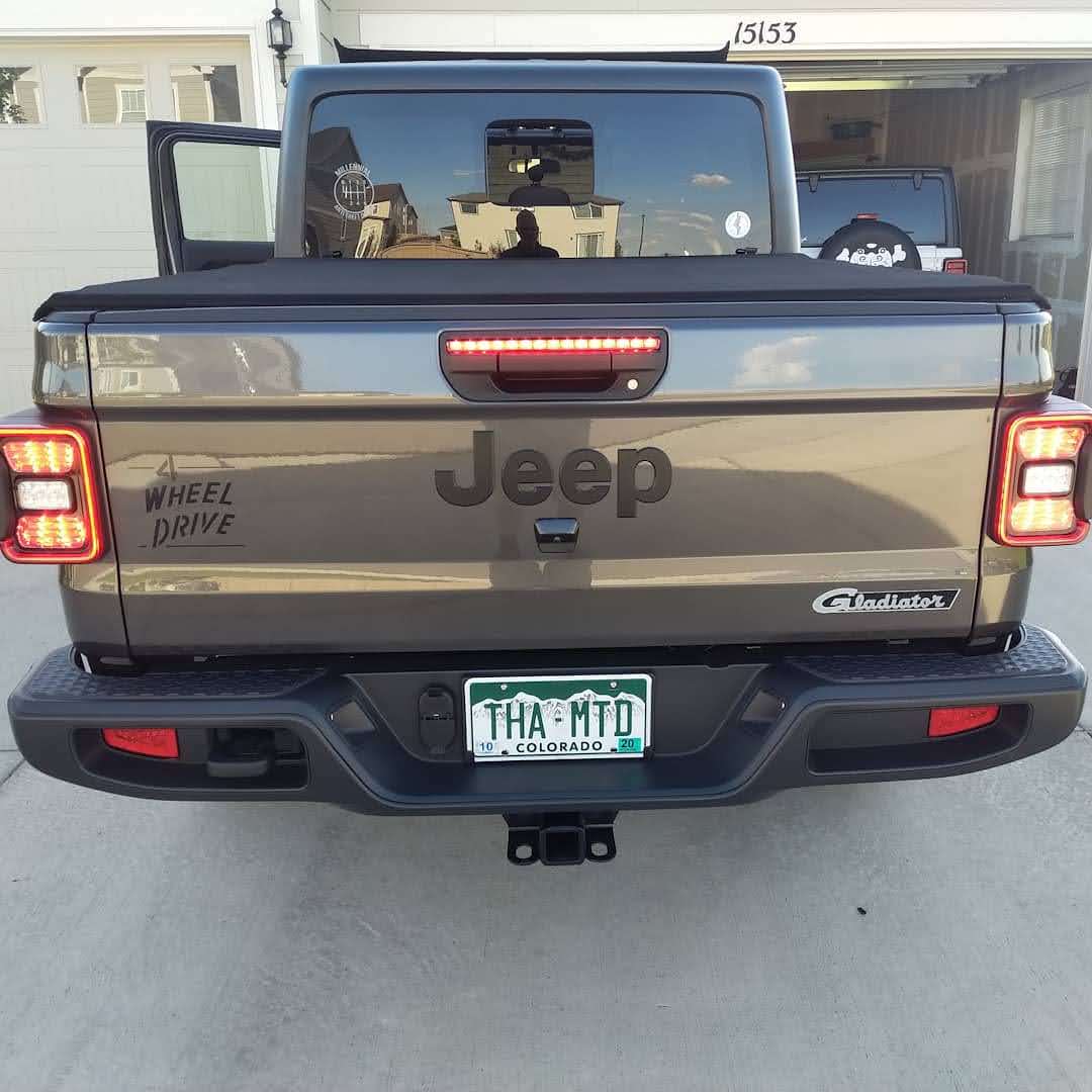

Easy swap. Tazer or Jscan or dealership to tell the computer that it now has LEDs.
