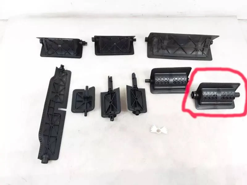

as far as I can tell from the outside the only thing obviously different from outside examination is the drivers side missing an actuator, I included a picture highlighting the drivers side blend door actuator mount on a SZ air box, it looks like there is something there, is it a blend door being unused? a plug,? I have no idea.

After investigation into the blend doors on a SZ airbox it was discovered that all blend doors and baffles for a DZ HVAC Airbox where present and functional in a SZ HVAC Airbox. Further More these blend doors act identical in the DZ HVAC Air Box as in a SZ HVAC Air Box. The only real difference between a SZ and DZ HVAC Airbox occurs with the Drivers Side Blend Door.
The Blend Door that regulates hot and cold on the Drivers Side is functionally identical in a SZ Air box as a DZ Air box, however as noted in the photos the Drivers Side Blend Door in a SZ lacks the external connection for Actuator Gearing, and features a internal plastic gear that links this blend door the Passenger Side Air Box.
This leads to the question of upgrade ability, at this time the difficulty of removing an Air Box Baffle would be more intense than simply replacing the the entire HVAC Airbox.
Please note that this is just engineering and not a guide to convert a HVAC Air Box from SZ and DZ, any attempt to do so is at your own risk and I will not be held responsible.
With this knowledge there does appear there may be a path available to covert from SZ to DZ fairly easily however there is much engineering work to be done on this matter to make it safe and no one should attempt to make any modification on their jeep.
