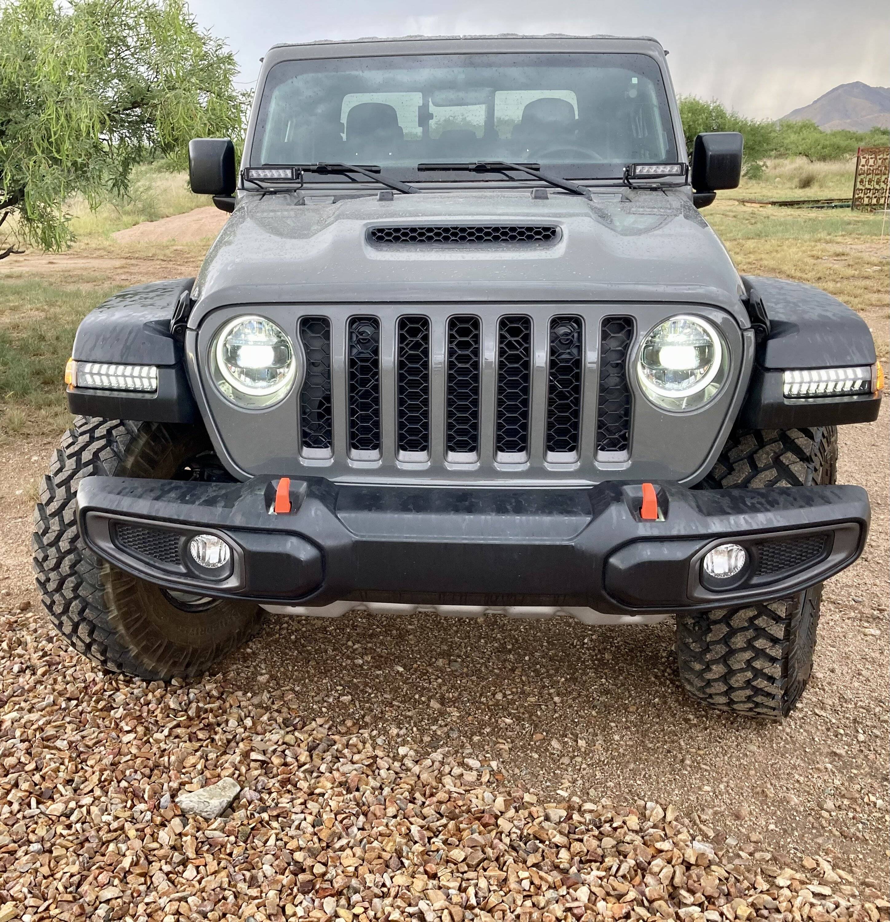

Update: The driver's side unit failed in an interesting way. I want to say upfront that Infinite Off Road has been great to work with here -- and gave super fast responses to my email inquiries. Really, top notch customer service! "25 year replacement guarantee"!
So, I started to notice the driver's side main white LED element would randomly quit working (just a few days after the initial installation). As you'd imagine, this is hard to see unless you happen to catch a reflection or step out and see it for some reason. In this failure scenario, the amber indicator would work fine. Only the white LED and side marker would fail to operate. The sequential indicator would always work when the other components would not.
Curiously, I could sometimes get it to cycle back to normal function by toggling power off and back on again. That would not always work and got me thinking it might be heat related (the physical connecters seemed fine). Also, I've had a couple occasions where it would not recover until the next day (when discovered at night). So, being a heat related failure is my final thought on this for now. Anyhow, I shared some videos about how it would fail, and sometimes recover. They thanked me and said their engineering team would check it out.
To their credit, they sent a replacement unit right away. They typically need a video to demonstrate the issue, but when something fails intermittently, that is hard to do.
I installed the new unit today. It seems fine so far. For the price, and excellent service, I'd have no hesitation in recommending this setup. For the money, this is amazing value. I learned a bit here too and remain happy with the fender lights and Infinite Off Road.
