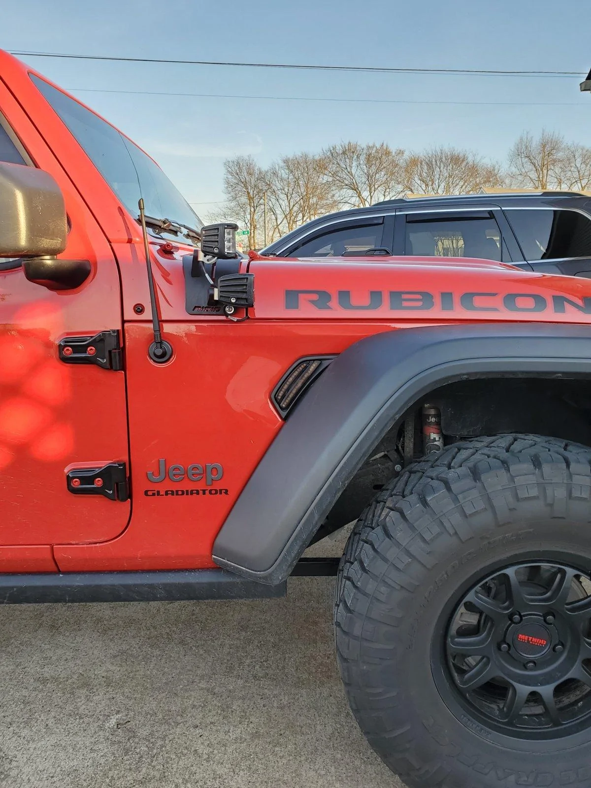

For anyone interested in small form factor, vent replacement turn signals, I picked up a set on amazon. I believe there are variations on ebay as well. They were actually kind of difficult to find because I wasn't sure what to search. I actually came across them on one of the Facebook pages a little while back
https://www.amazon.com/dp/B082F4P3MR/ref=cm_sw_r_em_apap_5Wc2UqQo6C7Wm
My impressions: They're incredibly bright, and are well made considering their price (around $40). They do require a bit of DIY wiring, but it was straightforward. There are various options out there, such as Oracle's new offering that have different features at a higher price point, so do your research and figure out what you need beforehand.
Jeep Gladiator Vent Turn Signals 20200307_170726

I just used posi-taps to tap in to the hot and ground wires on the front fender turn signals, so no cutting at all. It was really easy honestly.
And honestly, I highly doubt they'd do that, unless you have some personal contacts over there.
