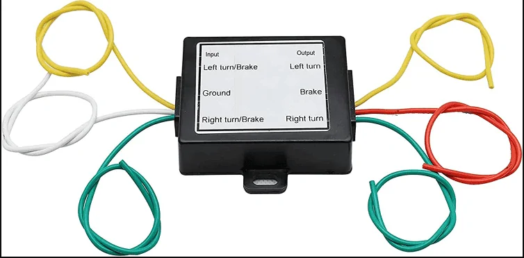

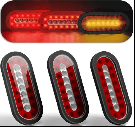

I have these mounted in my aftermarket bumper (so in addition to the stock tail lights)
Jeep Gladiator Rear yellow turn signals? tail light
with the center leds blinking yellow/amber for turn indicators.
But as previously pointed out with any separate turn indicator(s) you will have to run a converter (in my case a 'RED WOLF Trailer 2-to-3-Wire Splicer-in Taillight Converter')
Jeep Gladiator Rear yellow turn signals? converter
to get the turn indicators to split off from the brake light. Not a big deal as <$20. I wired mine into the trailer connector wiring so zero issue with the JT's 'normal' light circuit.

I recall those boxes in the 1980s when cars started switching things up. Some had turn signals distinct from the red brake lights, some did not. On the vehicles with yellow, there was a box, basically diodes, that took that signal from the amber rear turns and fed it into the trailer's brake lights without feeding back into the vehicle's brake light system.
My first run-in with them was in the early 1980s when some Eagles came with all red, others with amber turn and red brake. I towed so needed one of those adapters but if I had been thinking, I could have done the same with some diodes and saved money. No different than what I am doing now to run my backup lights from either being in reverse, or from an aux switch.

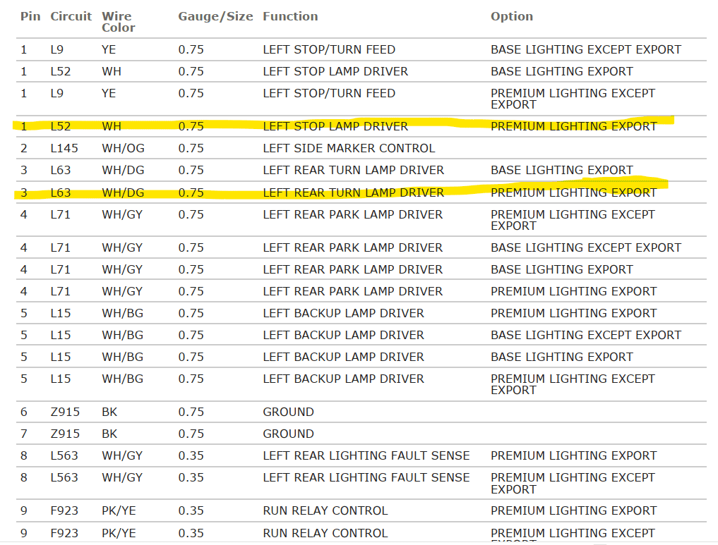

https://www.jeepgladiatorforum.com/forum/threads/export-tail-lights-on-na-spec-gladiator.31651/
This is a helpful thread on conversion to the euro-spec rear taillights with amber turns. I've previously converted a JK while in Europe for a bit. One helpful thing I found was to tap the front turn indicators and run that wire back to the tails. I'm not sure how that'd work on the more modern CANBUS in the JL/JTs, but it's not going to be a simple plug/play setup on North American spec truck wiring.

Would not take much to check out the wiring based on this - see what happens when you hit the brakes - which wire or wires goes high, and then when you hit left turn - which wire goes high.
