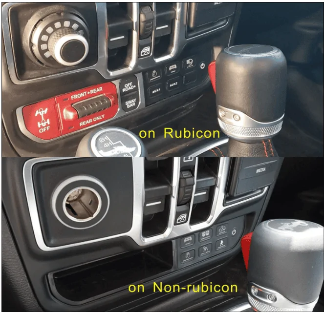

I am installing the VOS 300 under dashboard switch set in my 2020 Gladiator Sport and a second 12 volt power plug in the armrest console (like the JK's had). The VOS switch set has a power button turning the whole group on or off - you can choose to have the unit always powered and have this on/off switch connect to the battery or you can have the whole group ignition switch on/off. I am going to use the ignition-on/off feature.
I am going to control three Axial twin LED row lighting units - one on the front bumper override bar, one forward facing on a Tyger sport bar (fake roll bar that we will also use to mount Rotopax gas and water containers on the cheek plates) mounted on the truck bed edge, and the third rear facing and mounted below the forward facing light on the Sport bar (the two lights forming a single bracket around the bar). The Tyger bar doesn't interfere with our tonneau cover. The switches will also control power to an ARB compressor, a second 12 volt receptacle mounted next to the OEM USB receptacle, and a 12volt-110AC inverter and plug for the truck bed. This is a picture of how the VOS switch looks.
Jeep Gladiator Installing Vos300 under-dash switch set and a 12 volt power socket in the armrest console like my JK had. 1625194921874
I will provide photos step by step. The VOS instructions have the switch control wires going through the hood seal, under the removable windshield cheek plate and around the windshield into the dash. Nope, there is a perfectly sized access hole right below where they want the wire to wedge through the hood seal.
