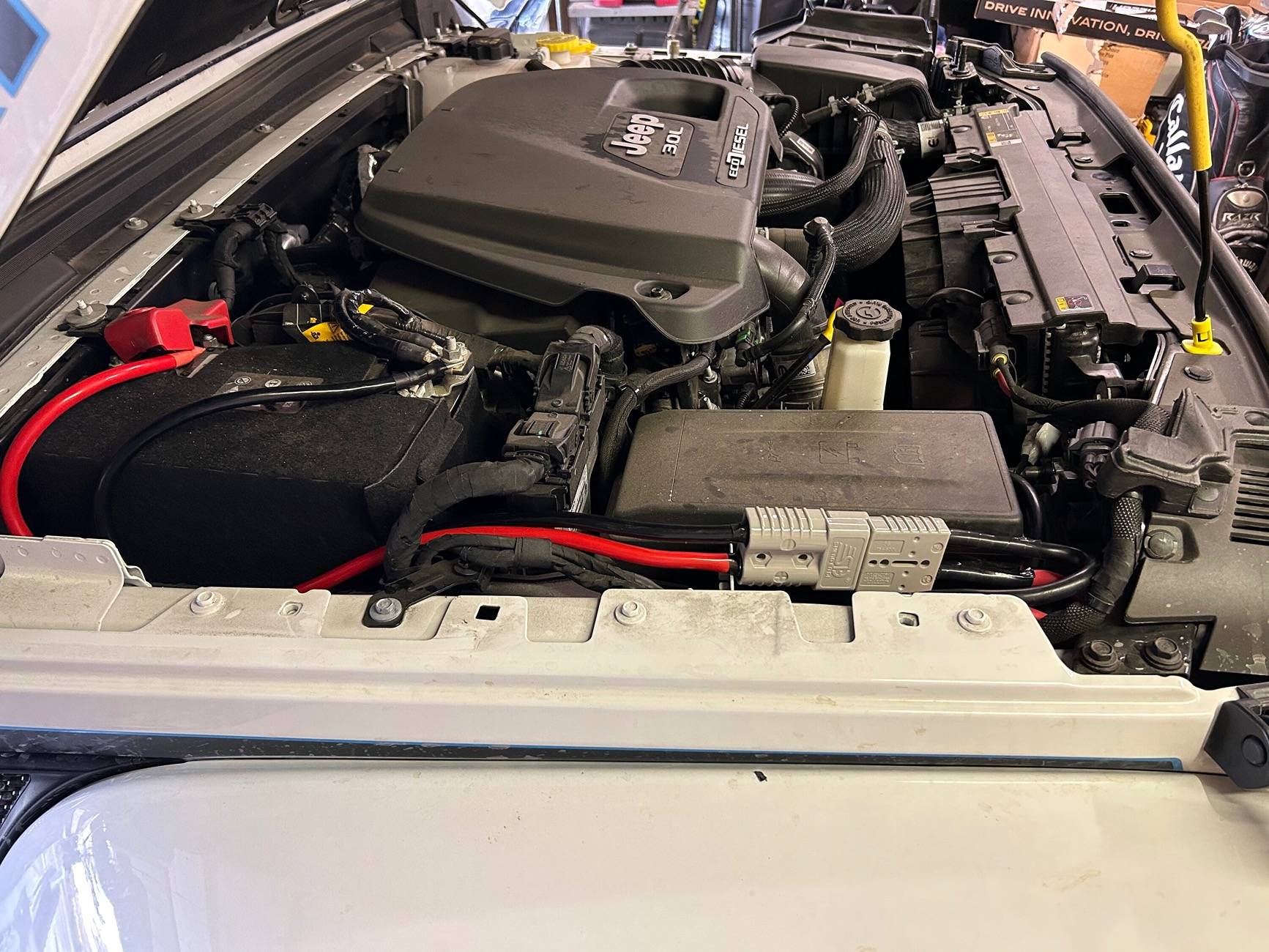

In the past, I've run an anderson powerpole from the battery to the bed. Snipped the alligator clips on the compressor and added powerpole connectors to both the snipped wires coming from the compressor and the snipped alligator clips.
That way, I could either plug it in or make it portable again.

This is pretty much the exact plan I have for my portable Viair (at some point). A connection up front and at the rear so that I can utilize those connections on my truck or re-connect the alligator clips for use anywhere else.
I'd like to use flanged Deutsch connectors on the truck for a clean look with an opposing cap attached with a small tether to seal it up when not in use. Need to pull my compressor back out and see what the wire size was....

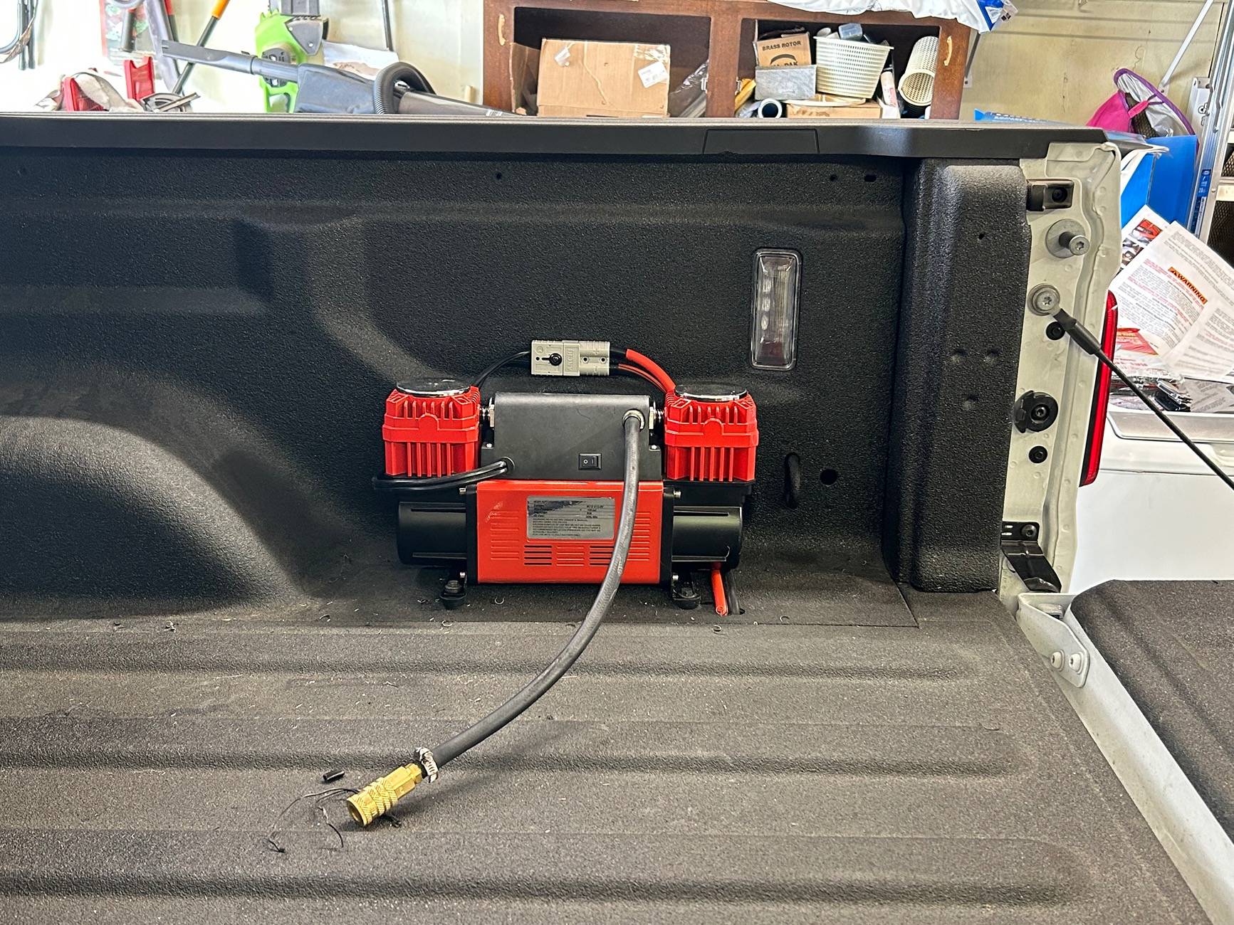

The reason I ask is I know a guy that knows a guy
Jeep Gladiator 12 volt compressor in bed? IMG_3963
Jeep Gladiator 12 volt compressor in bed? IMG_4181
