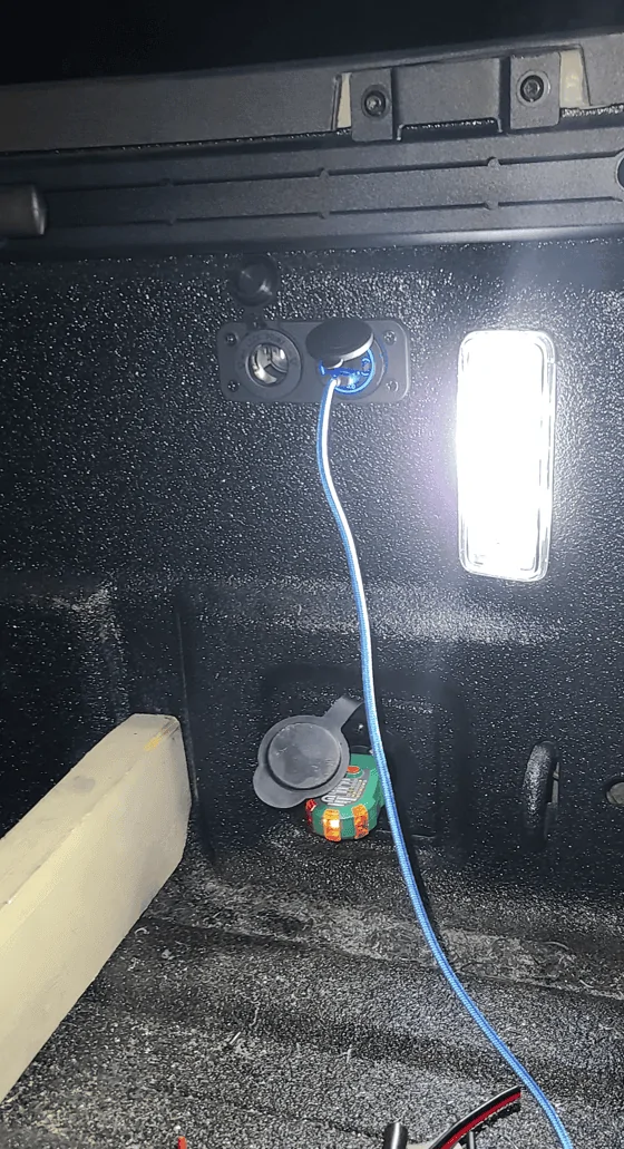

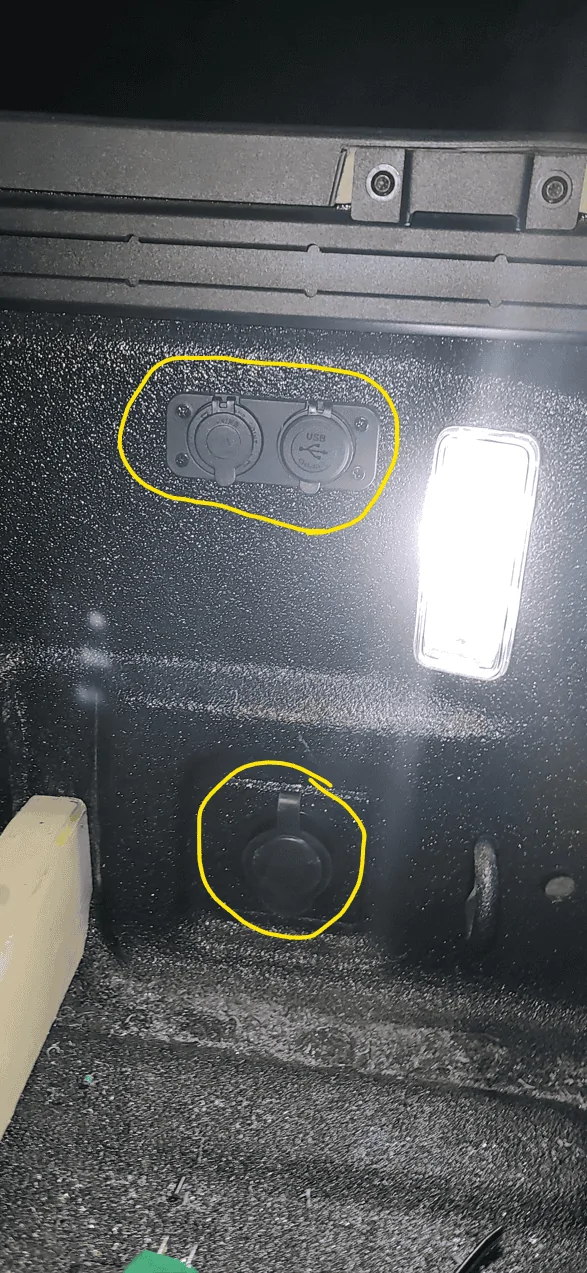

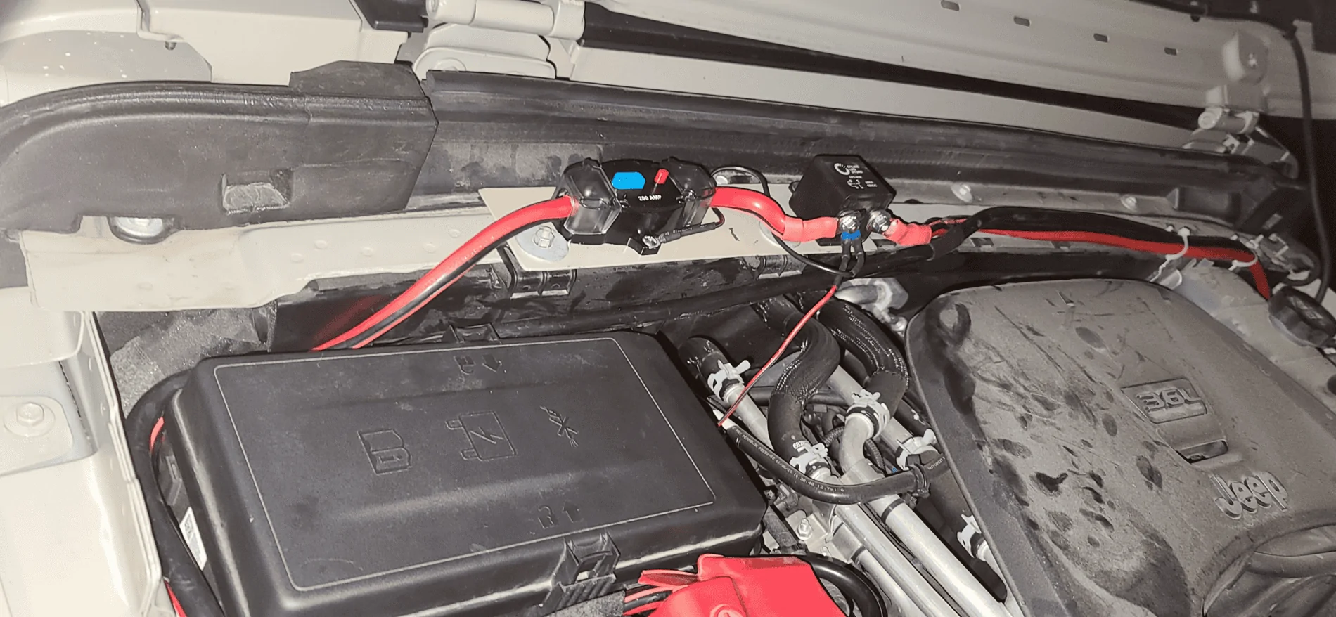

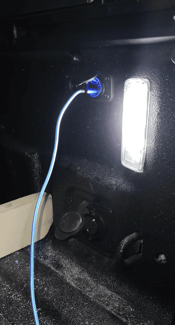

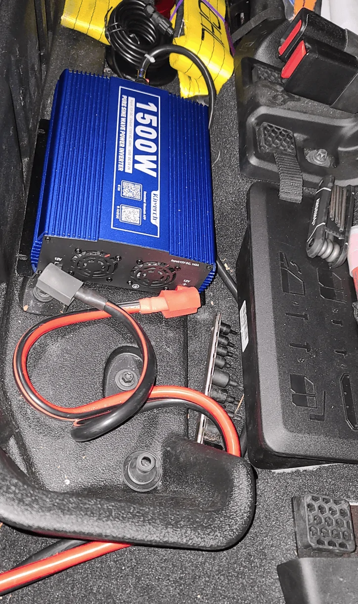

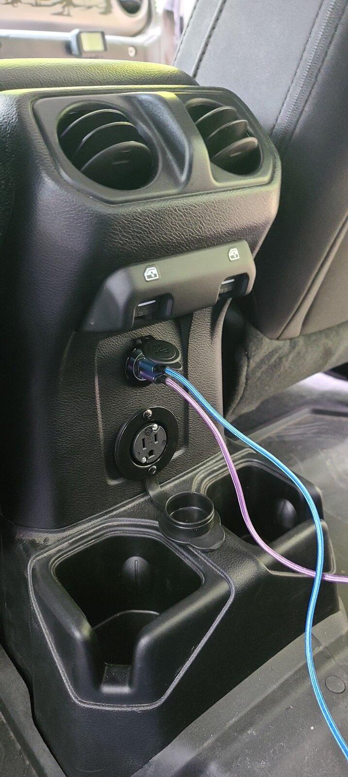

I finally got around to putting in a 1500 watt pure sine wave inverter so I have an outlet in the bed of my truck, and a second outlet in the back seat. I put the inverter under the rear driver seat, and ran what seemed like miles of cables to make it all work. While I was under the truck fishing wires all around I also added a 10 amp 12 volt port and a 60 watt USB-C PD port in the bed. This should work as a back up to my generator as well keep the fridge and essentials running incase the generator craps out when I need it, and when out camping out of the truck I shouldn't have any issue keeping the kiddos comfy.
