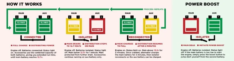

I think the other value is the way the Genesis Offroad dual battery kit works. It's actually smart in what it does. It's not just tying two batteries together:
Here's how it works.
  • When both your batteries are fully charged at 13.2 volts, they are automatically connected and are charged at the same time.
  • When you park and turn off the engine, but continue to use accessories such as lights or the stereo or a CB, both batteries begin to drain down.
  • When your main cranking battery reaches 12.7 volts, the smart isolator separates the batteries, so that your cranking battery will have enough power to start the engine. The second battery continues to power your accessories for as long as it will last.
  • After you crank the vehicle, your main cranking battery will be charged up to 13.2 volts first, and then the isolator will begin charging your accessory battery. By only charging one battery at a time, your alternator is protected from excessive strain.
What if your cranking battery is somehow drained down too low to be able to start the vehicle? We have a solution for that.
  • Press the Start Boost button and the isolator will connect both batteries together for 1 minute, acting like built-in jumper cables to jump start your engine off your accessory battery.
  • As long as the accessory battery has enough power, you'll be able to start your vehicle instead of being stranded with a dead battery!
  • The alternator will charge both batteries for 1 minute, then switches back over to automatic mode to reduce the strain on your alternator.

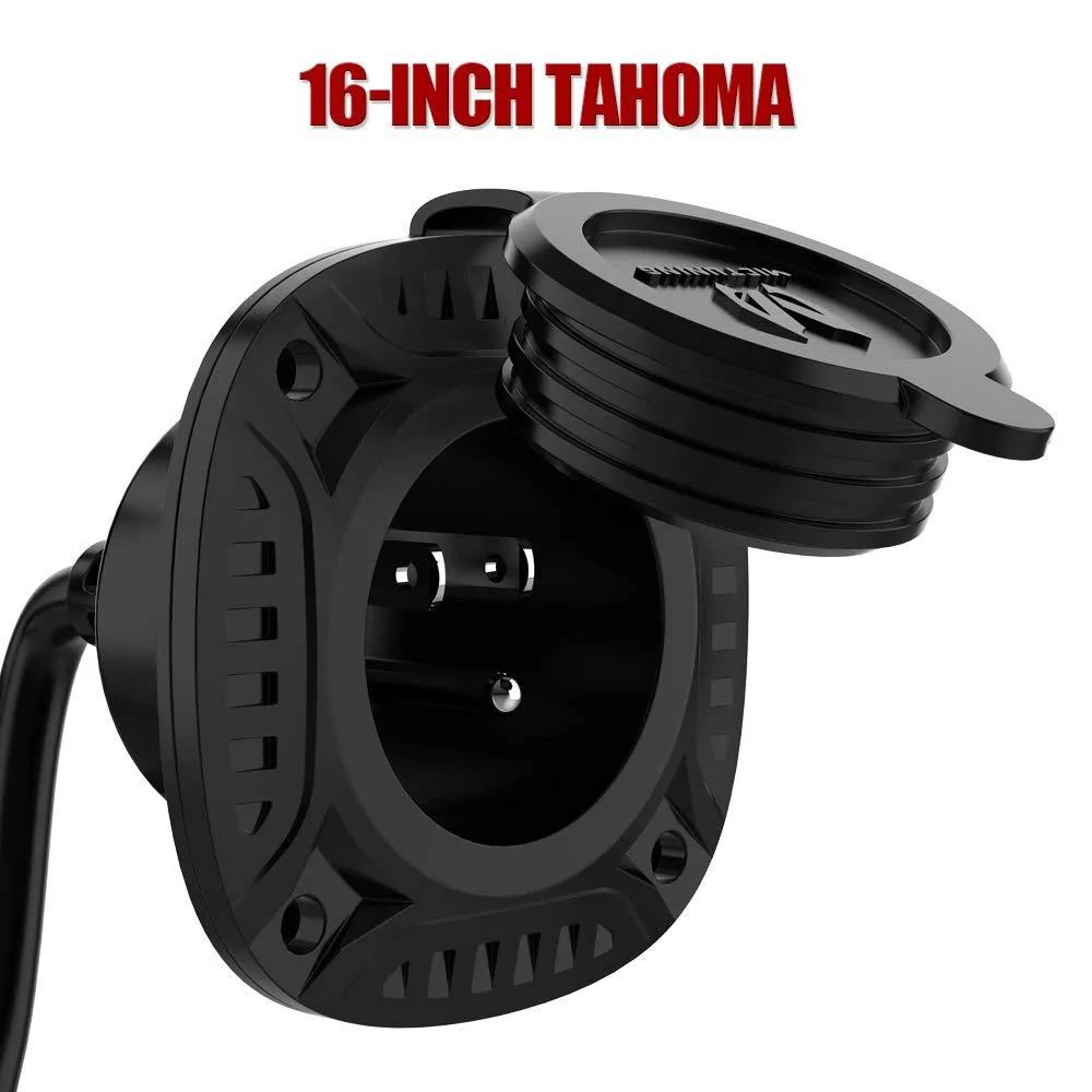

Thanks. Hmm wonder how easy it would be to put in your own wireing and plug using the same hole provided
Need to find something like this, but with female recepticle, not male plug.
I used something similar to put a coolant heater in my TDI. So somebody has to make something the opposite connection.
Jeep Gladiator 12 volt outlets? 51xAm2fF-uL._SL1000_
EDIT, just looked, the outlet is screwed in with 4 screws, so you can easily make a cover plate out of sheet metal, drill 4 holes and screw your plate down with an outlet on it.

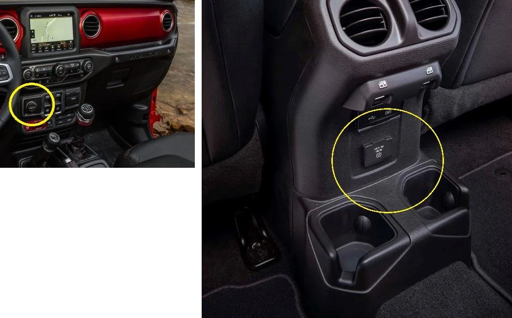

12volt on the center dash above the axle lock button (unless you get the trailer brake controller, then I'm not sure where they would include a 12volt outlet) and a 120v on the center armrest console.
Does anyone know if the 120v on the center armrest will come with the Sport and Sport S models?
My Sport S Max Tow does not have the 120V on the center armrest.
