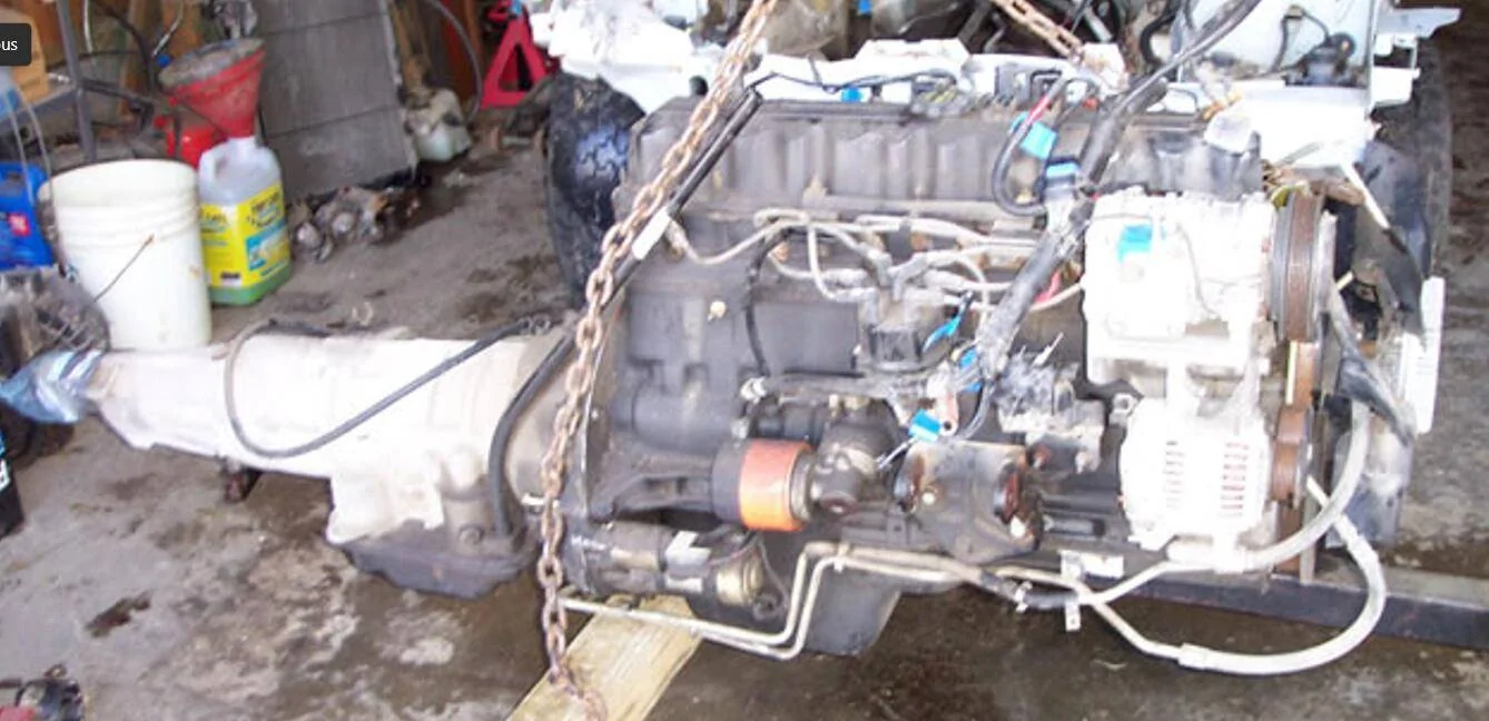

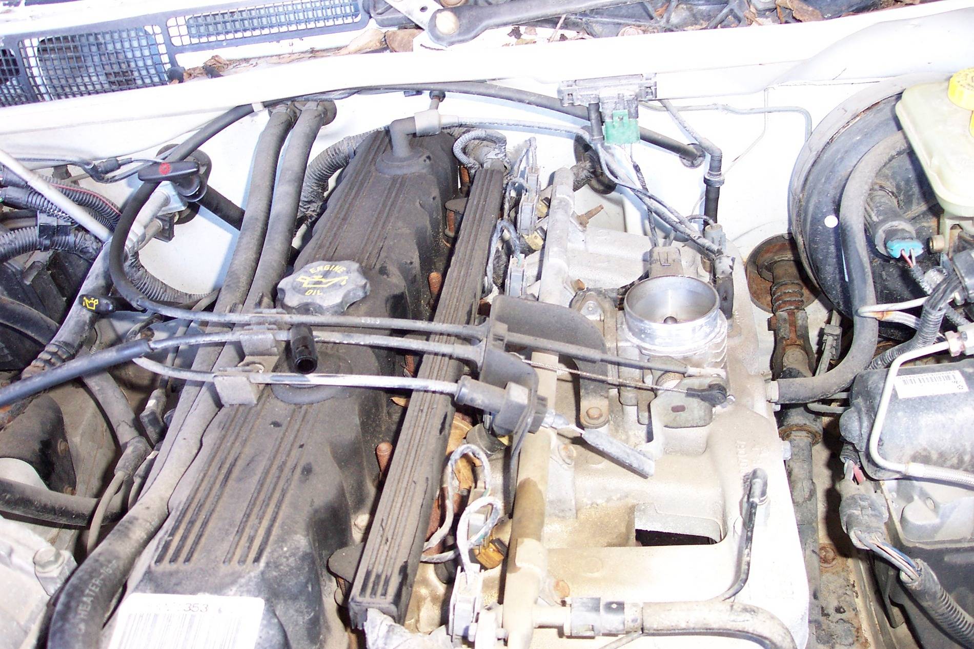

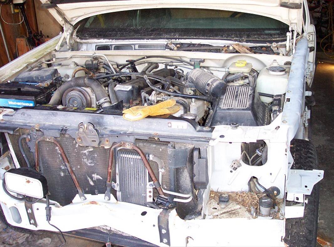

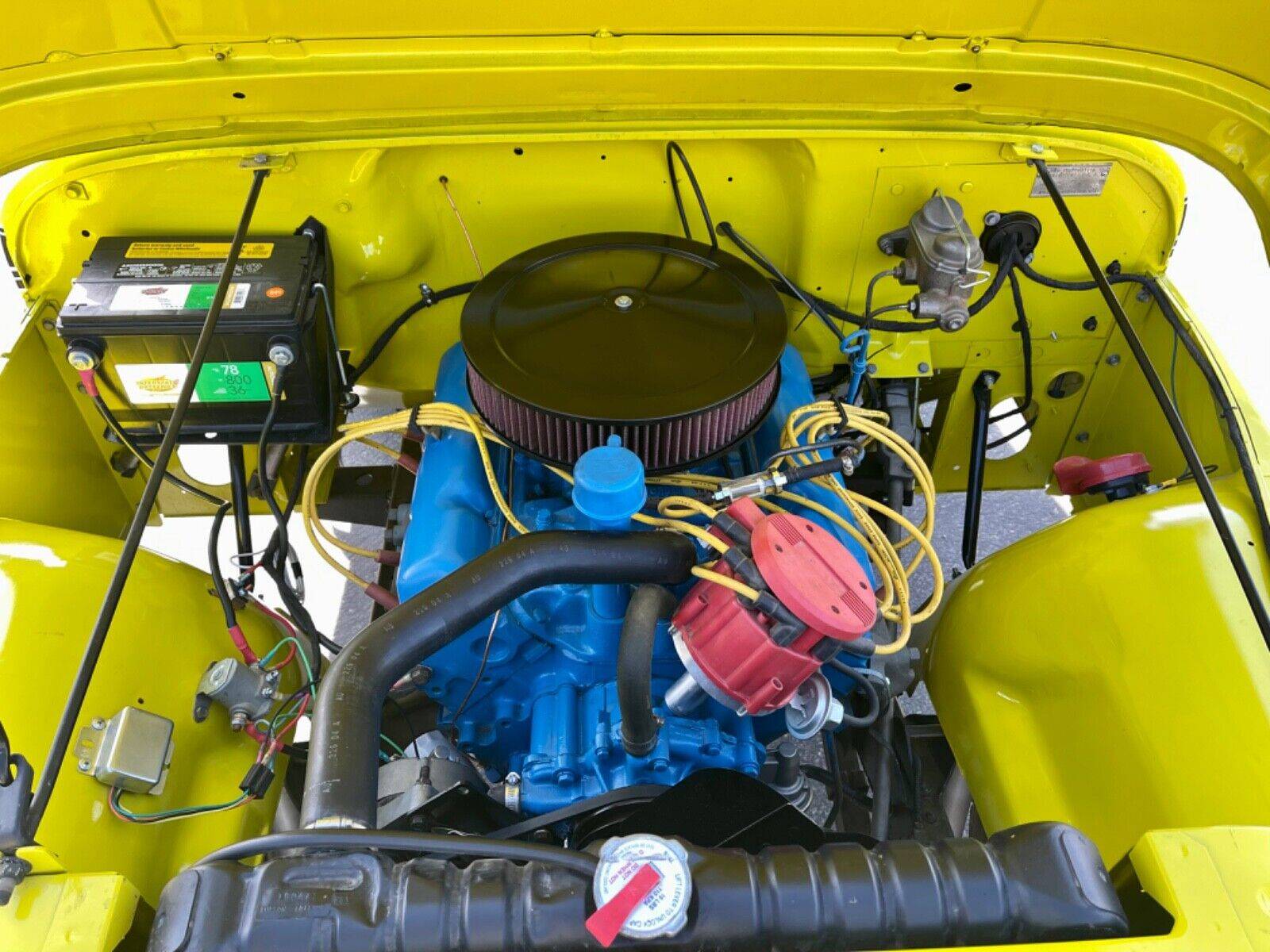

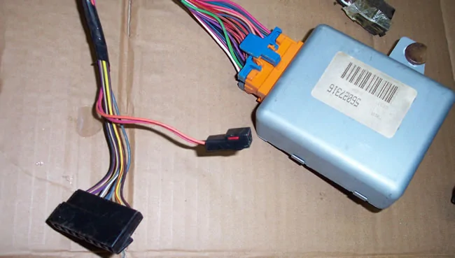

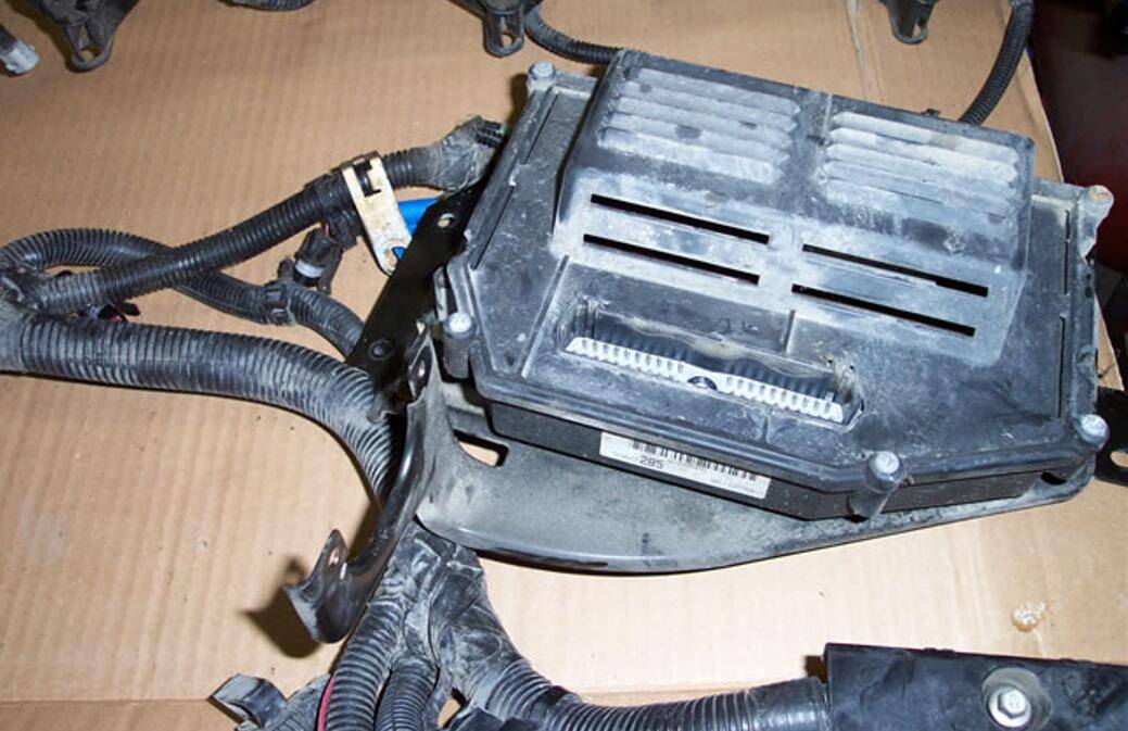

ZJ was OBD I era. There were two modules - PCM and TCM. Since I have a T5 I didn't need the TCM, and even if I did, it would not have mattered. They don't care about VIN and so on.
My AC, cruise, voltage regulation for the Jeep alternator and a few other things all run through the PCM - and PDC. I have the transmission controller in a tub somewhere but have no use for it.
The Jeep cruise - embedded in the PCM, required very different inputs for control - set, resume, and so on. So I built a circuit with a relay and a couple of diodes to modify my AMC turn signal stalk mounted cruise switch signals to operate the Jeep's cruise system.
The nice thing is that when the PCM detects a radical RPM increase related to road speed, it cuts cruise, but I also put a switch on my clutch to be really sure. Pressing the clutch sends a NSS signal to the PCM stating it's in neutral, cutting the cruise as well. Plus, it starts so easy I wanted to be sure I remembered to push the clutch before trying to start it........
I used a Dakota sensor (VSS) at the speedo cable output from the transfer case. It allowed me to send the VSS signal to the PCM as well as operate my stock speedometer cable.
I put a Jeep electric fuel pump inside the stock tank without any modes to the tank itself. I used some wiring and connectors from the ZJ to make a wiring harness for the sending unit which also handles the in-tank pump.
So the PCM and PDC also handle the fuel system exactly as in a Jeep.
Aha! Was the donor ZJ a manual or an automatic? Clearly the PCM isn't freaking out about the missing TCM, if it was an auto.
Some neat hacks there, to keep the stock cruise lever and cable-driven Eagle instrument cluster (while keeping the PCM happy). I think the '96 XJ to MJ swap is quite a bit more turn-key than your ZJ to Eagle setup here.
Makes me wonder how the 392 swap people are solving some of the same issues on modern-day JTs; there's no JT-specific PCM firmware that's compatible with anything other than the Pentastar/Ecodiesel.

The donor was an automatic. That's why I said I had the TCM from it.
