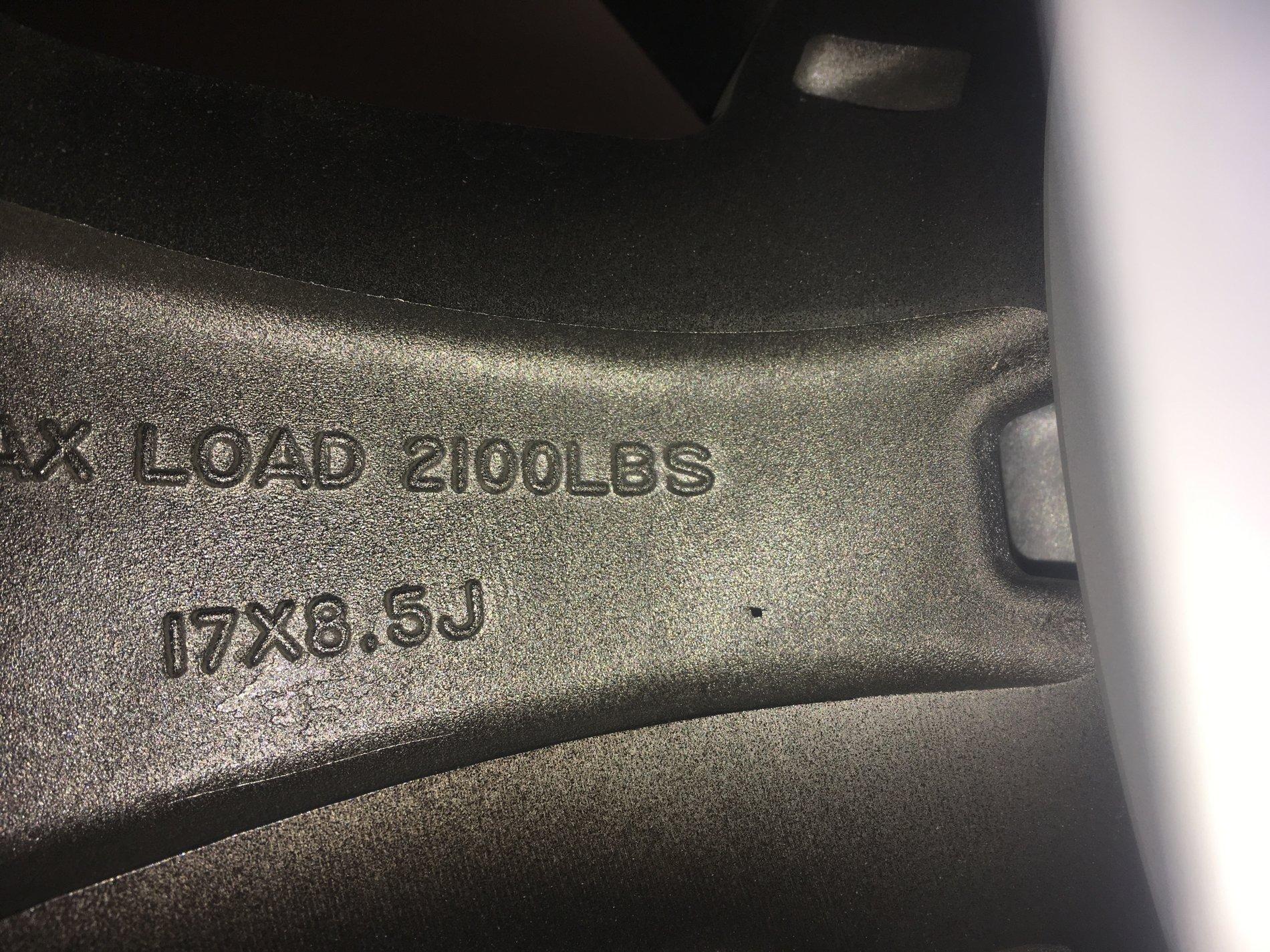

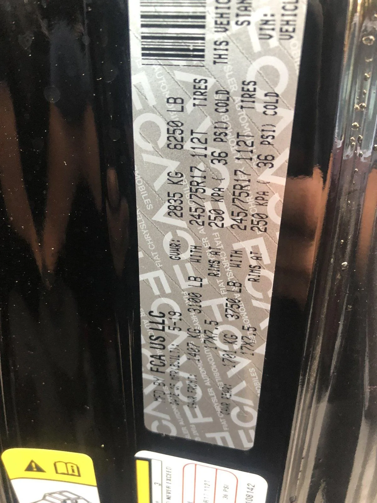

Many wheels have the max load cast into the back of the wheel. My Quadratec wheels are marked 2100 lbs. I seem to recall that my factory wheels were rated a bit higher, but I sold them and can’t check.Yea thats been my concern about them....i intend to tow 6,000lbs so the rim strength is a factor.

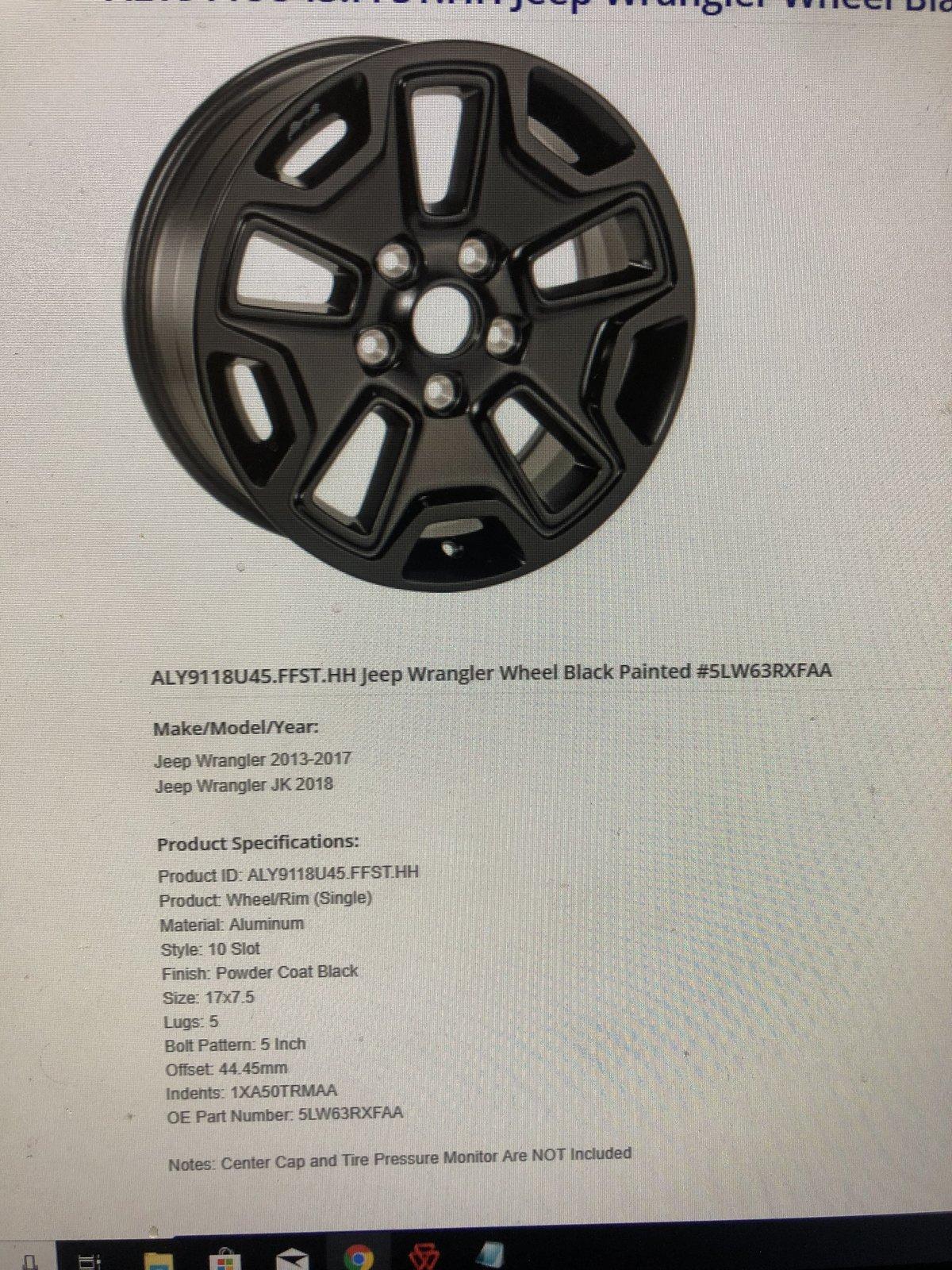

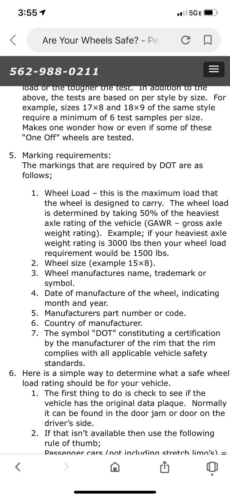

Does anyone know where to find load data for rims?
Here are the ones Im looking at
