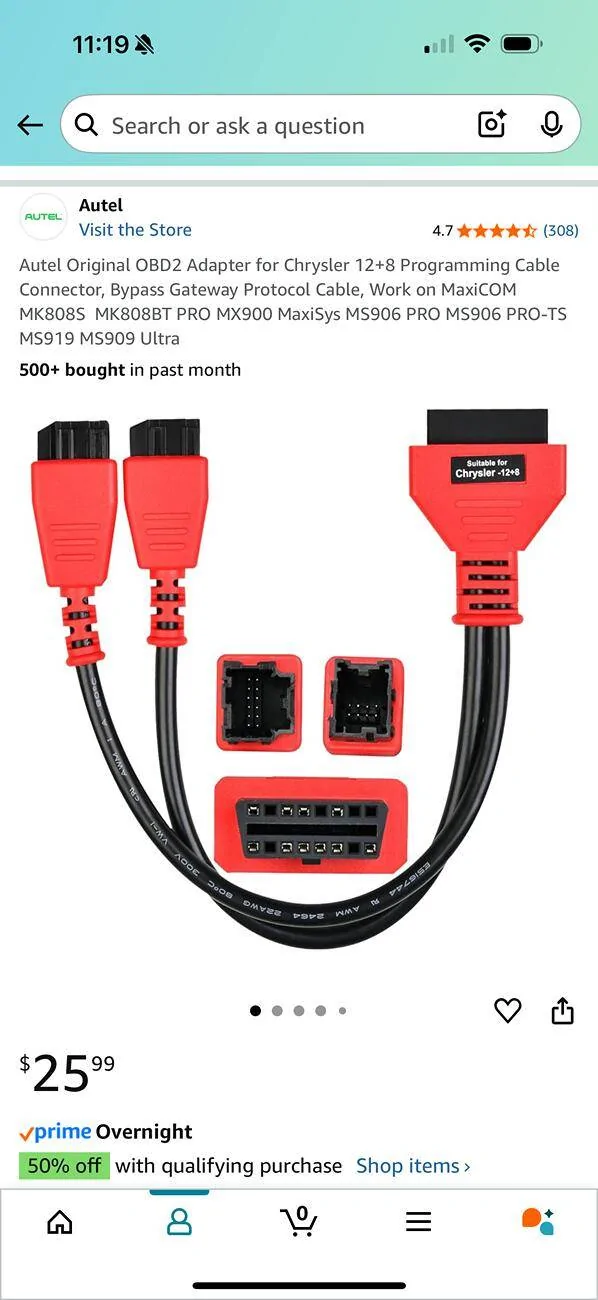

So I went with the J Scan over Tazer
Which I had to purchase this adapter cord to plug it the OBD reader.
My question is do I plug and unplug this everything I have to use it?
Or just leave this Big’O bundle plugged in at all times?

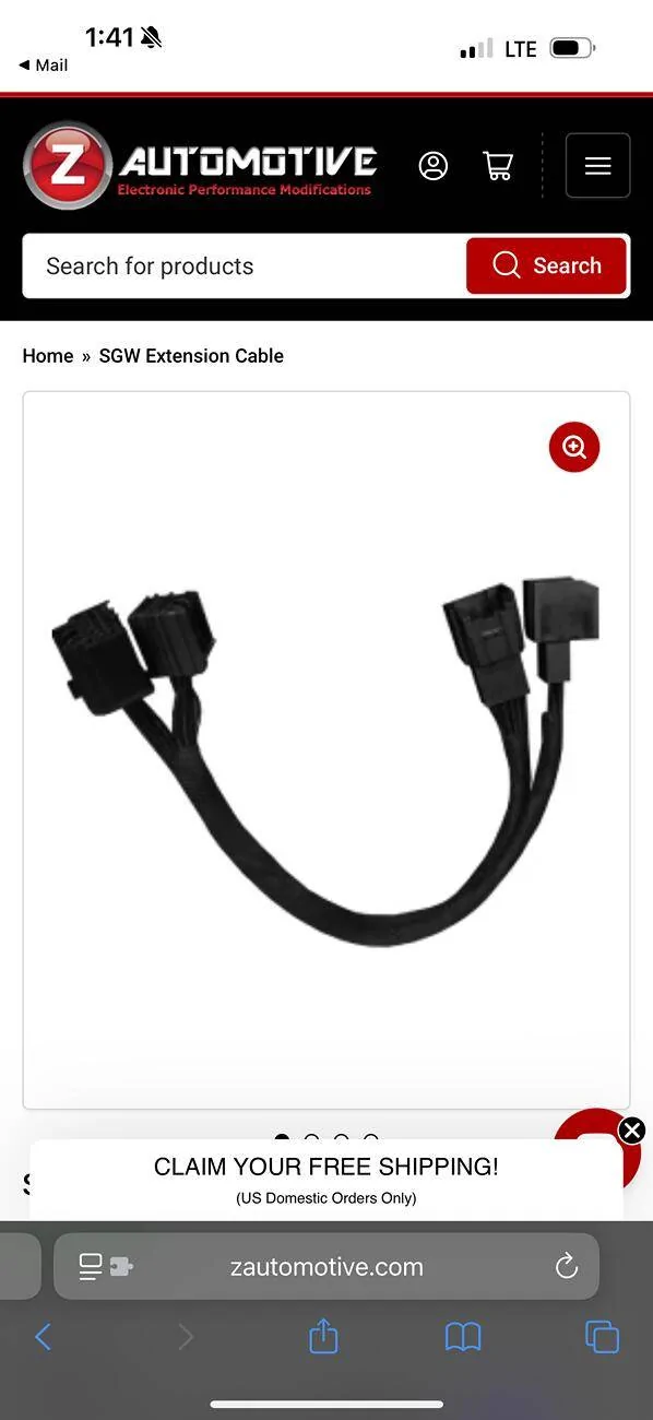

I also use Jscan, I installed the Z automotive SGW extension cable. It make s it super easy to hook up your Jscan, I leave mine unplugged.

So I have both and leave the Tazer plugged in for some of the live features. Unplug it when I need to use the JScan for something, as I like the interface better.
I also bought the SGW Extension cables, makes life so much easier. Northridge has them.

This?
So one end of this plugs into the Jeep, the other end is not suppose to be plugged into anything right?
Where would I connect the JScan OBD reader?
The factory OBD port?

Yes that is the cable. One end of the cable plugs into that hard area under the dash the other end of the cable plugs into the OEM cables the ones you disconnect from the female receptacle under the dash. It then hangs down low enough where your not fighting to get your hands up there. With the extension cable installed, you can unplug and then hook up your cable with the OBD reader, do your Jscan stuff, when your done hook up the OEM SGW cables back up to the hanging part of the extension cord.

The extension cables are like an extension cord - so you don't have to reach behind the couch to plug things in. It changes nothing, really, but to make it EASIER to plug in the bypass cable.
You remove the bypass cable and plug the Jeeps wires back into the extension cables hanging down from the security gateway instead of having to reach clear up to the SGW.
I remove the bypass cable because with the extensions it's so easy to do, and a little bit more secure (a little bit)
