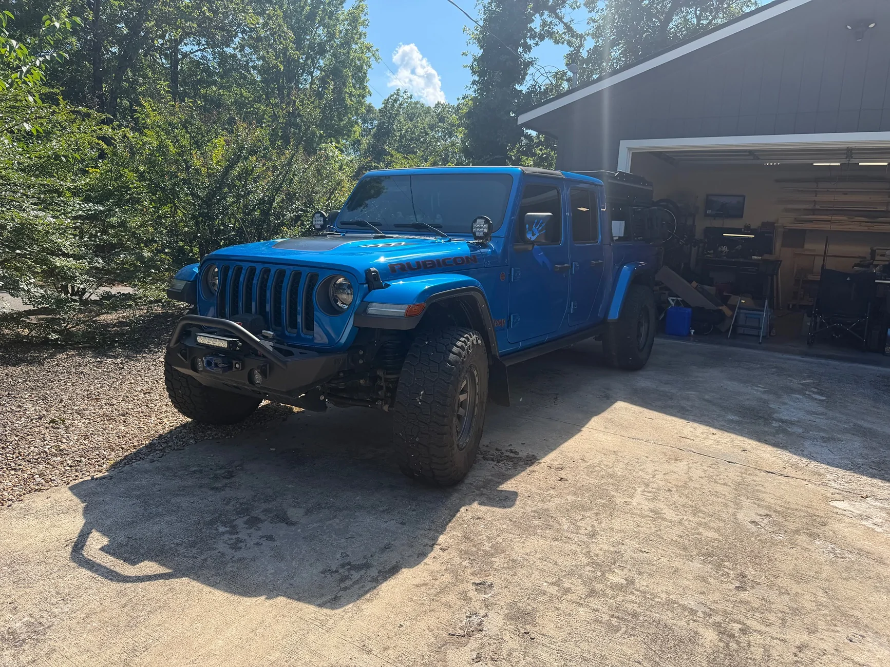

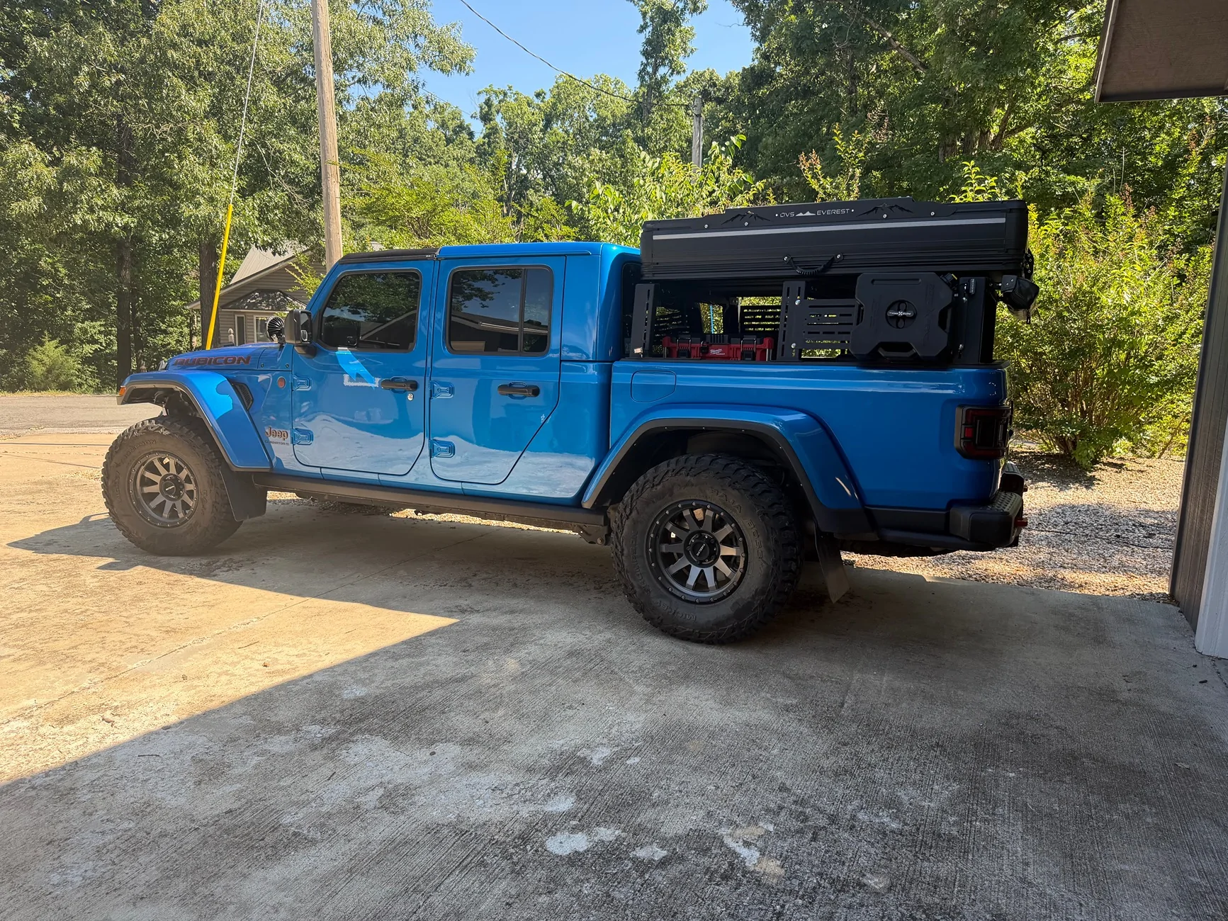

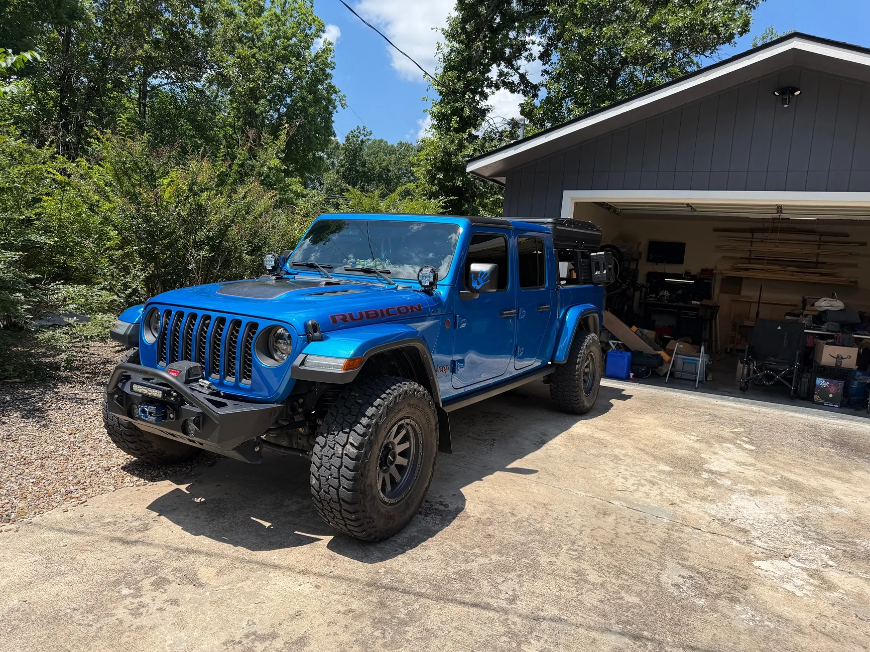

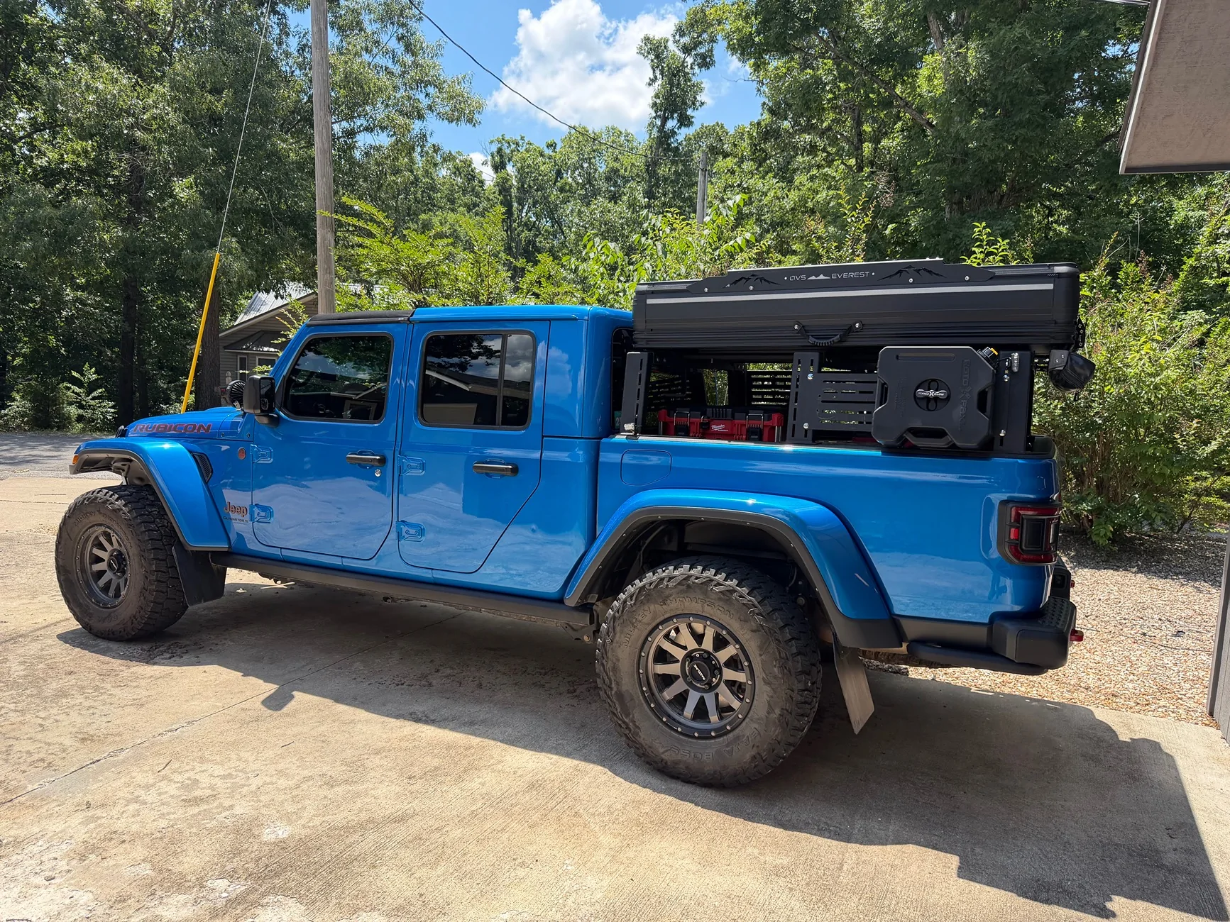

I use my Gladiator for a mix of daily driving and offroad camping…it is sitting with a .75” level kit and 35’s at the moment. This setup works perfect for what I use it for so I do not want to go with a lift….but with that said, the rear is getting heavy and sagging slightly with the rack and tent and battery setup and all the misc. gear in the back that lives in the jeep 100% of the time.
After a bunch of research I have ordered a set of 1.5” Clayton rear springs to help with the weight, the jeep is starting to sag and bounce in the rear. I’ve also just ordered a set of falcon 3.3 shocks for a 0-1.5” lift….the rear coils will be installed tomorrow but the shocks were on back order so they won’t be here right away.
I am curious about what to do with the front though. I’ve read that the 1.5” rear coils will give me no lift, give me 1.5” of lift, and give me 2” of lift. lol. I’m almost positive I’ll be ordering the front 1.5” coils to match, but who has installed and has real world experience with the rear 1.5” Clayton coils and can tell me what to expect? I don’t mind the jeep sitting level or rear slightly higher but I do not want the front to be higher.

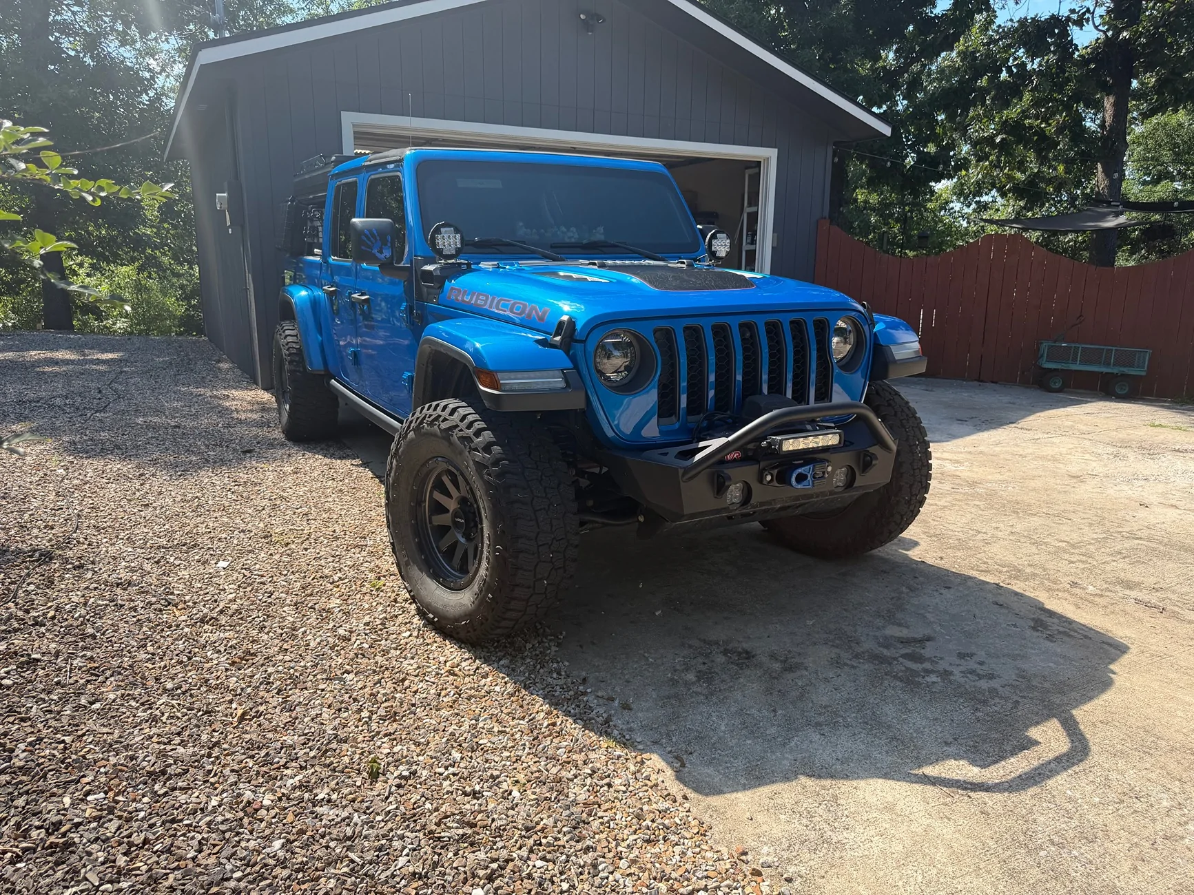

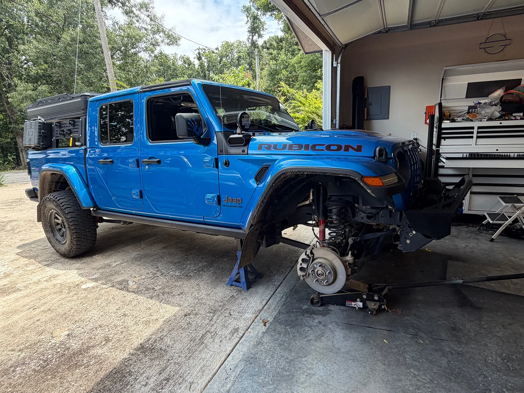

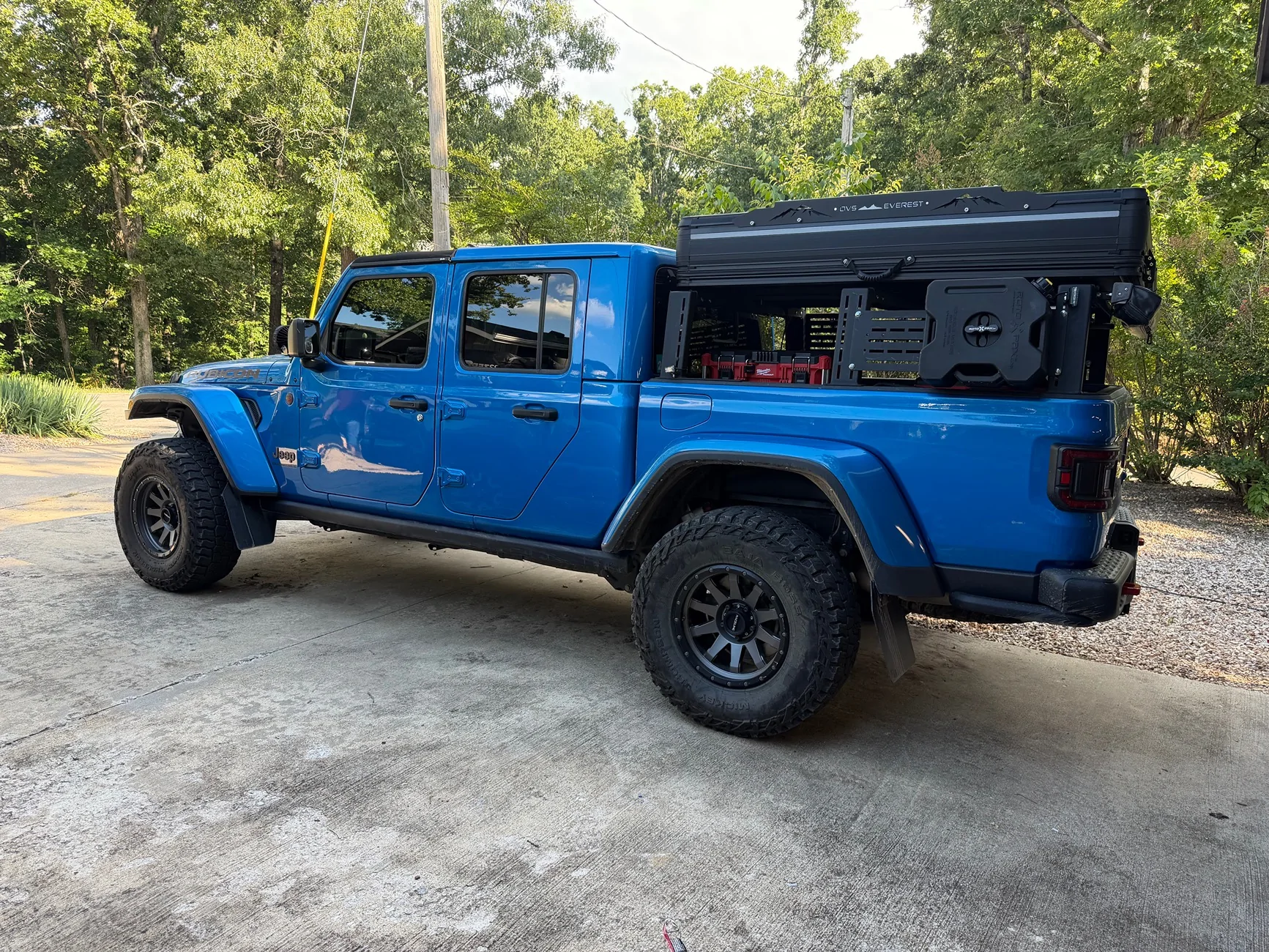

For anyone interested, I got the 1.5” springs installed today and got everything back up pretty level. Still has bounce and roll but that was to be expected with the factory rubicon shocks…I’m sure the falcons will fix that when they arrive.
The plan as of now is to go ahead and remove the 1” spacers in the front and install the 1.5” springs when they come in. If I have to go back and add 1/2” spacers in the rear to level things back out afterwards I’ll cross that bridge when I get there.
Pictures taken today after the rear spring install from the same angles.
