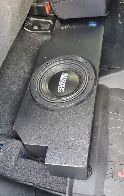

Coming from a 2016 JKU, I was spoiled with space for a sub box. After reading the forums and doing some searching I ended up with a single 10" in a sealed box.

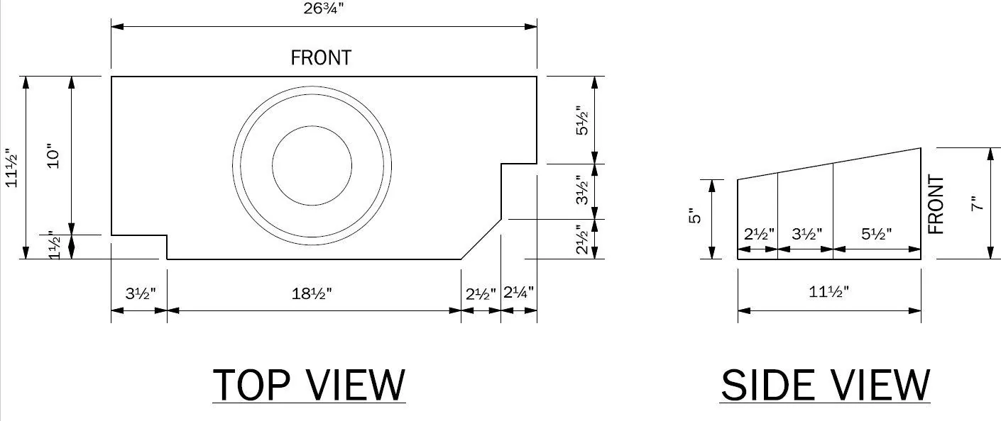

I had a 12" Sundown in a 2cf ported box in my JKU which hit pretty hard, so I went with another Sundown, a 10" SD-4. It is rated at 600w RMS and needs 0.75cf sealed, and about 5" mounting depth.

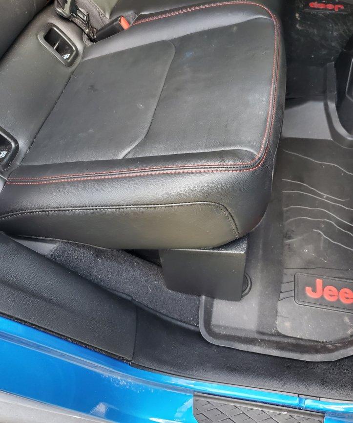

Built the box out of 1/2" material, body filled and Raptor Lined it. I recessed where the sub sits so that it is flush with the top, and put the Amp and LOC under the Passenger seat.
Pretty impressed with the install and the sound. Won't miss my 12" very much at all. I used the 2 mounting locations for the cargo tray to bolt it in with fender and neoprene washers.
Excuse the mess, just finished wrapping everything up and snapped some pics before I clean it up this weekend.
