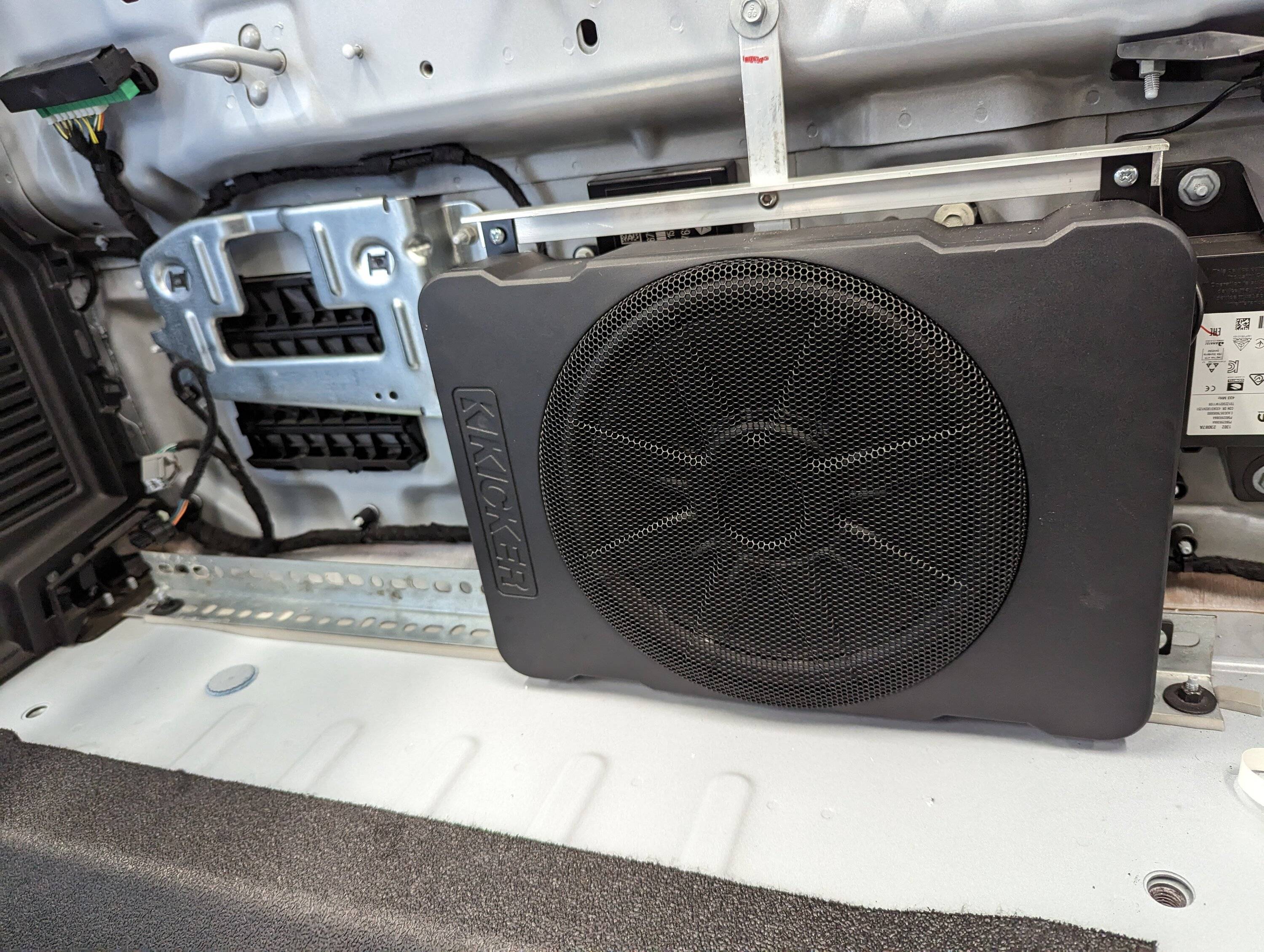

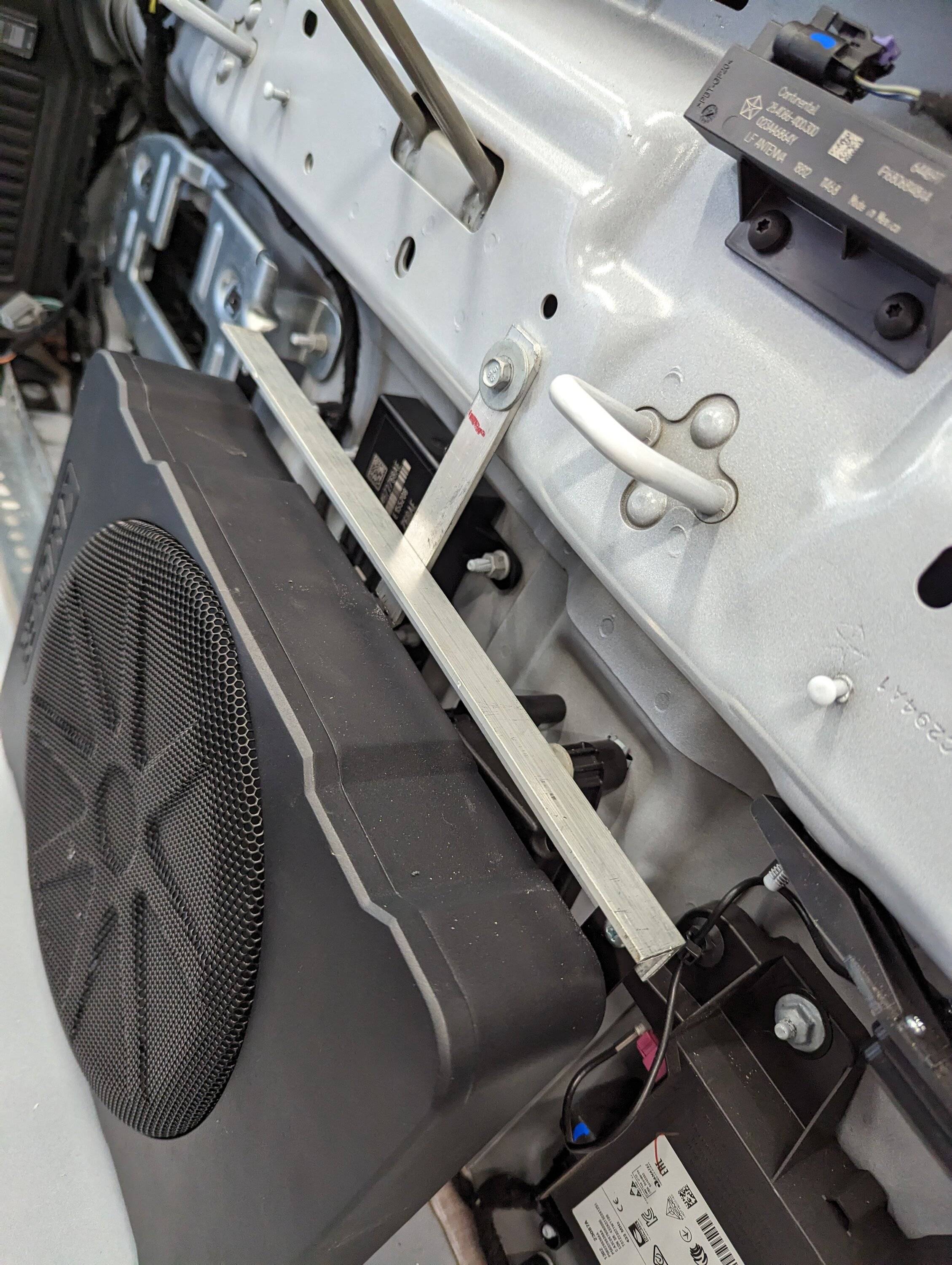

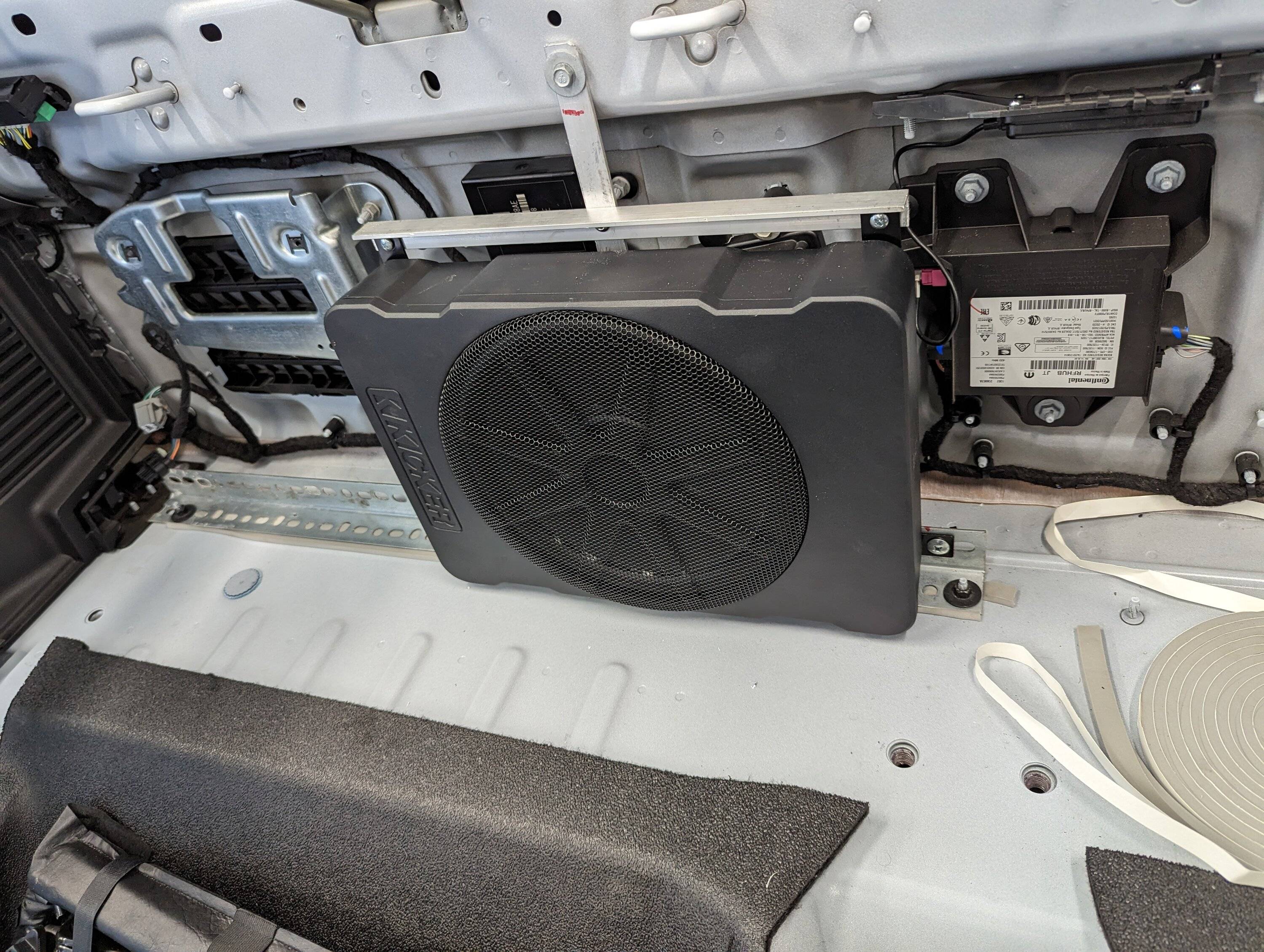

I upgraded my Gladiator's OEM Alpine audio system with the MB Quart. I knew the bass would be lacking from other reviews, but I didn't want to lose my rear seat storage. I removed the factory Alpine subwoofer and installed the Kicker hideaway. I haven't found other installation guides, so I documented mine. I took a practical approach and used a slotted/perforated steel angle for the base mount and an aluminum angle for the top support. I used the factory mounting locations, so there was no drilling or other modification.
The mount isn't the prettiest or engineered, but it does the job.

How’s the bass?
It's definitely better than the factory Alpine. I am sure a true bass box would sound better but its not worth the storage space loss for me.

Did this last weekend.
@DC3 thanks for the pics and the mounting, works great!
Factory trim back on, and it all looks stock, but sounds SO MUCH better. For such a small box the HS10 really kicks!
Why not keep the Alpine sub and add the hideaway on the drivers side? You already had the sub and amp so I'd imagine you'd get more performance at no additional cost?
Two reasons for me:
1. Clean look, and the HS10 in place of factory sub keeps stock look and somewhat protects the sub and wiring
2. More importantly, keeps the lockable space behind the seat (useful when the top is off).
The HS10 would easily drown out the stock POS subwoofer anyway.
