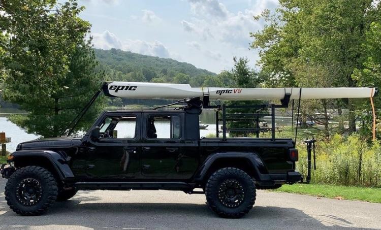

I built mine out of aluminum because it was very hard to find a rack that would work with a tonneau. There are some but they are in the $1,000 range and still wouldn’t work with my trifold. ~$150 in parts. Takes 5 minutes to get off.
Do you have a build thread with details on this already I can check out? Seems like an awesome idea
