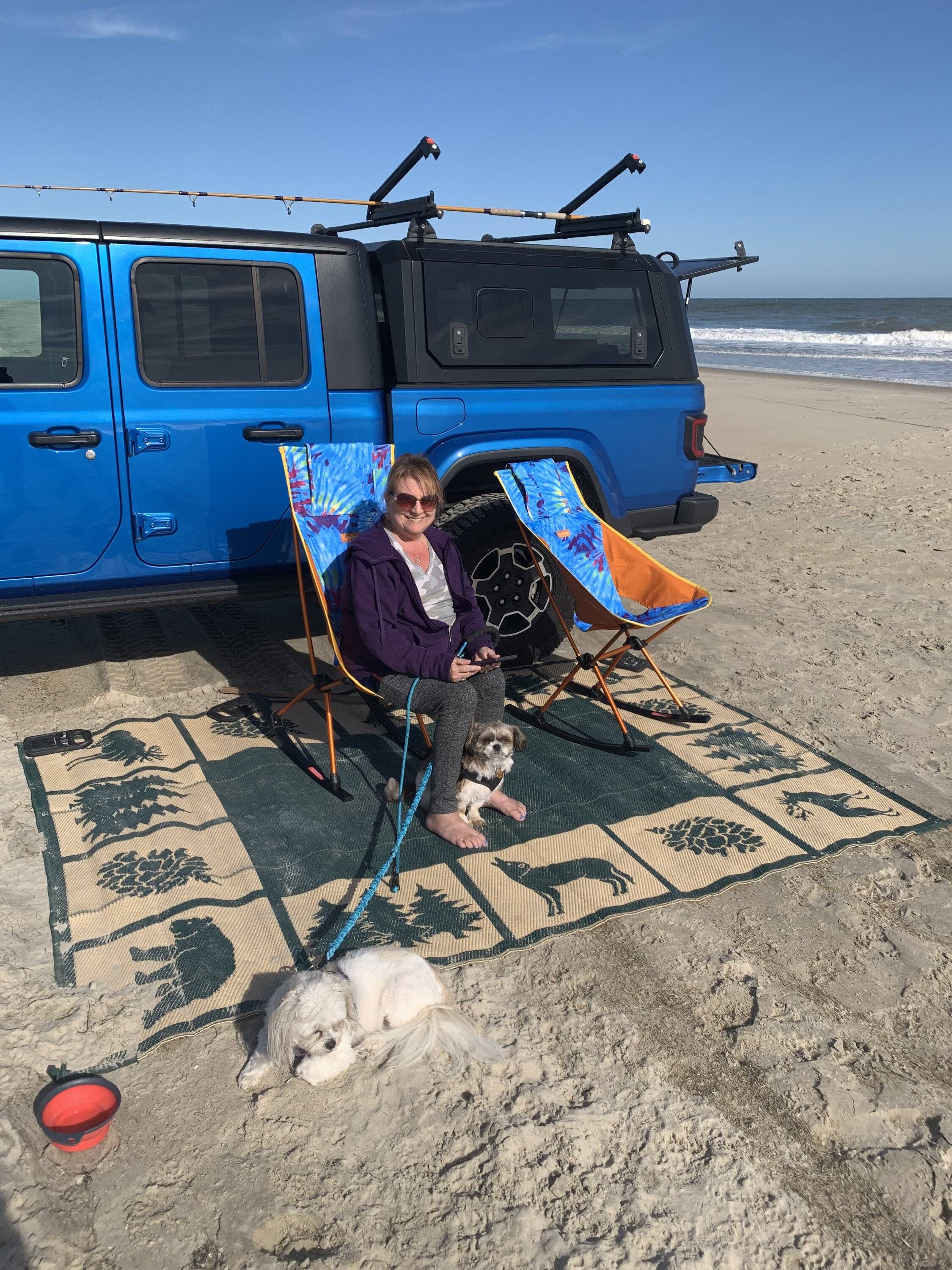

I use Yakima rail pads with old school control towers with round bars, also use the Yakima cam lock straps to cinch down. I have a pair of boat loader bars on the passenger side that lets me extend out a bit to haul two wide 36” kayaks. The control towers and bars lock on and are easily removable. I also use them for surf rods. The Smart Cap rails take a different nut , a square nut, I drilled my rail mounts out to fit the larger bolt. I don’t haul long kayaks any more with the largest being a 13’ Wildy tandem sit on. I’m a Native guy, but the minimalist Compass is my favorite of the Hobie lineup, my go to kayak is a 12’ Liquid Logic Manta Ray, 64 pound hull weight. The one in the picture is a Native Propel ten, amazing kayak but heavy and wide….Jack

Yakima is one brand, there are others. Yes you need to get Rail mounts that permanently attach to the RSI rails, then the rail towers will attach to that and can be locked on. I don’t know it they do round bars anymore, but there is one called the core bar, and you can get a boat loader to fit that plus they are a bit aero. Boat loaders are awesome, they slide into the bars and you turn a knob and they pull out about 28” , with actual plastic sand dollar end caps to hold the kayak on. I am a bit of a kayak nut and have gone in a lot of fun tourenaments, my heaviest kayak was a Native Propel 13, I would throw a blanket on top of truck between bars, had a rubber mat on ground about where mirror is pull
Loader out, set kayak upright on ground with the bow on rubber mat pickup the stern flip kayak over to bottom side up, bow on the rubber so it would not slide ,set stern on boat loader bar then go , go back and pick up bow and set it on other bar push kayak off loader and push loader in. The Propel was 95 pounds, I never needed help. Both of my pedal kayaks are wide now and double straps on the bar holds it fine, I have at time put a strap from bow to rack and stern to rack for front a rear movement. My kayaks have been up and down the east coast and never get loose or have issue. The Cam lock straps are the way to go stay away from rachet straps, you can easily deform your kayak with them and also starch the yak. I do know this though ain’t nothing cheap from the quality rack companies. I sent a picture of the first Duck my Jeep got with my daughter driving but you can see the mounts and the caps that cover them when rack is off…..Jack
